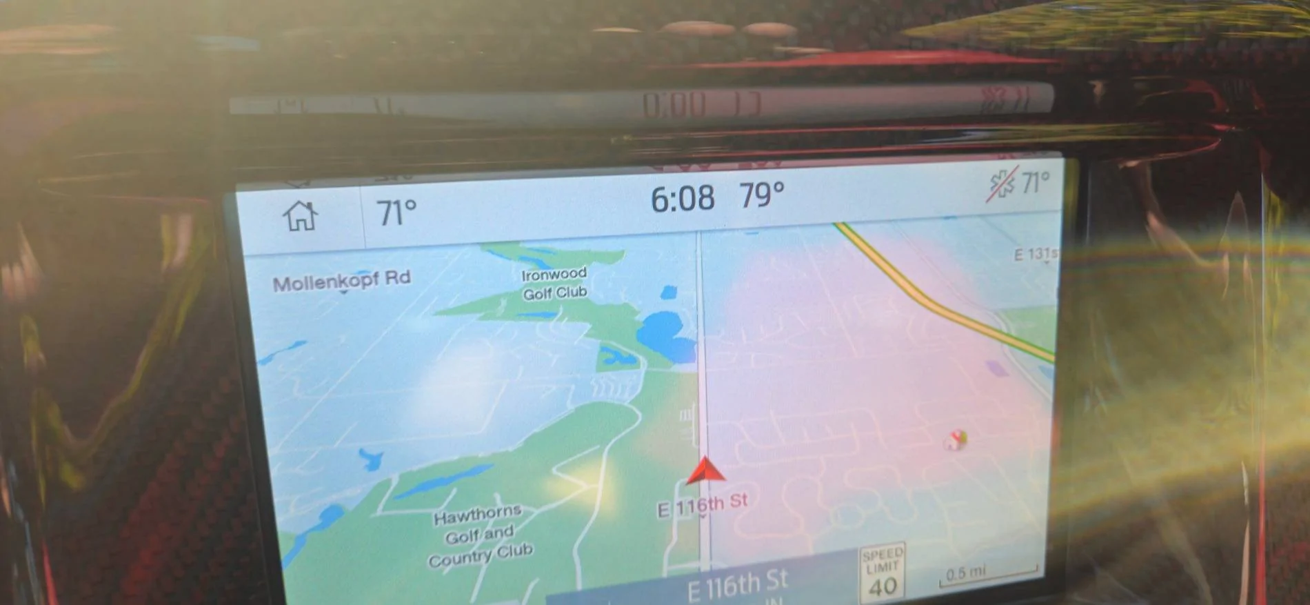

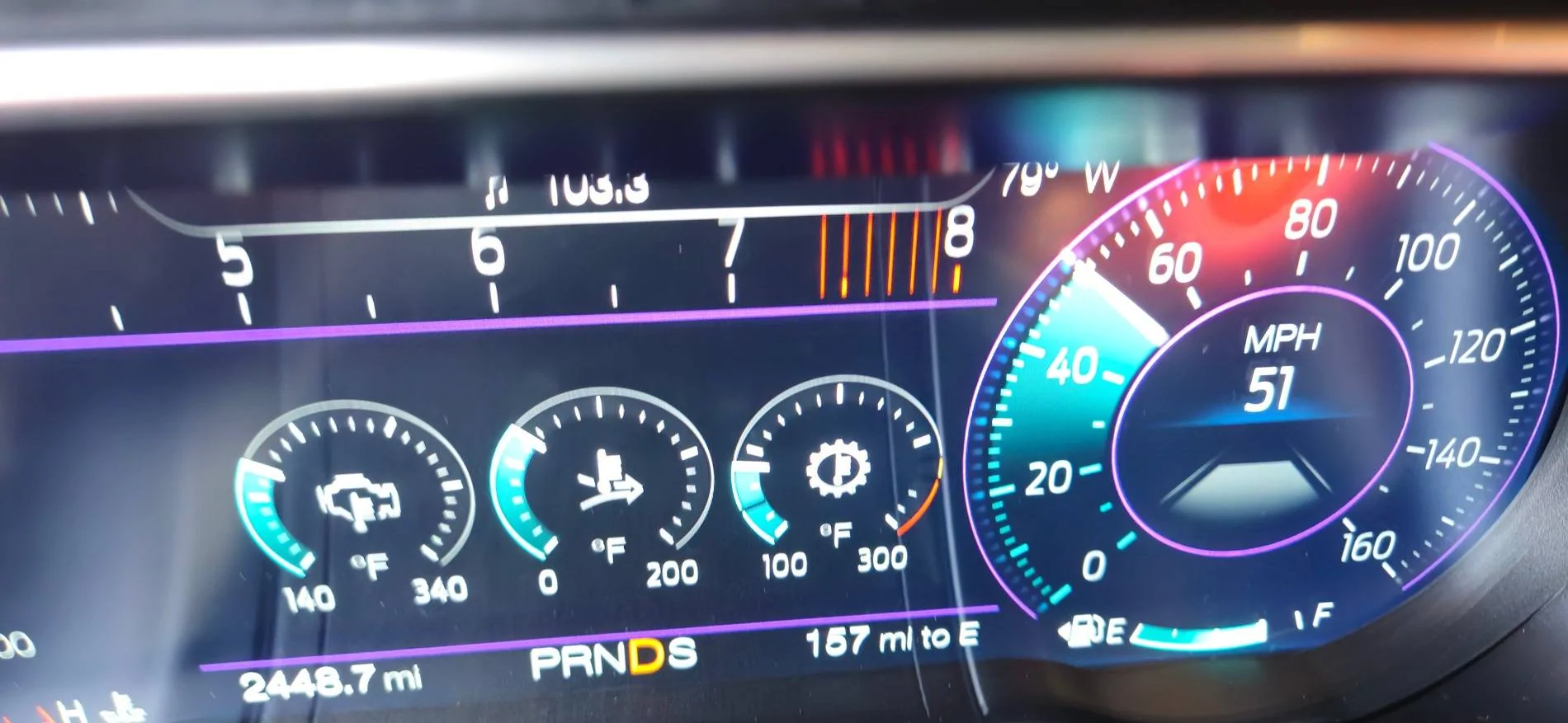

IAT2 right at 65° F

So from your examples, we’re looking at a difference of about 40-45* cooler IAT2 temps. Not sure what that equates to as far power increases. Safer sure. But at what IAT does the computer start to pull timing? 135 140 150? I’ve seen them all listed. I’m sure 70* makes more power than 110.
For comparison, my EB runs between 95 and 105 consistently. I’m 90* weather it’s around the 105. I haven’t seen 110+ unless it was run real hard and parked in the hot sun and even then once it runs for a minute it’s back down to the 95-105. That’s with a hot air PMAS as well. There’s no question the killer chiller is working - I’d love to have one if I didn’t have a/c issues - but not sure of the gains I’d see for my purpose, which is just a quick drop top cruiser that sees the track only a few times a year if I’m lucky.
I’m looking forward to your dyno! I hope there’s a noticeable increase!
