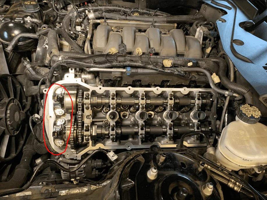

So I am going to replace my solenoids as well, but I’m wondering can I re use the valve cover gasket? Or do I just remove the valve cover and put it back on without it since it’s probably adhesived on

At the end of my video with the dealer print out, it looks like the dealer replaced both the gaskets, may as well put new ones in there while you are in there in my opinion since they are only 9$. JL3Z6584C and JL3Z6584D gaskets were replaced by my dealer on this fix.

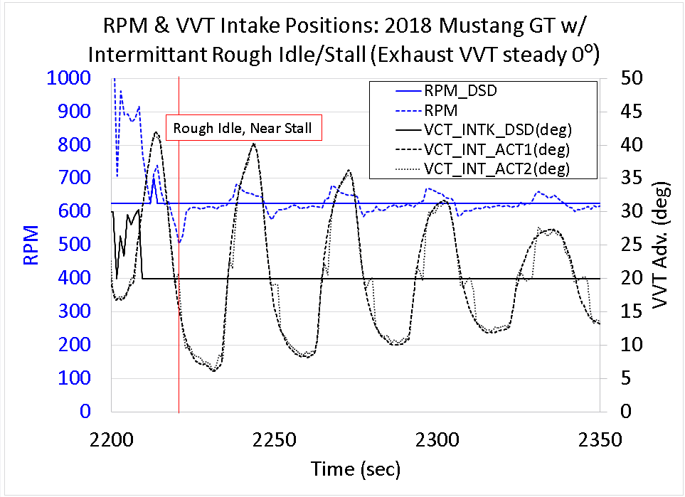

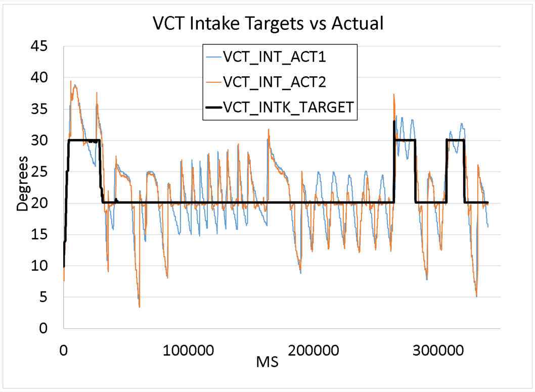

I haven't caught the stumble/stall failure on datalogger yet, but have been able to use Forscan to data log VCT angle vs target behavior and its pretty ugly. The car seems to idle worse when the angles are lower.
Could someone with a "Good running car" plot VCT angles vs time and someone with a "bad running car" do the same for something like idling at a stoplight?
I looked at the service manual and to take off the valve covers of a 2018 5.0 looks ugly enough that I'd rather not do it for no reason.

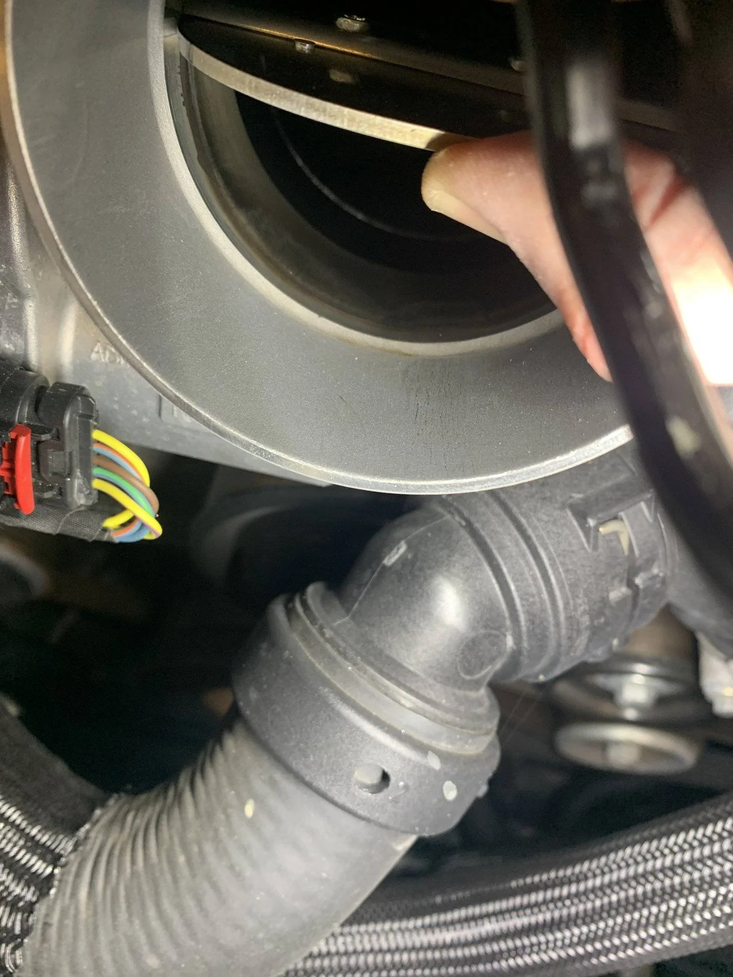

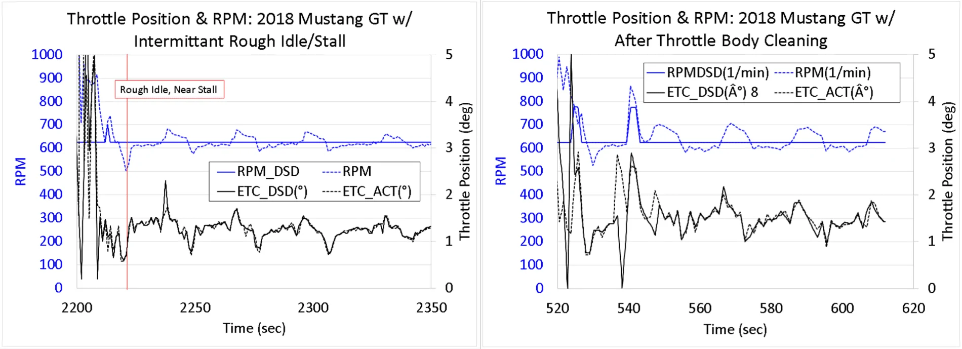

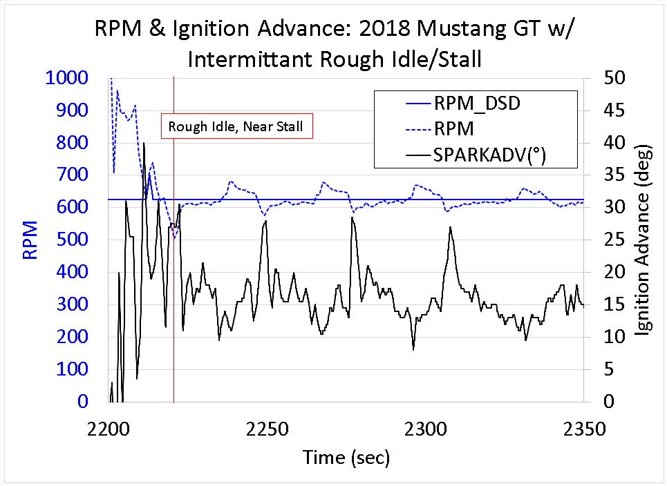

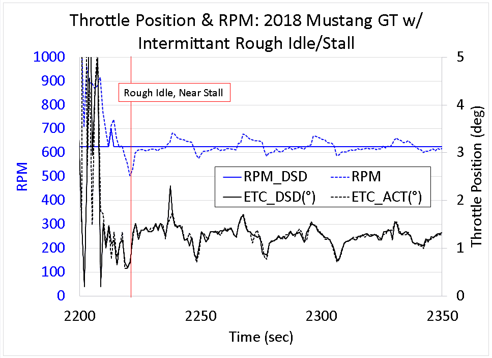

So I did more data logging yesterday and the car only misbehaved really once with a rough idle/near stall. As stupid as it is, it looks like that when the RPMs are winding down on the way to a traffic light the car goes into closed-loop idle control too soon, closes the throttle plate due to high engine RPM, and is surprised the car nearly stalls. VVT performance seems to play no part in my problem at least. If this was an older car I would adjust the throttle plate set screw to raise the minimum airflow. I'm going to take a peek at the throttle plate later today and see if I get any inspiration.

So the idle waveform and behavior definitely changed after cleaning the throttle body. Motor spends more time "over" the RPM target and less time under it struggling & shaking. TBD if random stall is really solved, but definitely a step in the right direction.
