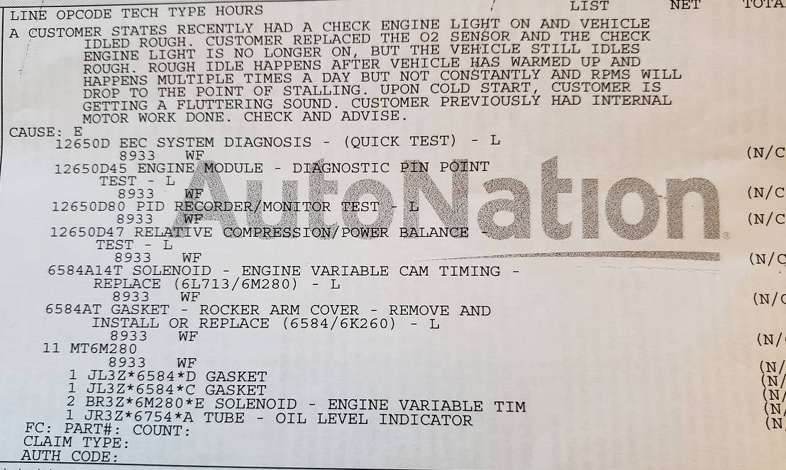

Got my car back from the dealer again, they did :
So far the car hasnt gone rough again or stalled but ive only had it back for a few days.
So I do think the VCT solenoids were to blame at this time.

Hope it stays this way, good luck
Please keep us updated if any thing goes wrong

But for the stalling and rough idle this VCT solenoid fix seems to have resolved my issue so far, no problems since I got the car back.
