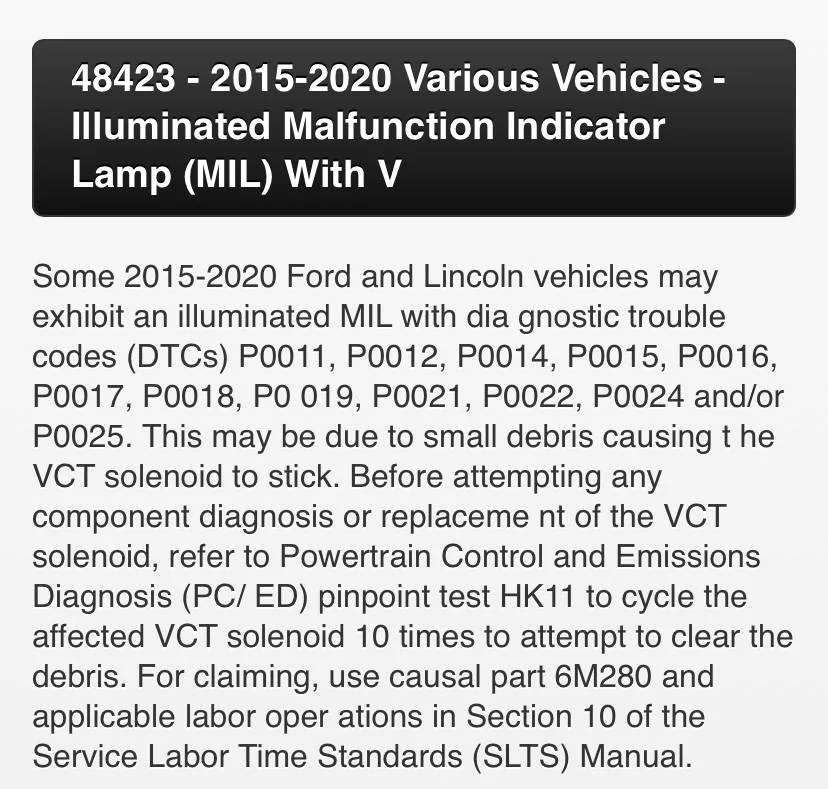

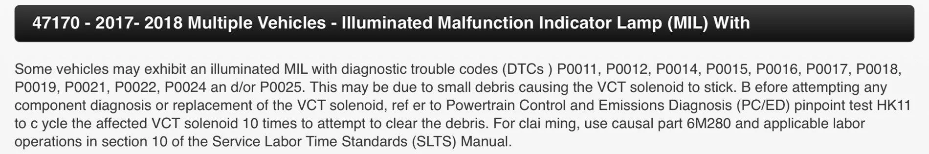

For future reference, months ago I had posted the Ford SSM and a Ford TSB relating to the 2018-2019 5.0 VCT issues in the TSB sub-forum on here.
I’m attaching them here in this thread for anyone who may need them for Warranty repairs.

Just an FYI - another SSM released for the VCT issues:
SSM 48423
