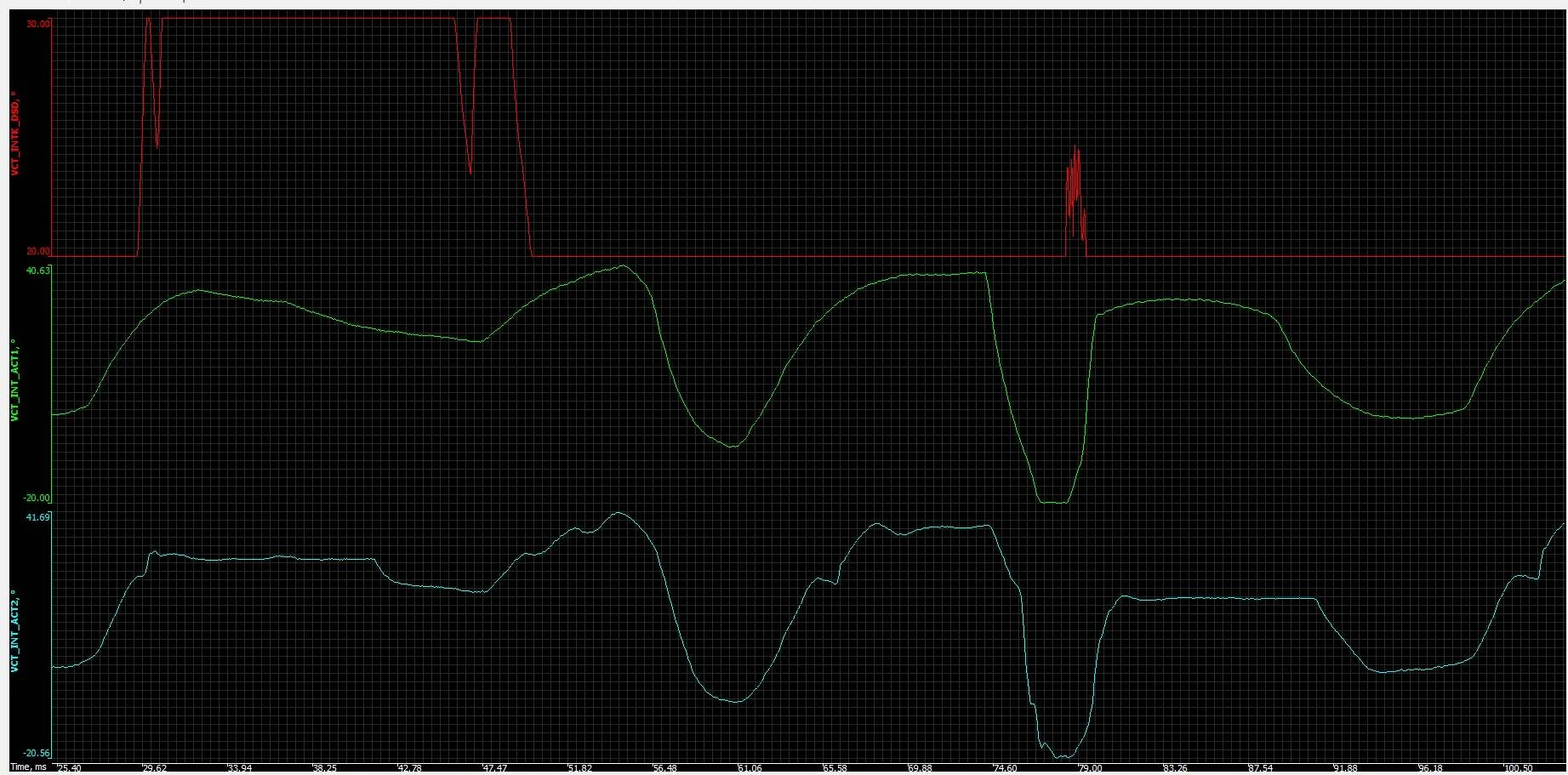

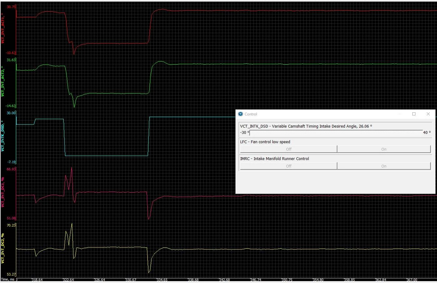

First thought is VVT phasers. Tell your tuner that you suspect it could be the VVT phasers falling out of sync, this happens on the intake side during idle. AFR's will bounce around and at least on my '19, the indicated manifold vacuum will go haywire as well. It happens randomly for me and every few months I have to cycle the intake VVT solenoids with 12v to "unstick" the spool valve in the phasers, it clears up for another couple of months then I have to do it again. I am too cheap to have it fixed and haven't built up the courage to tear that far into the motor myself.

Here is an image of a datalog I took with forscan showing the intake phasers losing sync.
Here is a datalog I took after applying 12v power to the intake vvt solenoids in a clicking fashion to free the phaser valves. Notice how rock steady the graph is afterward. This shows startup at the beginning of the graph and I was also manipulating the duty cycle myself later to determine duty cycle function.
