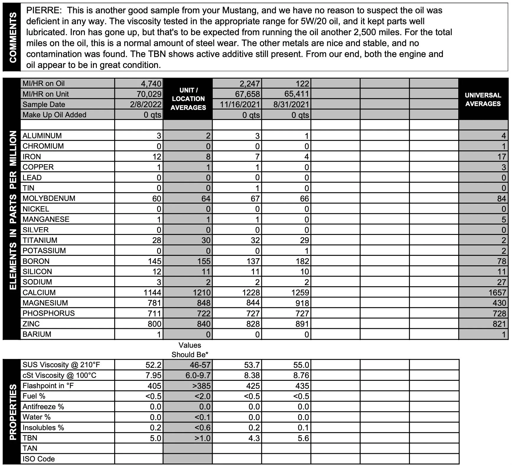

It has inevitably gone right back to the random stumble/stall.
What I completely forgot to mention was that I have been sending in oil samples to Blackstone Labs at the beginning, middle, and end of one run of oil. I did this for peace of mind and process of elimination that the oil is not a contributing factor. I had this scary idea because the symptom seemed to go away for a while right after an oil change. I was remembering the '80s 3.8s and 5.0s that I owned, when an oil change made a difference in performance, it was a bad sign. Here's the final report.
