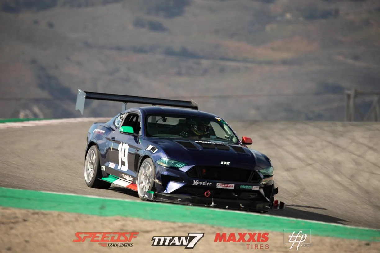

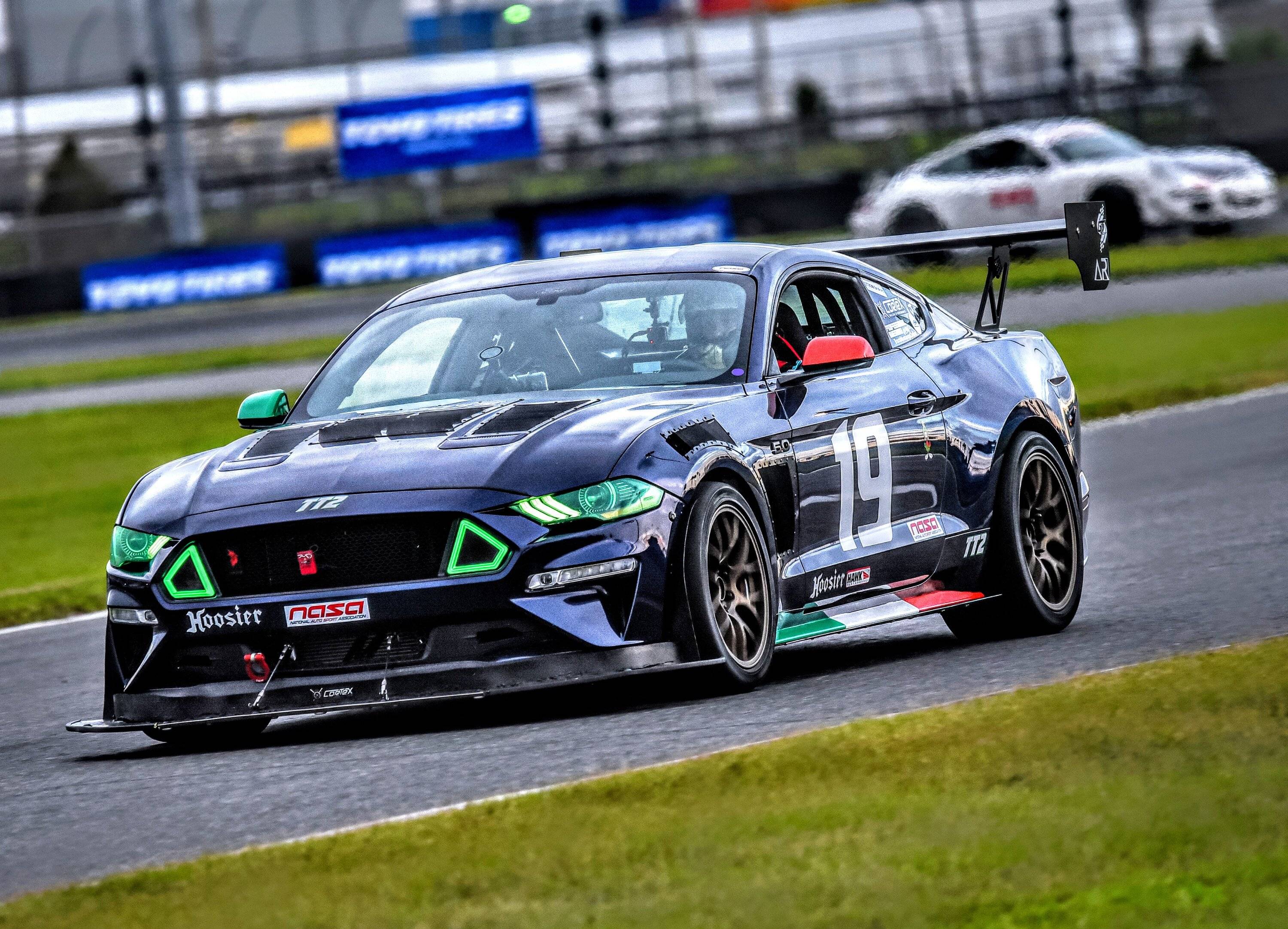

The beauty of a wing is that u can adjust the angle of attack (AoA)
That being said.
All the wings are functional.
The difference is "when do i feel this functional?"
A "base" low drag ok downforce wing you can consider is the APR250
Is a good entry level u can easily pair with a simple splitter.blade.
I used to run that before passing to AJ HARTMAN FULCRUM 14. (But also a smaller version called apex8)
AJ WINGS are just next level.
Last consideration. Depends what u need the car for.
Is a daily and once a year u hit the track?
I would consider a lower wing profile like the new anderson composite gt500 wing replica.
The taller wing are really a ...cop.caller sometime.
Attached the apr250 and aj wing
