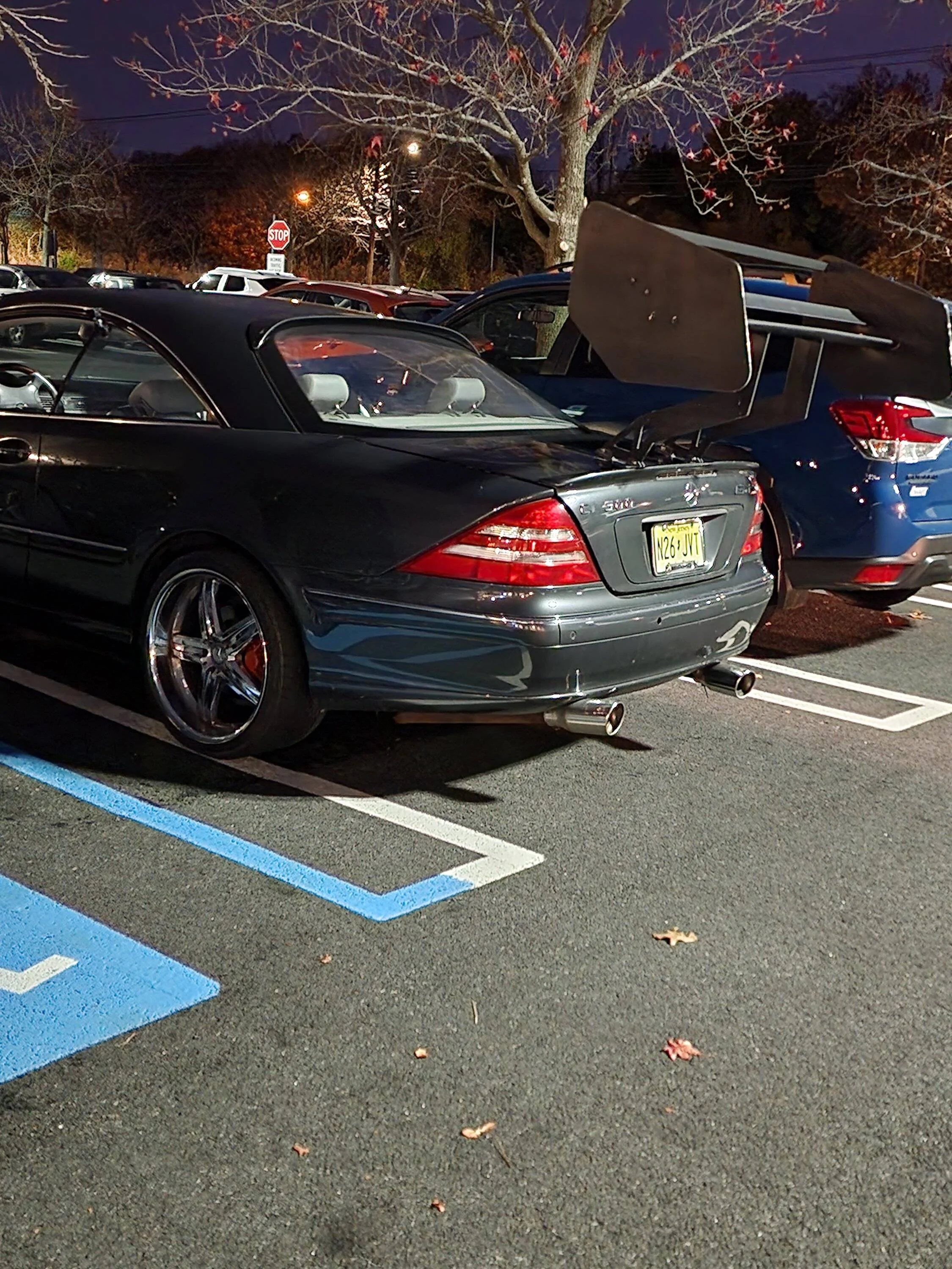

I almost slammed my head into this thing in the parking lot of Paramus Park in New Jersey. People that do this should not be allowed to vote.
What the actual f%$!. It appears he/she has it on backwards as well???

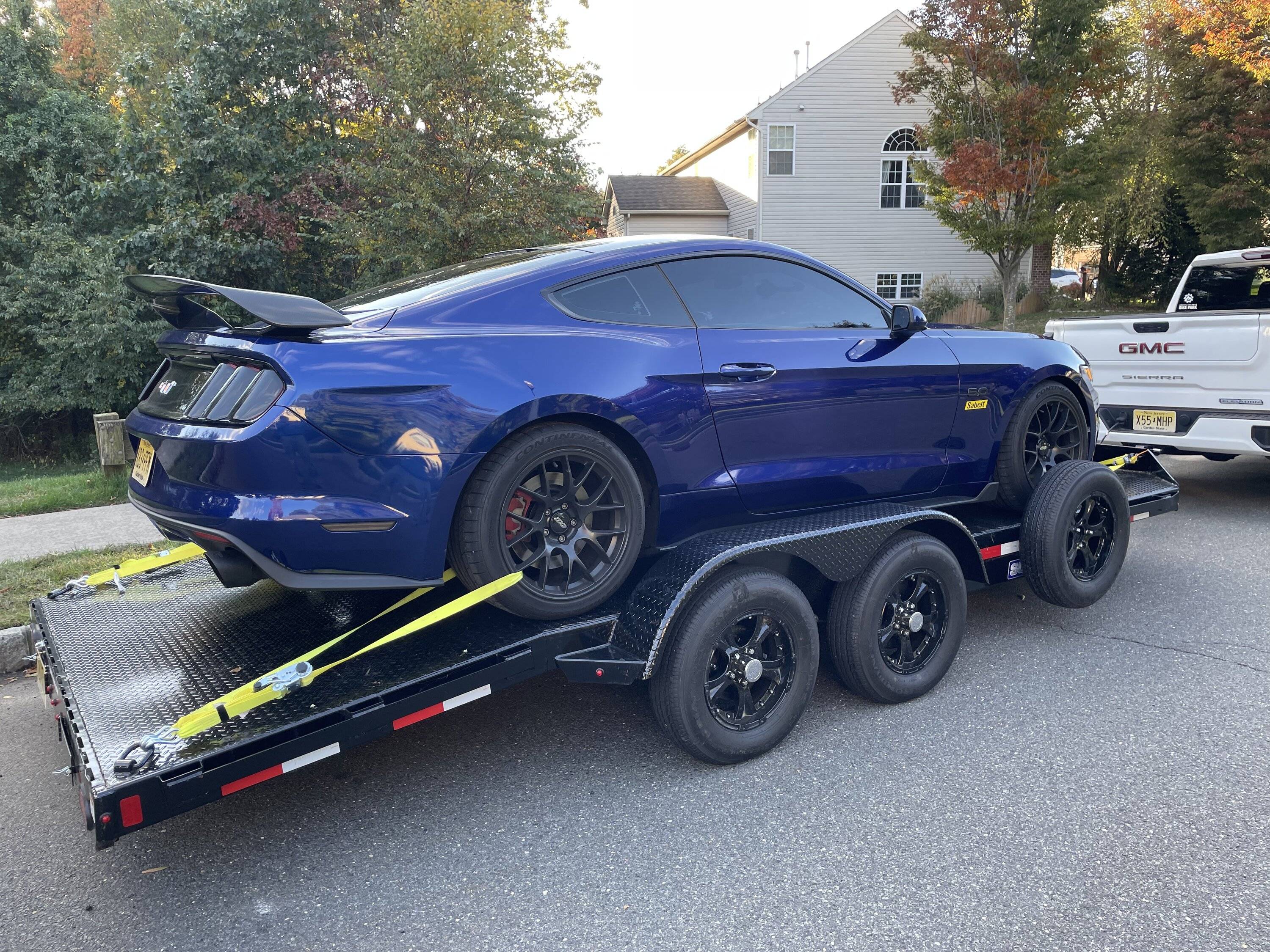

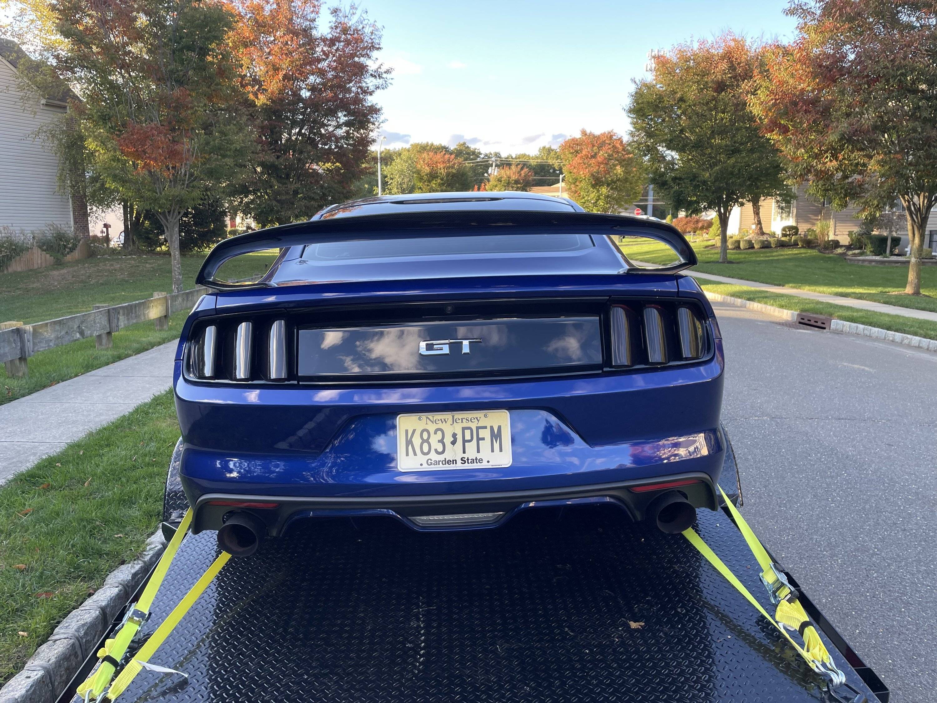

Try the Anderson Composite GT350R carbon fiber spoiler replacement pictured below IMO. I have that with hood louvers and my car is very balanced (I had to take off a front splitter because the car didn’t have enough rear downforce with the louver and splitter combo). Plus it looks awesome. I don’t see the need for a wing if it’s not a track car.
If you want more rear downforce in a stealthy way you can go with Verus Engineering rear diffuser. It’s an engineered diffuser not some cosmetic piece.
My spoiler is coming off this winter for a wing (either AJ or Chicane23) but that is because I obviously need one if I want to put the front splitter back on the car. Plus it will be nice to have the adjustments so I can balance the car which also likely means messing with springs again.
And that’s a whole different issue - adding downforce to cars with stock suspension.
I say just get a functional cool looking spoiler and that’s already enough downforce. The GT350R spoiler has a very aggressive rake. You can easily run a splitter with it (just no louvers and splitter in my experience)
FYI THE GT350R wing is cosmetic. DOES NOT PROVIDE ANY USEABLE DF. I know.
I Was thinking the same thing. def installed backwards.
