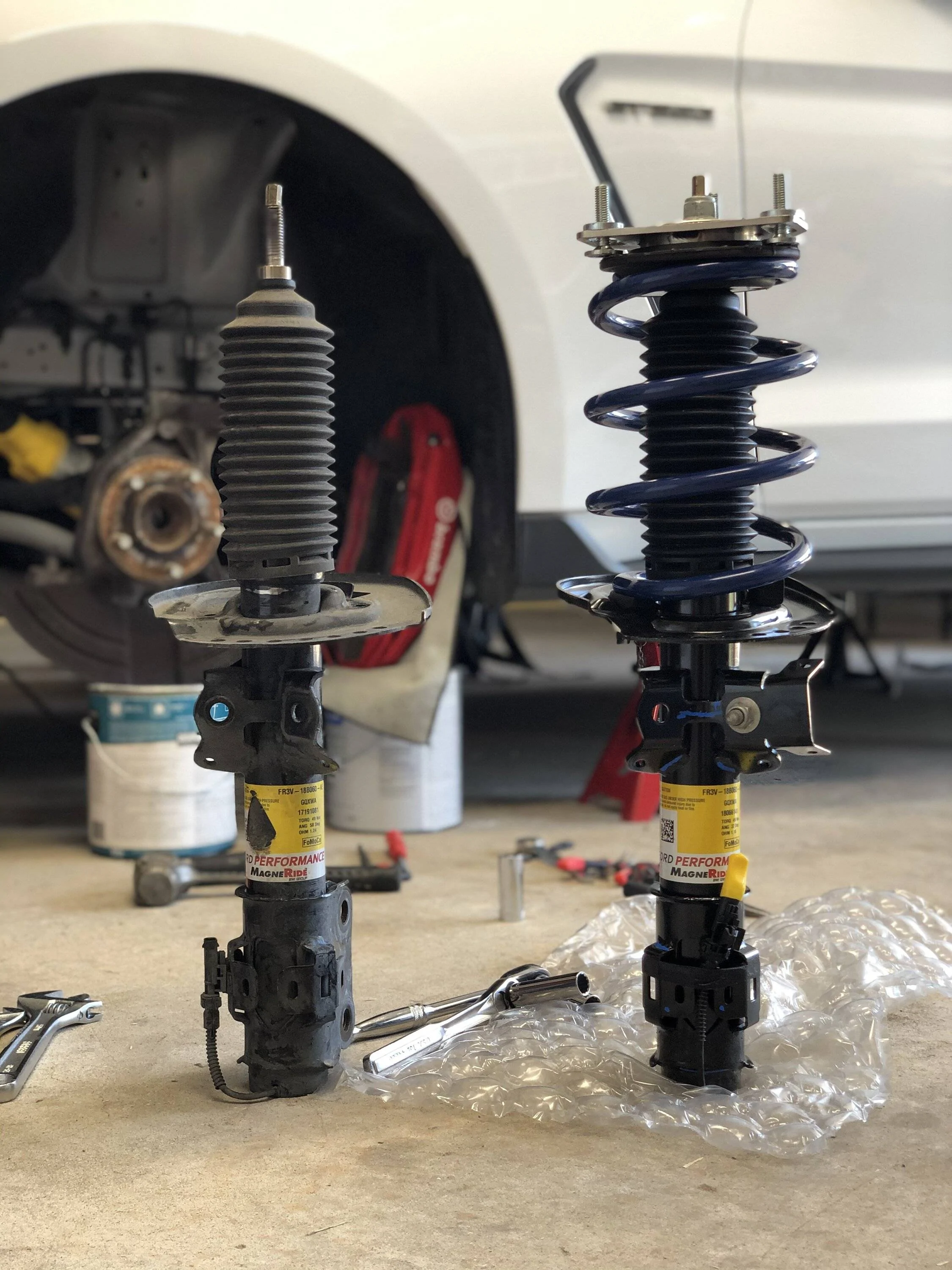

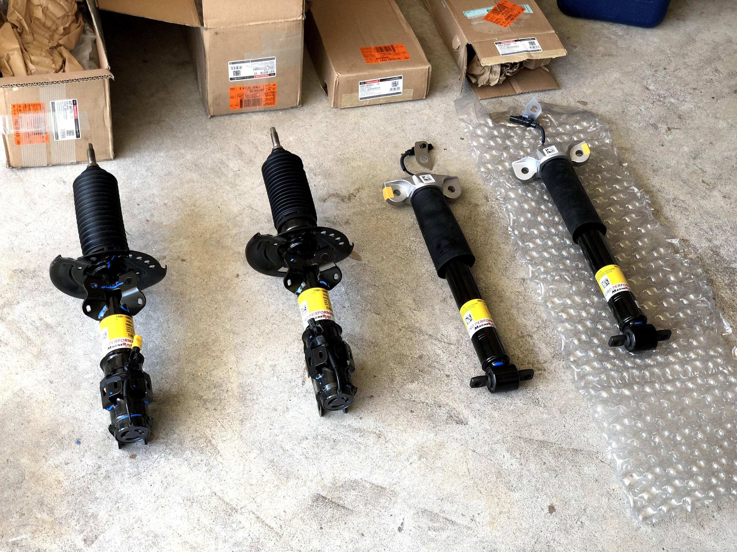

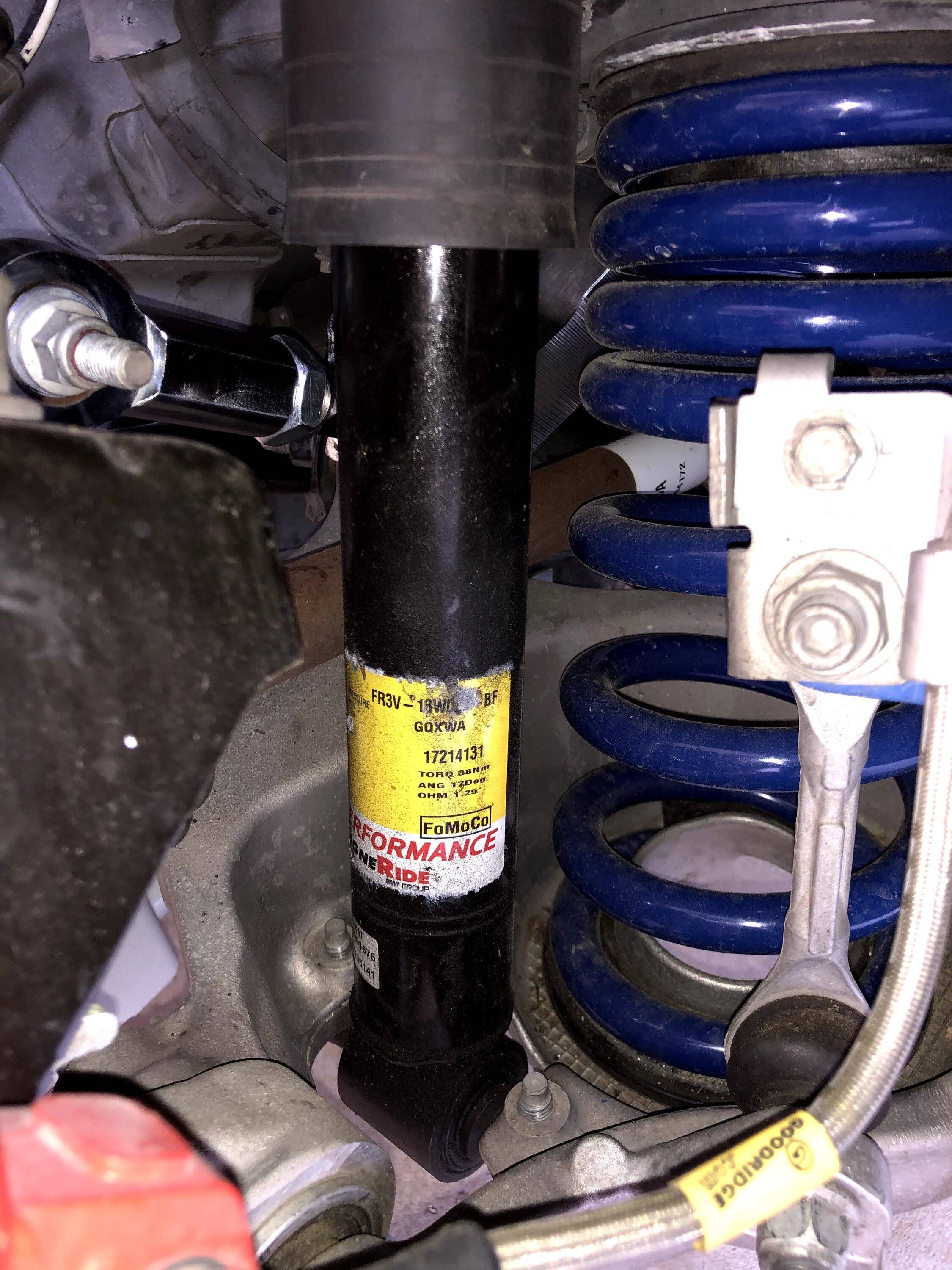

Not quite, Gen 1 here closing in on 70k. Replaced the Magnaride shocks/struts in 2022, had 1 leaking on me. Replaced both rear wheel bearings in Jan-2023. Had her up in the air working on the suspension and noticed a wobble when installing the driver side wheel. Install wasn’t terrible.
Can you shed light on what did you hear or feel to replace the rear wheel bearings? Did you replace the rear shocks? I’ve had to replace the front magnaride shocks but the rears are still original. Wondering what should I be on the lookout for. Btw my 16 gt350 has only 32,000 miles and runs like a champ.

Lift the vehicle to get the wheel off of the ground and start moving the wheel in different directions (not in a spinning motion). If there’s any play with the wheel bolted to the vehicle, the bearing is shot.
One of my rears went out, so I replaced them all. I didn’t feel a difference in ride quality, but I just happened to be under the car and noticed the wet shine on the shock. I located a full set of new Magnaride’s at a great price and just changed them all out.
