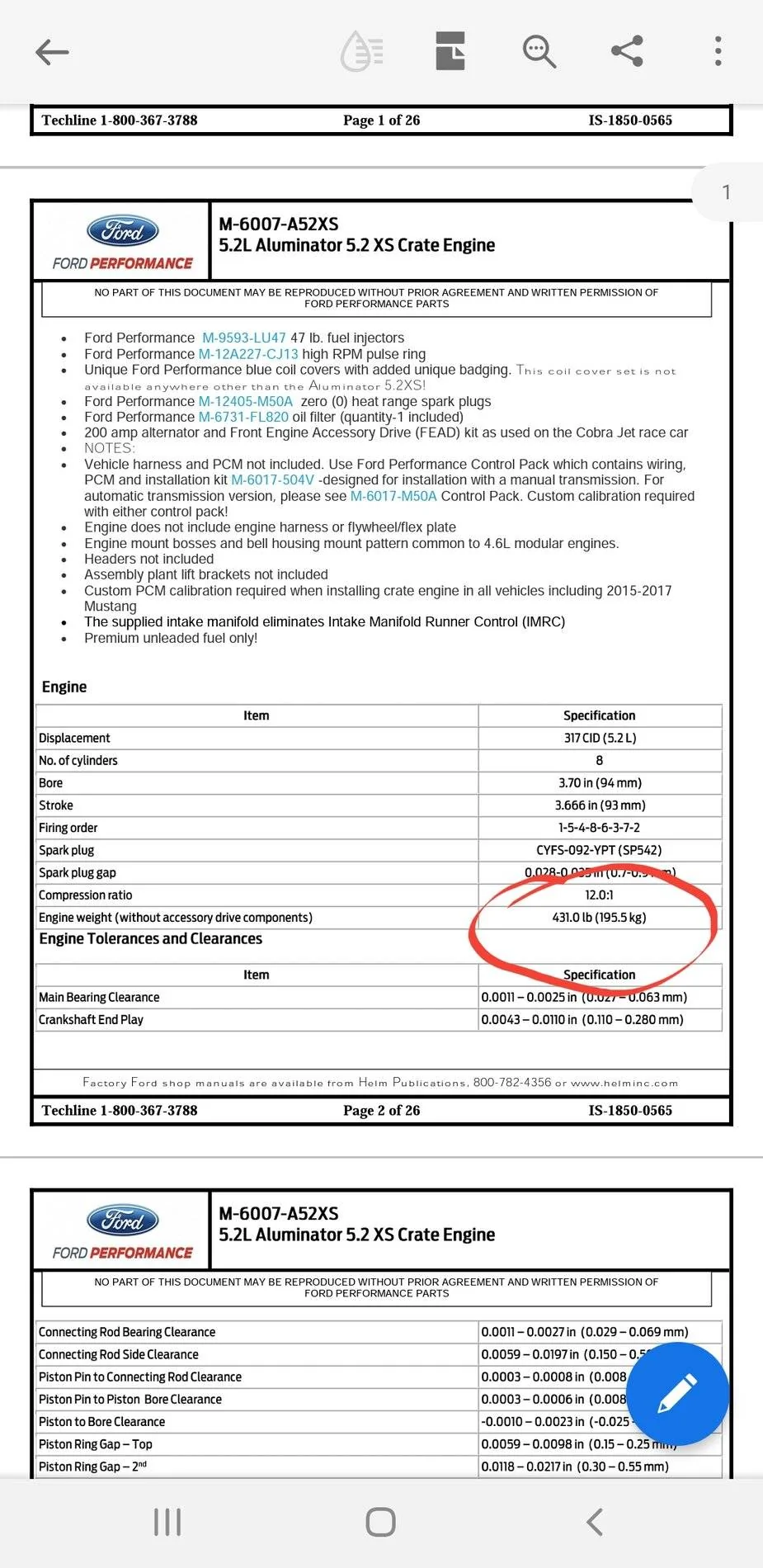

I did do a few searches, I promise. However does anyone know the weight of the FPC Voodoo engine? I wanna yell at corvette guys on their forum.....

That’s not a Voodoo engine, but may be close... it is a cross plane crank engine and the crank does weigh more. How much.... ounces, pounds...????
