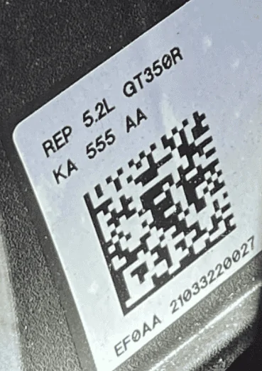

History: 36,000 miles. Well, it's really strange so I wasn't going to share. She consumed oil 1 quart and 1/2 half in 1,000 miles but when driven on track it consumed none. A week before the engine replacement, I was told I could continue with the track event as the aftermath wouldn't matter. I was surprised to see it consumed 0 oil on track. I literally brought 2 bottles quarts of oil with me. lol.
