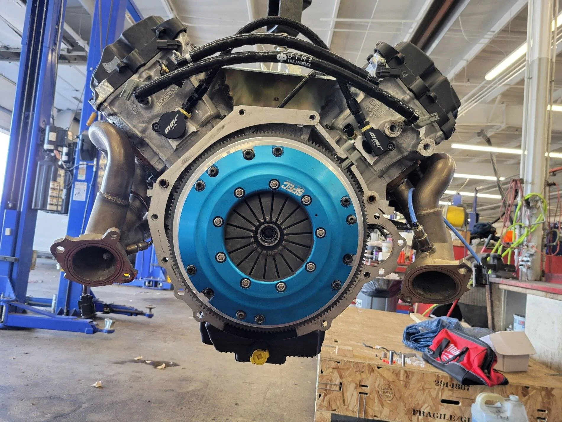

Do you have to have the block out to install? I got the engine going in and it will be installed by tomorrow most likely...

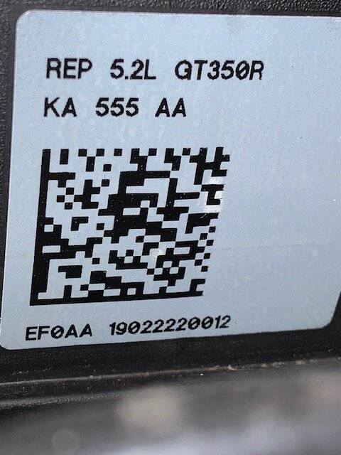

This just got installed.
Hard for me to tell.. but I think that's a Feb 02 2021 build date based on the Julian Calendar.
it can be done with the engine in the car but Its obviously easier done with the engine on a stand .
Yep, day 33 of 2021 is Feb 2nd 2021.
My build on day 22 of 2019 is Jan 22nd 2019.
