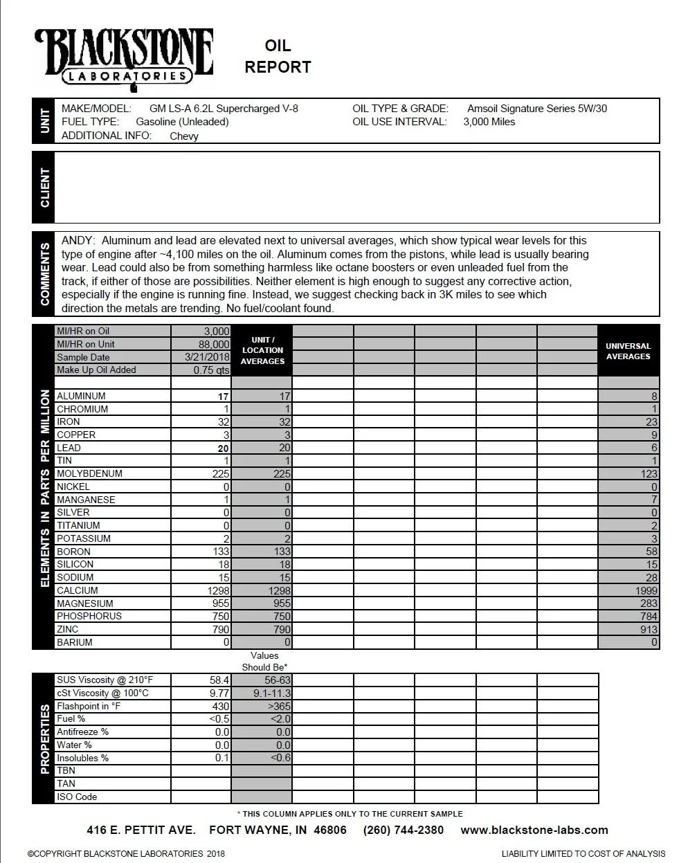

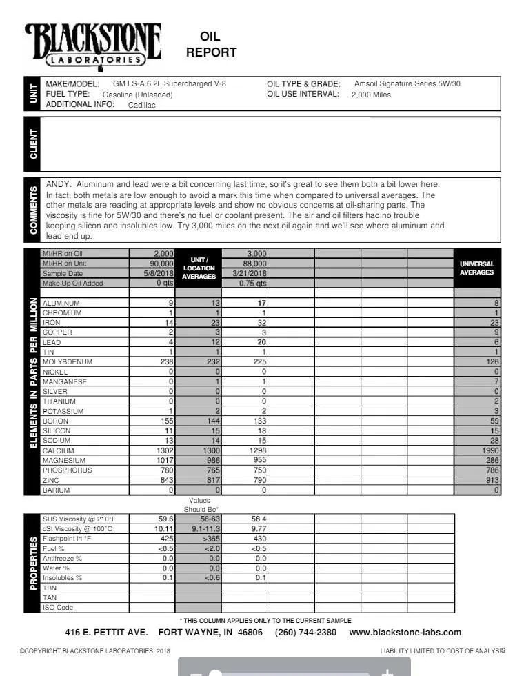

I had some from my 90k mile 630 rwhp CTS-V that they said had some levels of lead that were a bit higher than ideal. Car ran great until I totaled it, but my catch can would catch a ton of oil. Like 12+ oz in 5k miles.

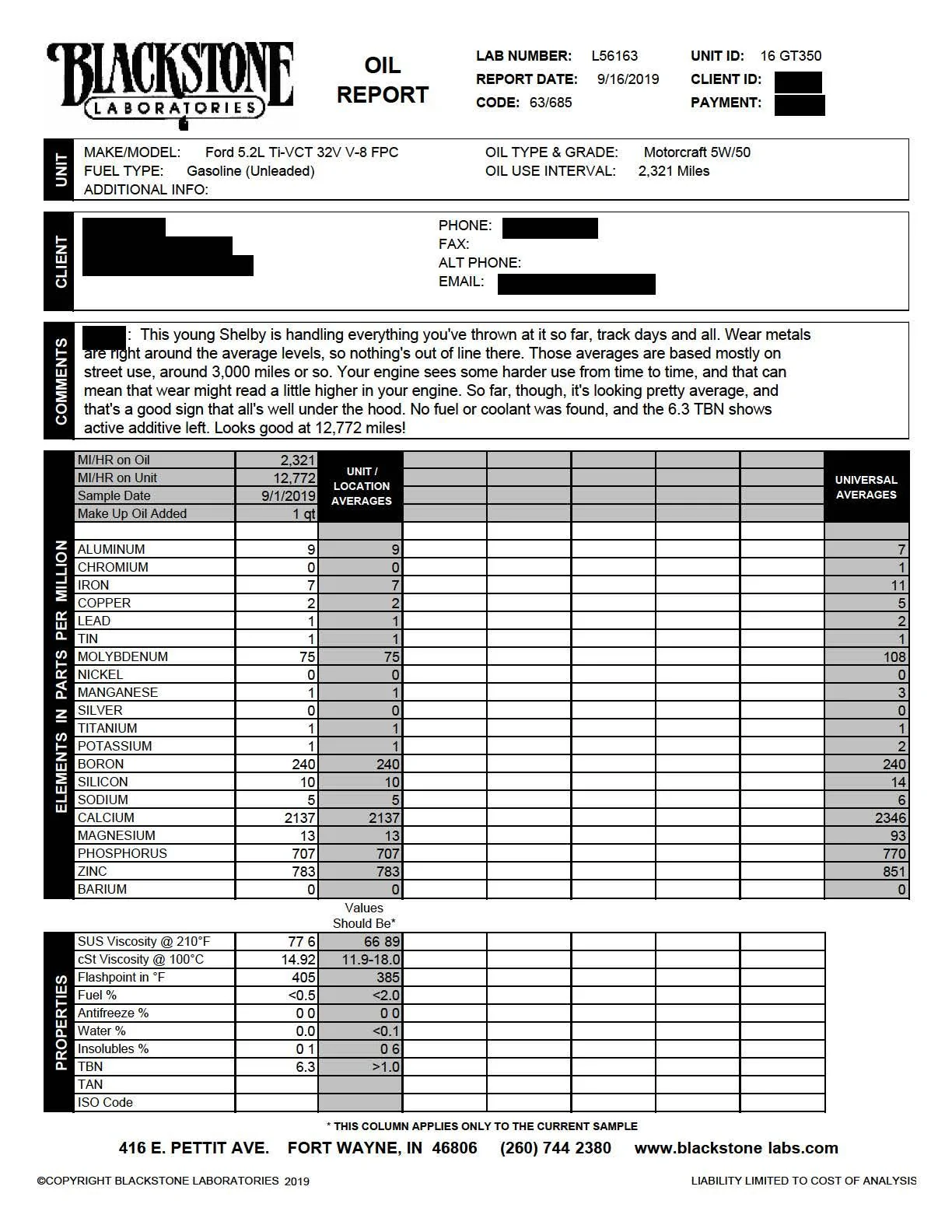

Thought I'd add my recent Blackstone report as well... 12,772 miles on my 2016 GT350, including 9 track days, 3 of which were on Hoosier R7 30-series tires, so I was turning higher RPMs throughout. I have used nothing but Motorcraft 5W50 in this car. It seems to be doing the job just fine.

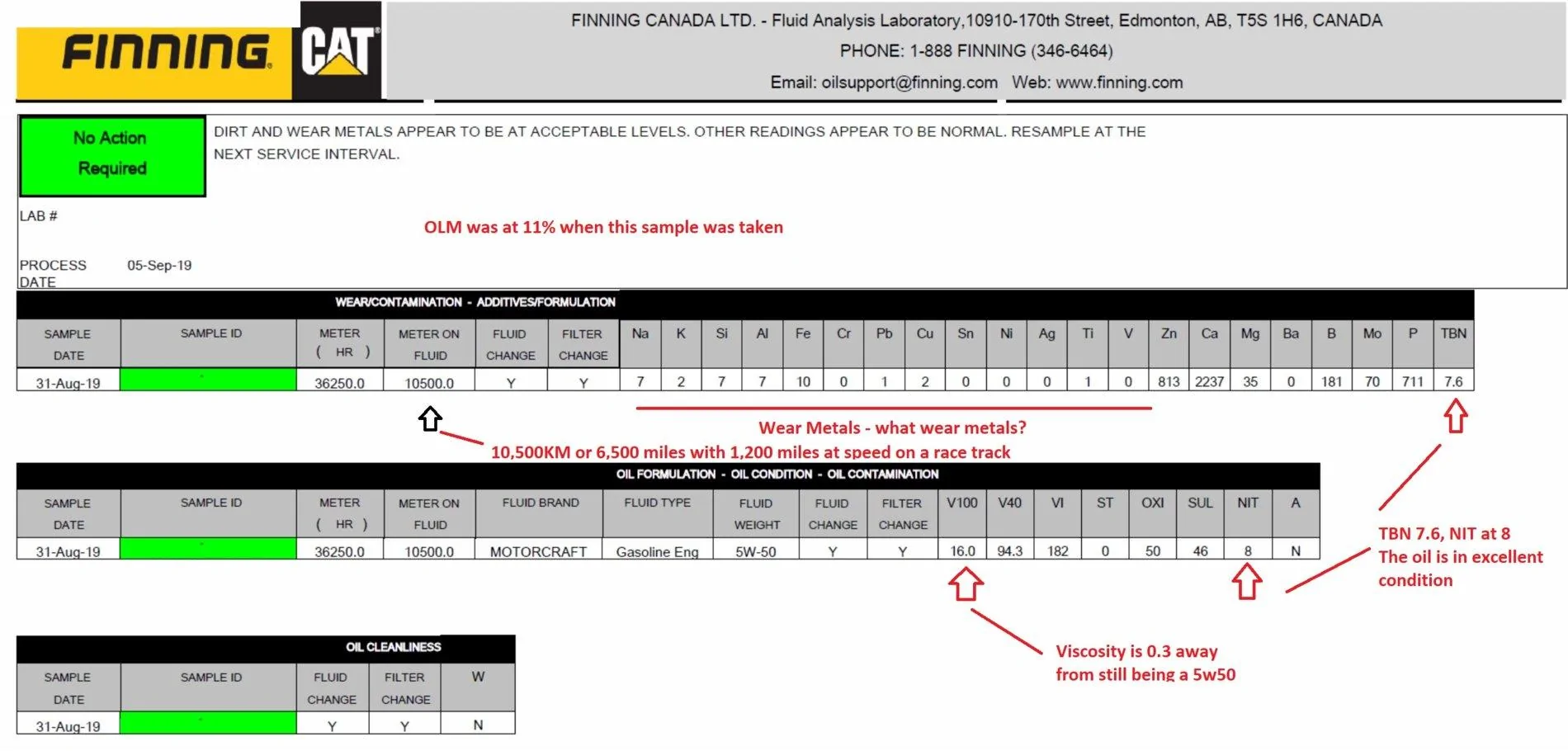

I posted this on TMO a while back. It's an analysis that I had done because I was curious. This summer I did a bunch of track days - enough that the OLM was counting down because of use rather than just the passage of time. It hit 11% at 6500 miles with 1200 miles of at-speed track miles on the oil. I changed at 11% because there was a drip forming on the drain plug (new one installed now). There were three quarts of top-up over the interval.
There isn't a lot to say about it - one thing is that the oil was within 0.3 cSt of still being a 5w50 viscosity. It tested at 16.0 and the lower limit for a 50 is 16.3. It sheared down from 21 or whatever it is new, but it was very close to "stay in grade" performance. The oil was quite dark when I drained it, but I'd done a little kitchen sink chromatography (a blotter test) that showed the oil was still fine. And the test show that it was fine - surprisingly so.
BTW, NIT is nitration, which is an indicator of combustion efficiency and the tendency of the oil to form varnish. Blackstone doesn't do this test as part of their basic package, but it's one of the most useful tests in the whole array. Nitration below 10 is excellent.
