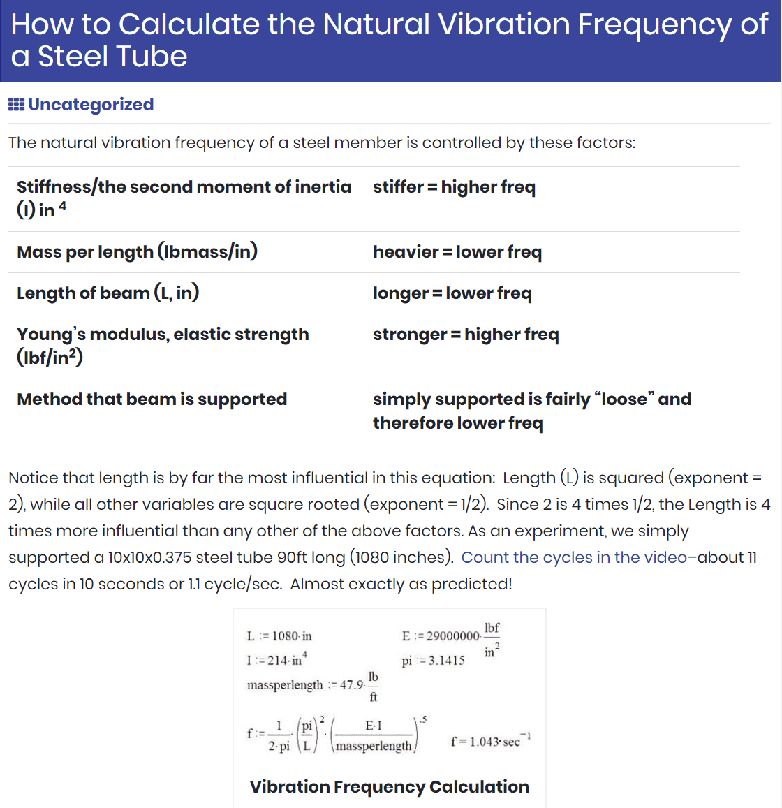

You could measure the length of the bracket as it attaches to the tube and the block. Once you know that distance, use some math to calculate the resonance frequency. Think of it as a tuning stub in a microwave circuit. You could weld another piece of steel on top of the exposed part of the bracket to alter the frequency. But as others have said, you might pick up another one. I doubt Ford did a thorough finite element analyses of this part. Not worth their time since they say race parts are not covered by warranty
JAJ
Apr 9, 2016
2,232
1,987
Vancouver BC
2016 GT350 Track Pack
So, @honeybadger, if you could weigh that piece and tell us how long it is and the distance that each bracket is from one end or the other, someone with a calculator could bung the numbers into this calculation to see if resonance in the tube is a factor:
