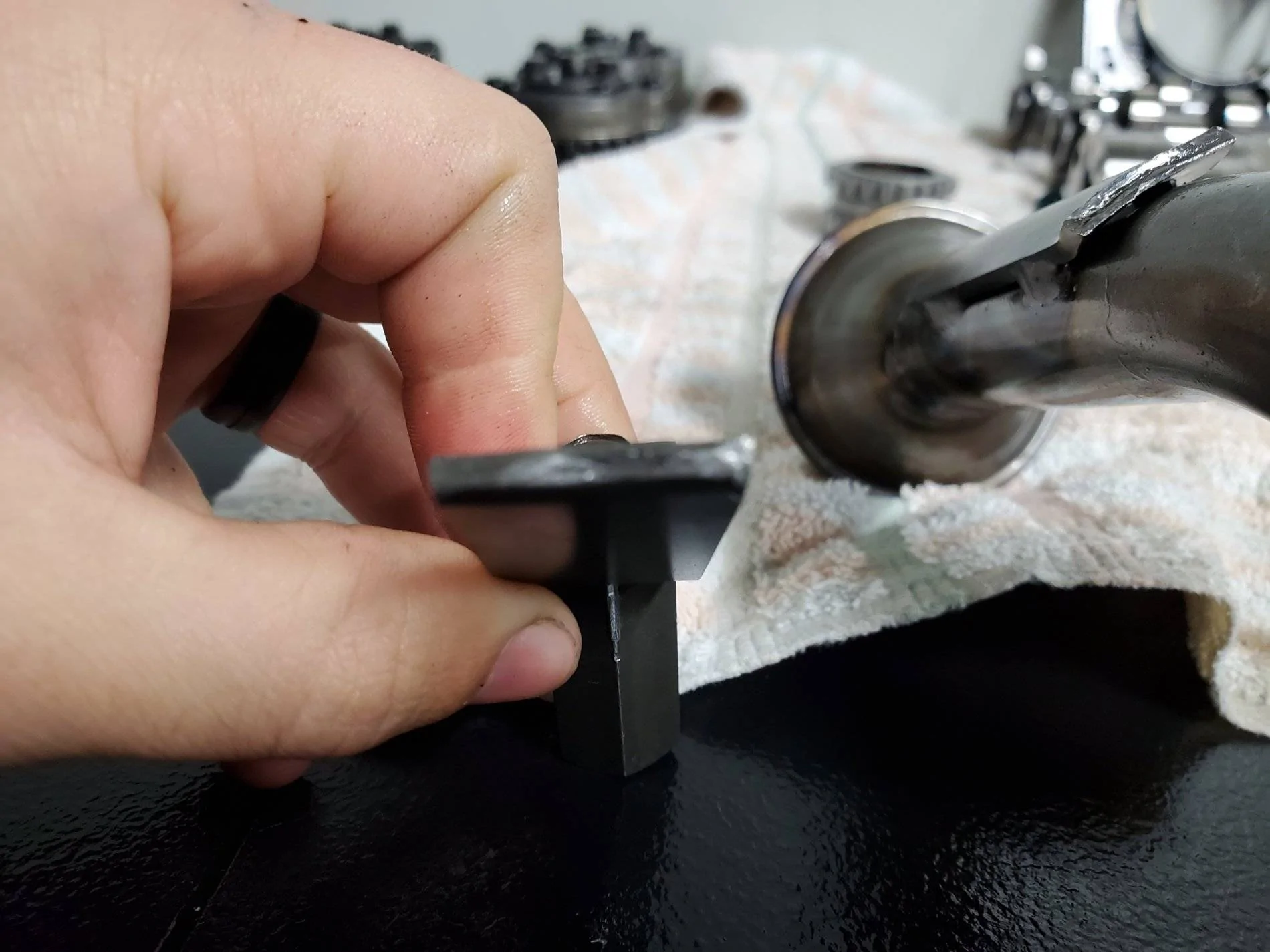

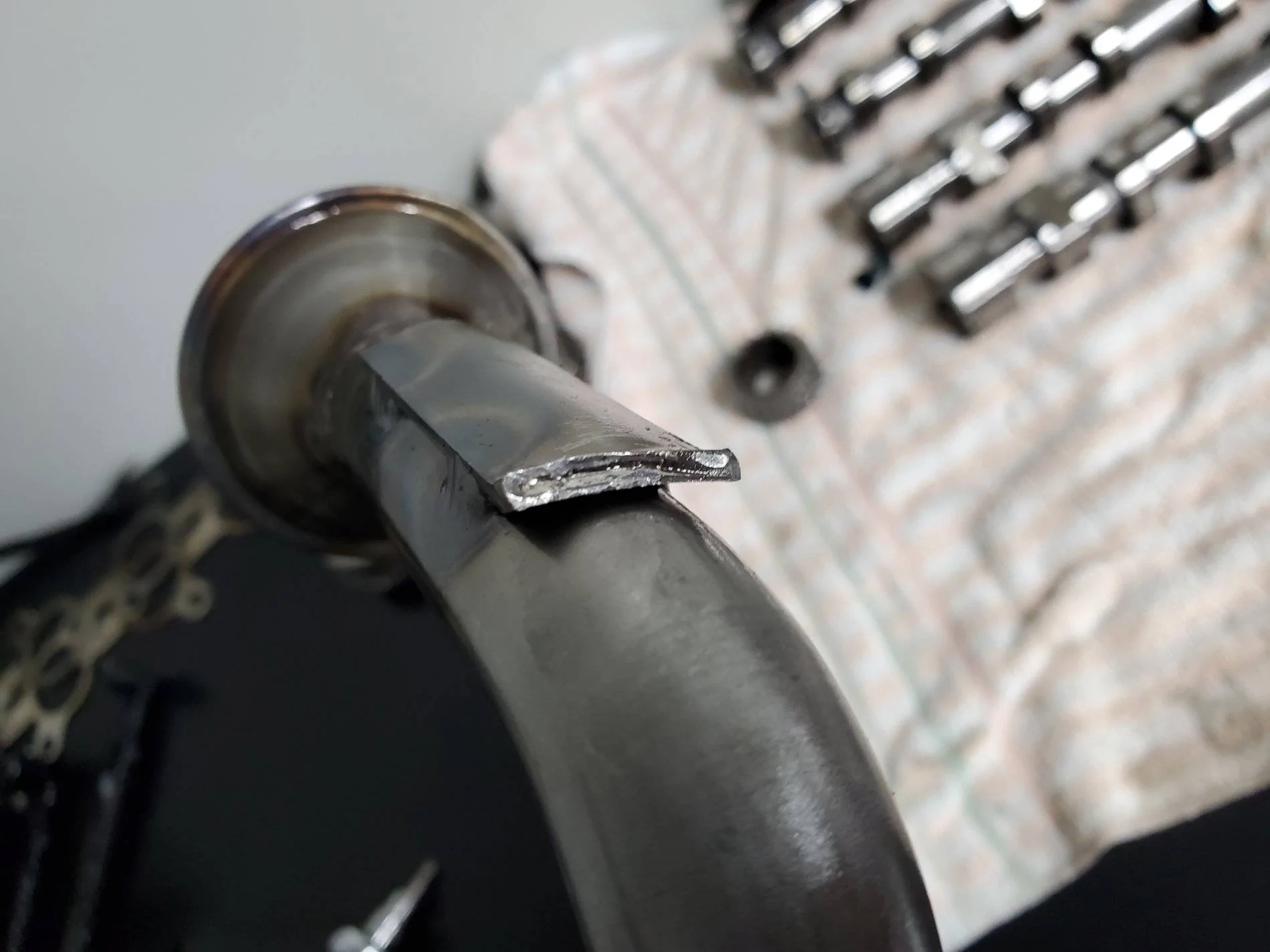

It's possible that the bracket was defective from the start, and it has nothing to do with vibration.
I didn't mean to imply OP was at fault on the part choice. I would surmise that the bend radius is too severe on the bracket given the material and thickness, and was already compromised (internal tearing). It would make more sense IMO to use a round rod instead of bar to make the bracket and then weld to a tab for securing with the bolt.
In order to support the oil pump end of the tube, a vertical element with a rubber foot resting against the pan floor could be fashioned and thereby impart a mechanical force to keep the pickup tube anchored in it's rubber grommet.
I'll gladly accept a residual check from FP for fixing their design. :)

You could measure the length of the bracket as it attaches to the tube and the block. Once you know that distance, use some math to calculate the resonance frequency. Think of it as a tuning stub in a microwave circuit. You could weld another piece of steel on top of the exposed part of the bracket to alter the frequency. But as others have said, you might pick up another one. I doubt Ford did a thorough finite element analyses of this part. Not worth their time since they say race parts are not covered by warranty
Not a bad idea. I'll keep ya'll posted on what the engineers say.
So, @honeybadger, if you could weigh that piece and tell us how long it is and the distance that each bracket is from one end or the other, someone with a calculator could bung the numbers into this calculation to see if resonance in the tube is a factor:
Not a bad idea. I'll get some measurements.
right, so using the 5.0 (or race car?) pickup on the Voodoo pump was a mistake to begin with...
Not a mistake in the usual sense of the word. @honeybadger said that FP advised him it would work, so he used it. It's possible that the bracket was defective from the start, and it has nothing to do with vibration. There's no way to know, but it does make sense to install a more robust part for the next 40 hours.
This is NOT the 5.0 tube. This is specifically designed for the 5.2 (the 5.0 tube won't work due to the oil pump being different). That said, my understanding is that the development was done with the CPC variant used in the FP350S.

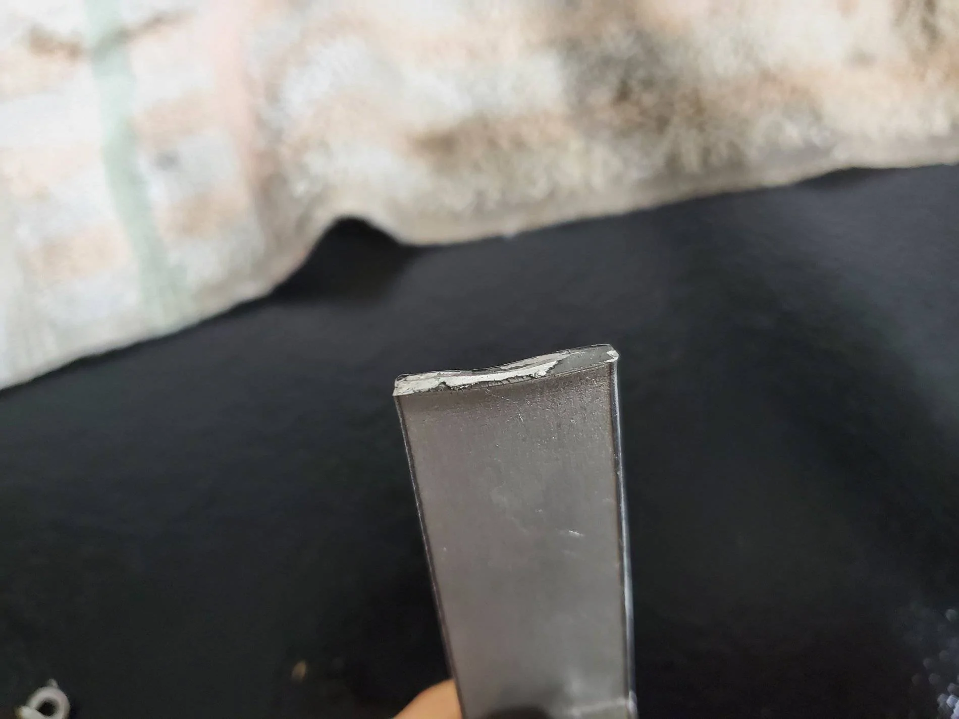

I don't think this is as simple as it just being due to vibration. If we look closely at the ends of the metal, it's got some variation in color and sheen - we also need to consider whether or not the manufacturing method (bending brake) compromised the joint and if there was a different type of flatstock that should have been used that's stronger under the heat.

Another option may be to use a pan out of a Gen 3 Coyote, it has the plastic pick up tube and windage tray all as 1 piece. The capacity is 10 Qts and the plastic should do a better job at absorbing the harmonics.
I'm no metallurgist and it's been a long time since my mechanics of materials class, so I might be wrong, but that looks like a fatigue failure. I see a dark spot which is surrounded by brightly colored metal. The dark spot I think is where the crack started and grew slowly over time. The bright parts are areas where the metal failed very quickly (when the piece snapped). Fatigue failures happen when a part is stressed cyclically over time, which is what that bracket would have gone through as a result of the vibrations from the engine as well as the loads from cornering and braking.
This is just a guess though so don't count on me being right!

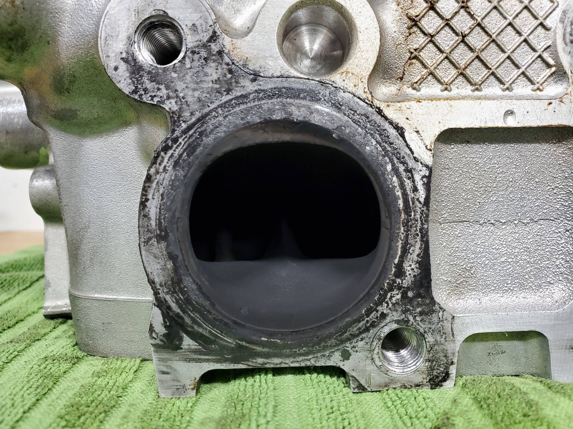

I didn't take many pictures this phase due to how often I had fairly nasty chemicals on my hands. But essentially we had two goals. Clean off the excessive carbon/oil build up from the oil burn and install new valve seals.
As always, here's a video of some of the work. Lighter than normal text update below as well.

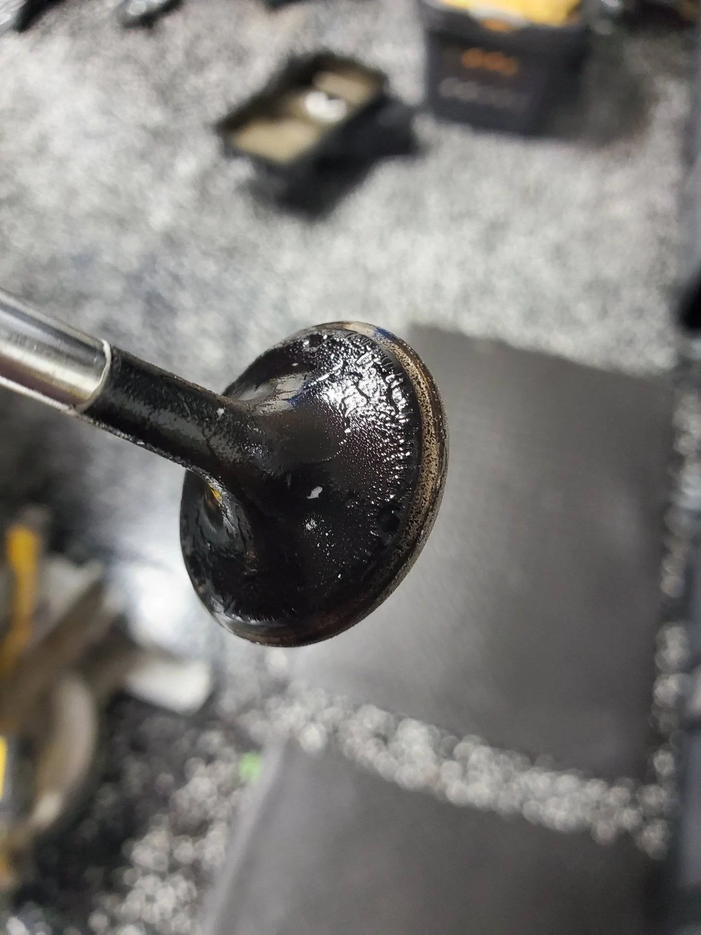

First up was to clean the exhaust ports and valves. The last few hours of running really was burning a lot of oil (1.5 quarts a day). So they were very caked.

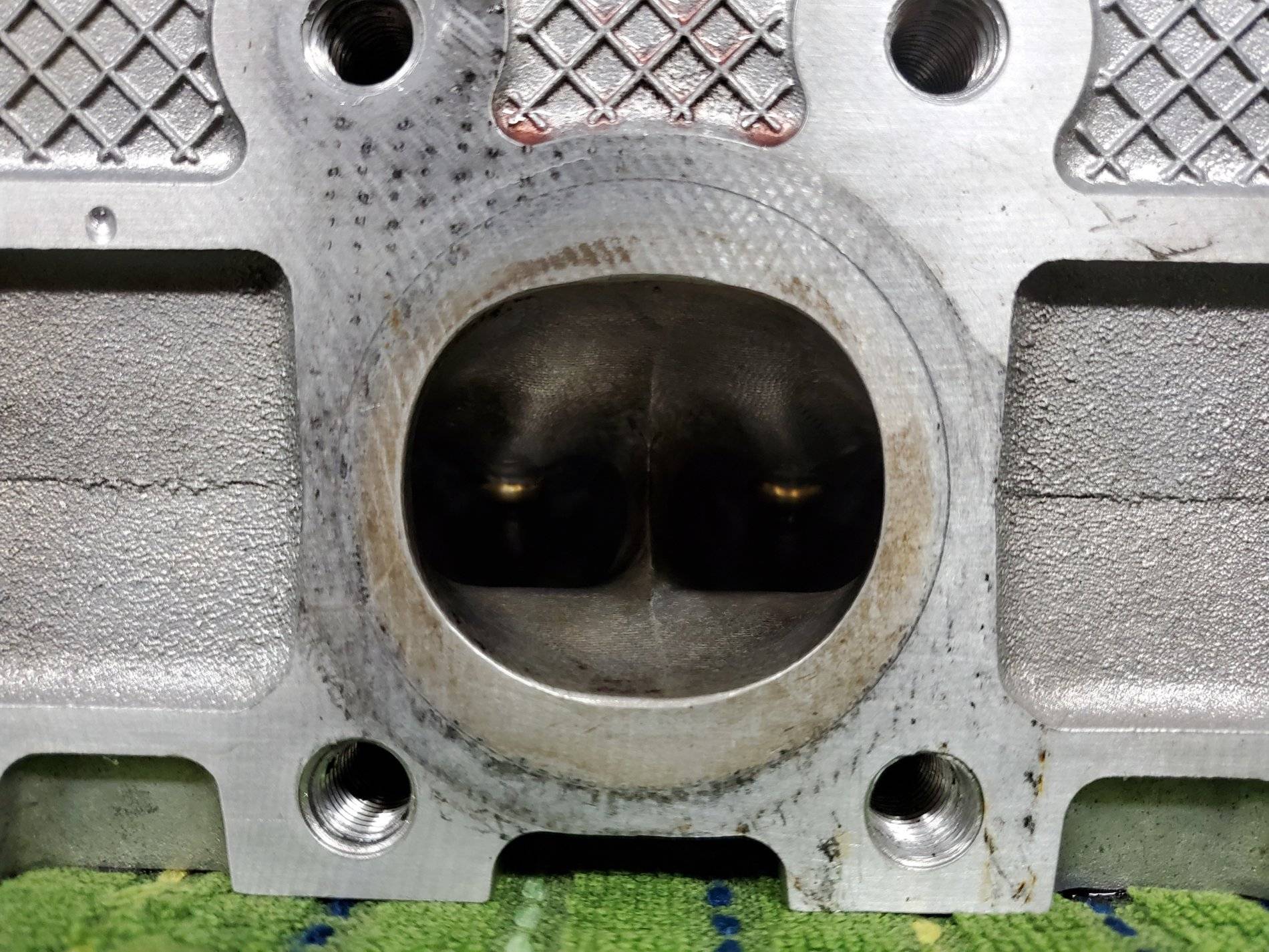

To clean them, I first tipped the heads on their side so the ports were facing up. I then filled each exhaust port all the way with brake clean and let sit for 24 hours. The next day I took them outside and sprayed them out with more clean. This got 85% of it out without any scrubbing. Afterwards, I re-filled again and let soak with fresh brake clean. I then lightly scrubbed with a tooth brush. This got the rest out.

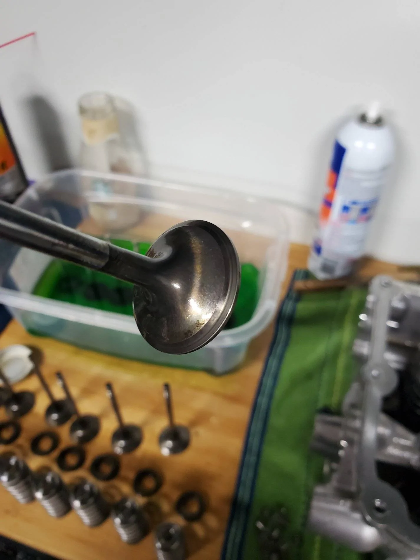

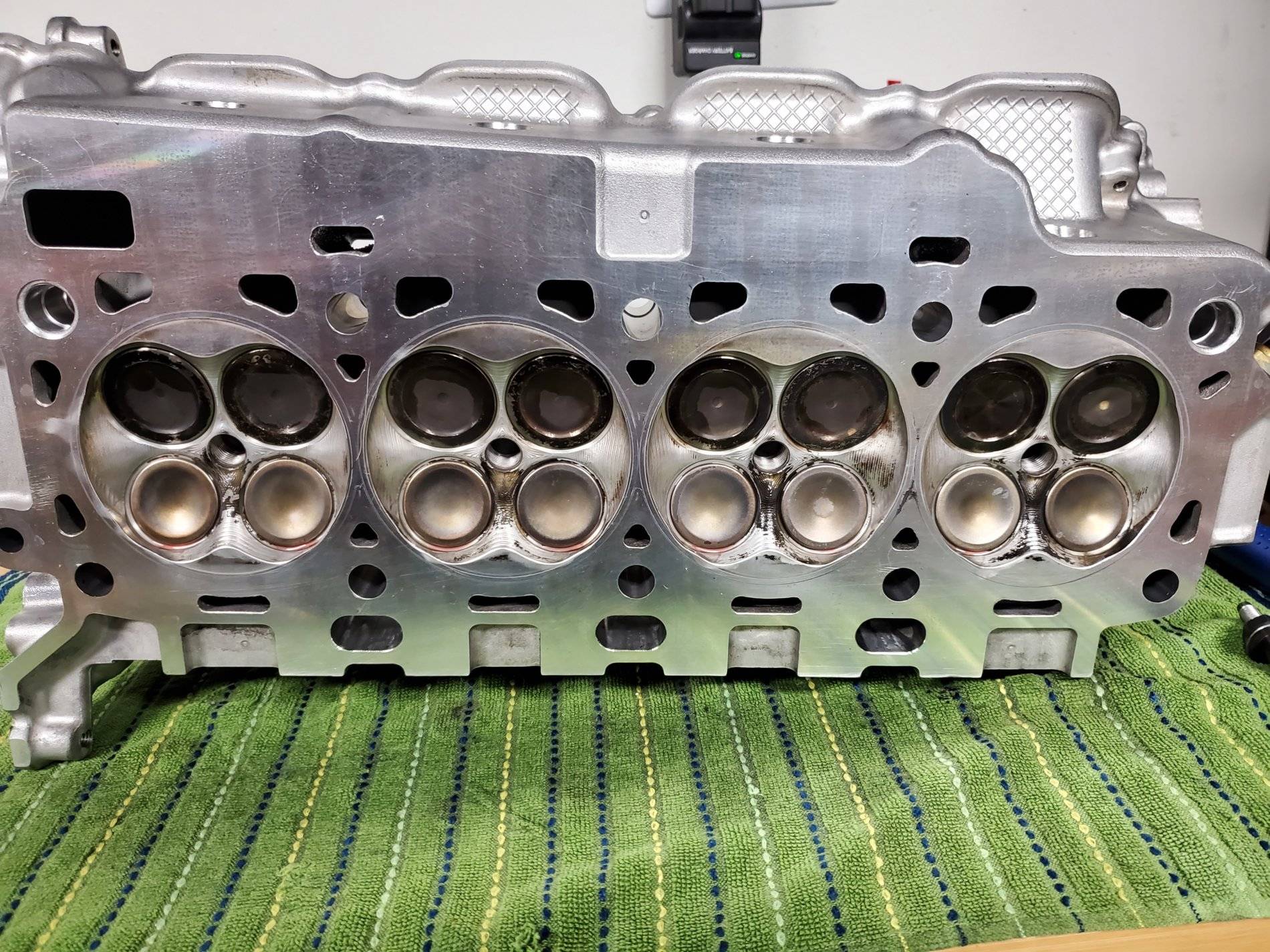

For the valves themselves, I removed the exhaust valves (intakes were clean) and soaked them in simple green for about 20 hours. The carbon was super soft and brushed right off afterwards (I used a brass wire wheel on my bench grinding to clean).
After cleaning
For the combustion chambers, I just used a brass brush on a dremel + degreaser. Not perfect, but plenty good enough.

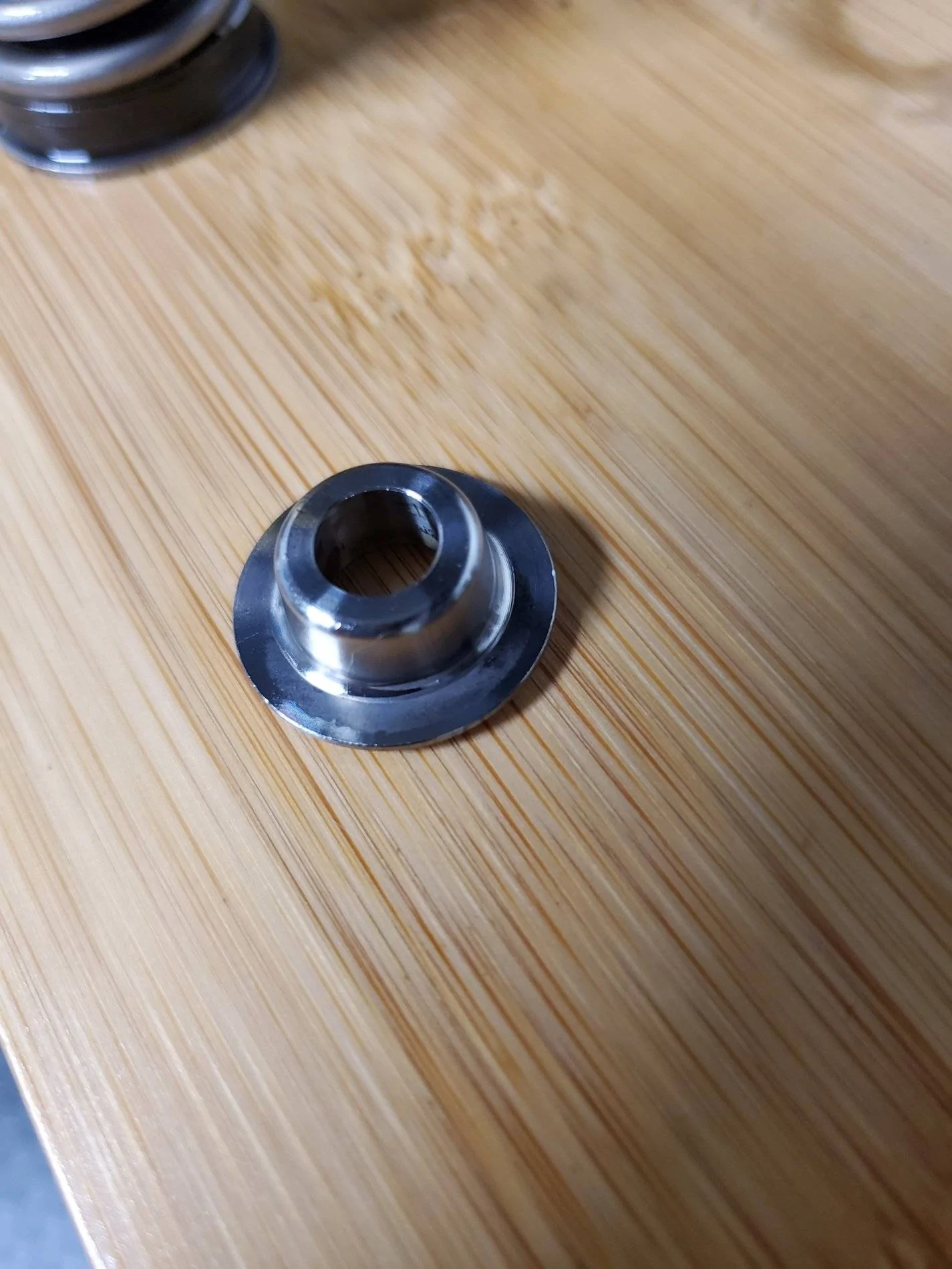

While all apart, I inspected the valve train for any signs of wear and so far it all looks fantastic. The titanium retainers are hardly showing any wear:
and there's no slop in the guides, springs look great, etc. Confident in at least another season out of them.

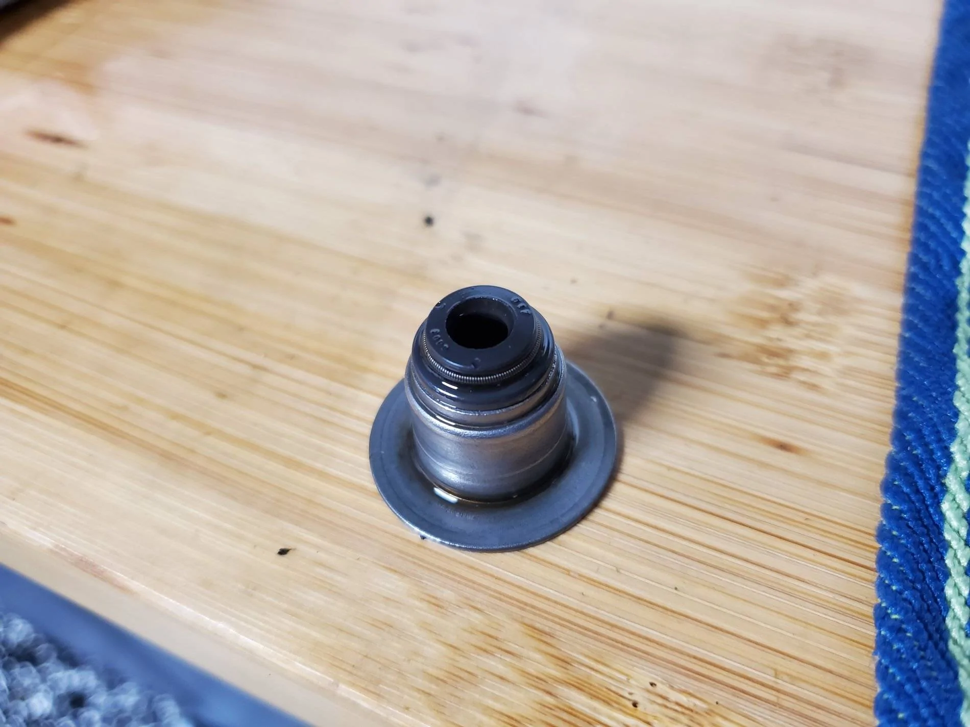

Regarding the valve seals, they appear to be OEM. So either they were my originals re-used or something caused pre-mature wear (maybe not enough lube on first start?). Who knows. Hopefully the new ones last longer.

Sorry if I missed it but why was the engine burning so much oil at the end?
honeybadger
honeybadger
Just don't care
Apr 20, 2016
63
4,120
7,495
COTA
Kevin
'17 GT350
Bad valve seals...not sure what led to their failure TBH
