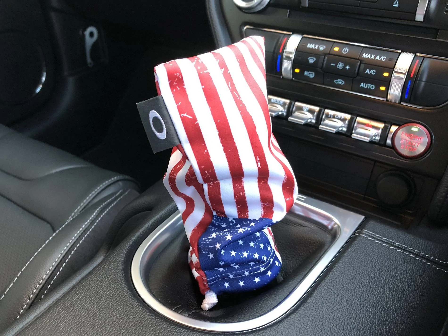

Got a nice little patriotic bag to keep the sun of my knob (no clear over the paint fill I did) and to keep the end polished up ready for use … :devil:

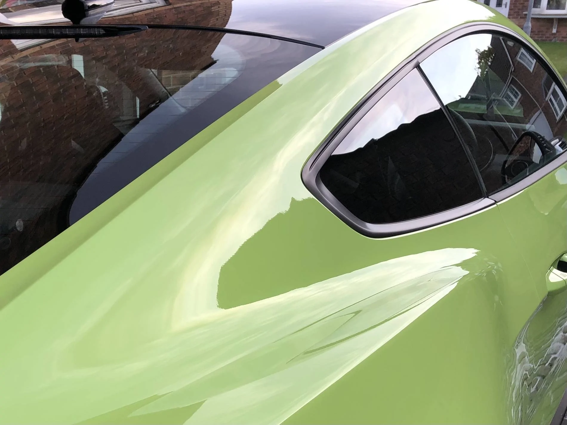

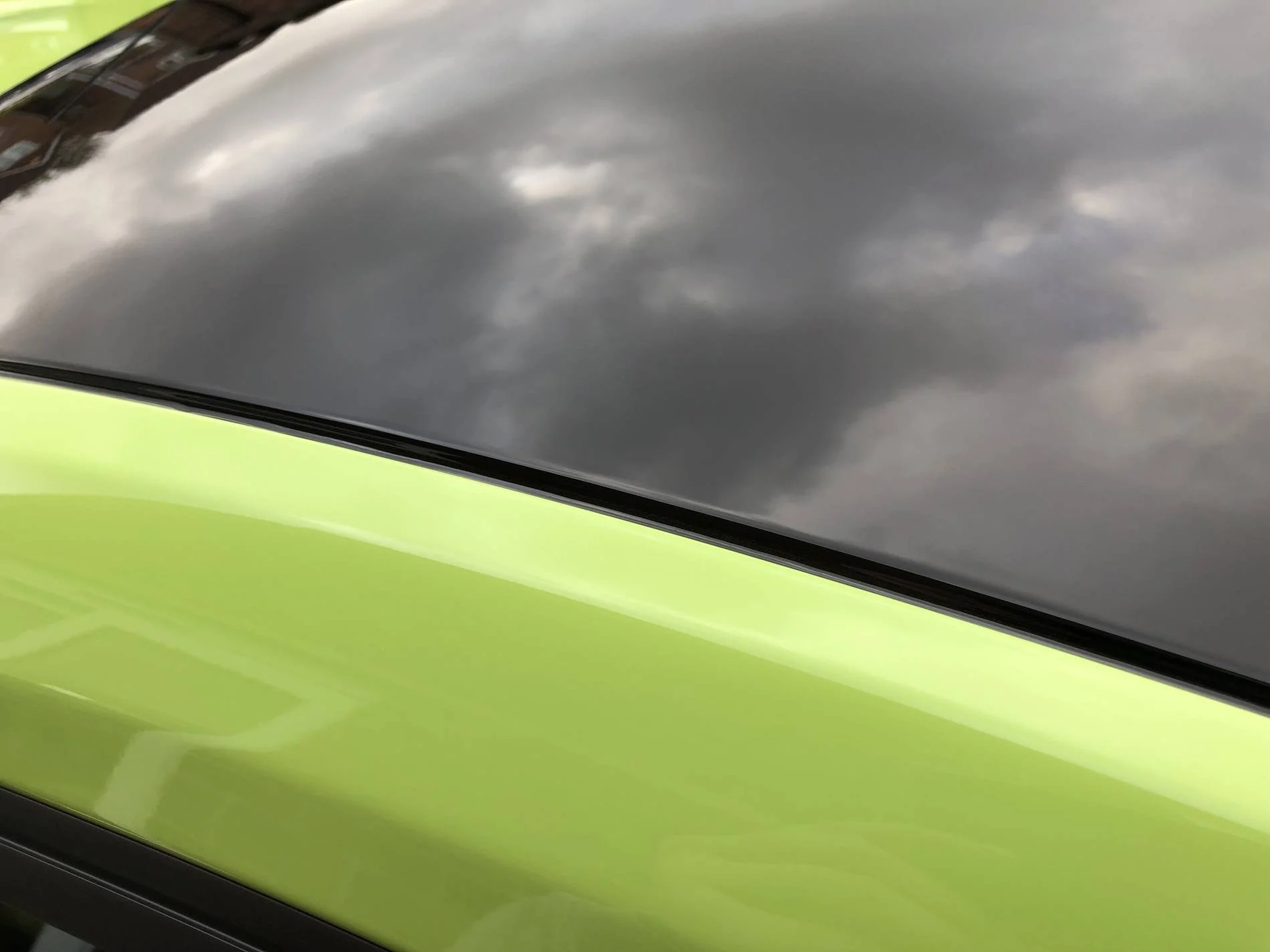

Two bucket wash, clay mitt and then I polished and waxed all the upwards facing surfaces + headlights + mirror caps.
Turtle wax hybrid ceramic (polish & wax) on the green stuff and the same but the black version on the roof, mirrors and vents.
I masked the roof and any trim :
As the black version has dyes in it that stain :

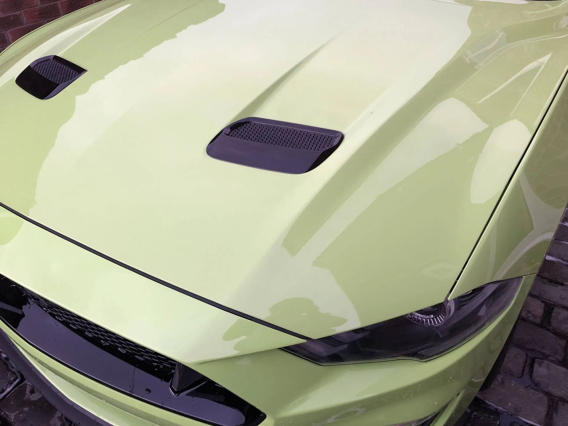

Smooth as silk and very glossy - I was loosing the light when I finished so the iPhone bleaches the colour out, but you get the idea :

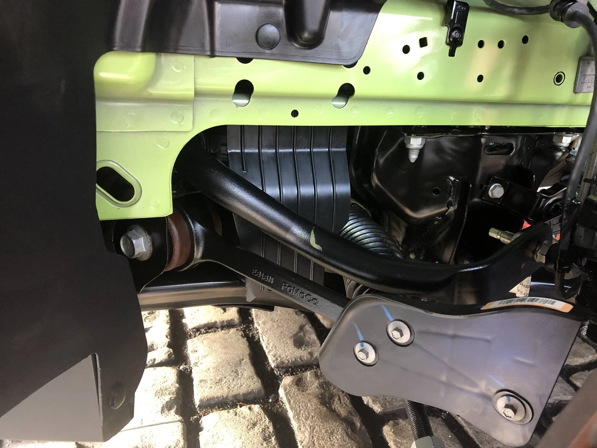

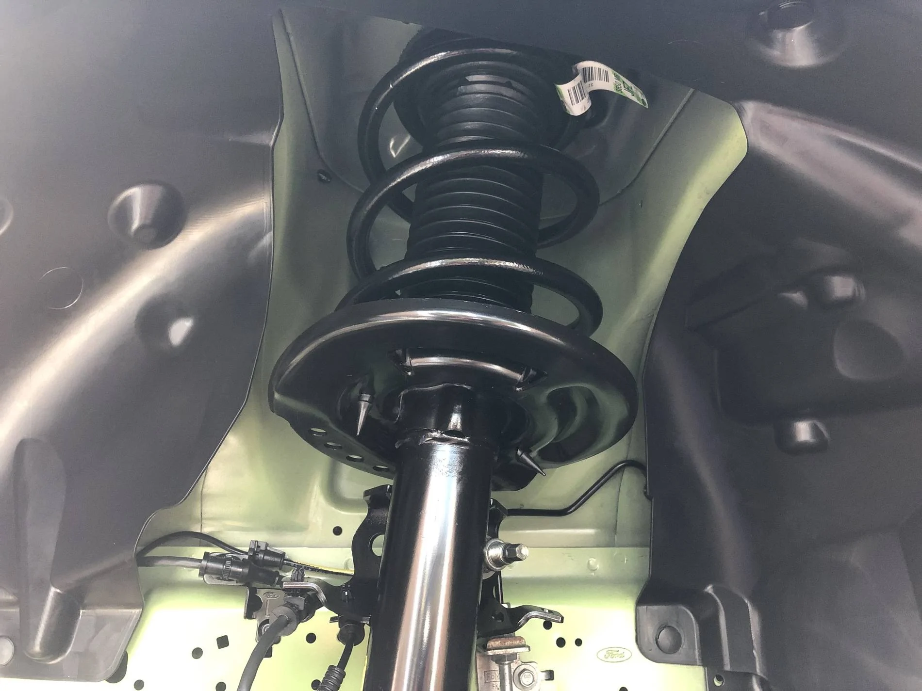

Well my three girls are isolating so as we weren’t going out with family today, I started a job that I kept putting off.
Under arch wash down and the rust preventative :
This is the stuff I used :
After washing / wiping down I used white spirit to get rid of the (Ford applied and still dripping) cavity wax and cavity wax overspray, there was a lot of it …
I then soaked it in Lanoguard and worked it in all the brackets and joints etc with the brush. I finished with the microfibre which is now saturated with the stuff.
Lanoguard (similar to fluid film for anyone stateside reading this) is made from lanolin and no joke, my car (and driveway) now smell like sheep / an old farmers Land Rover … :facepalm: :giggle:
I also cleaned the arch liner up (more cavity wax overspray) and then did the wheel - yet more cavity wax overspray :
Finished the backs with black turtle wax ceramic :
I’m not relishing the thought of doing the other corners, but I will get around to them sometime :blush:
I will finish with the underfloor, hopefully on the lift at my mates garage :like:

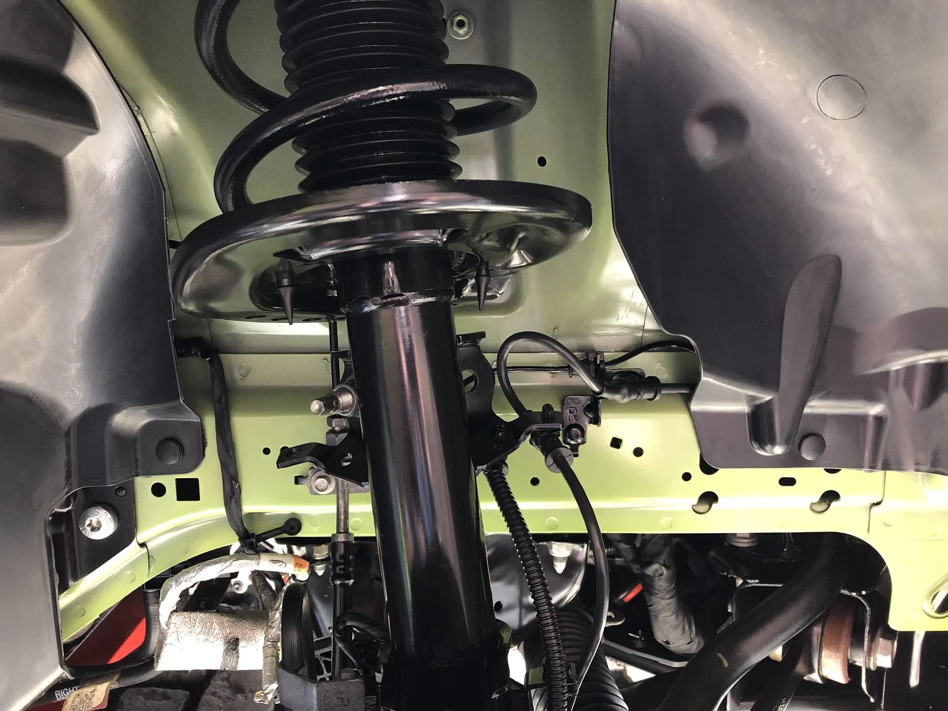

Back to under seal. I actually think Ford did a good job with the yellow cavity wax stuff, they seem to have got that everywhere and used lots of it - it’s still dripping over a year later … ? !
That black stuff is another story though, they seem to have sprayed that everywhere other than where it’s really needed. It’s been time consuming to clean it off the upper body, exhaust tips and wheels etc you know, the places that really needed it :facepalm:
The only thing I have found that shifts it quickly and reasonably easily is thinners.
House jobs today, the only thing I got done car wise was to paint the pony from the front wheel I had off yesterday :

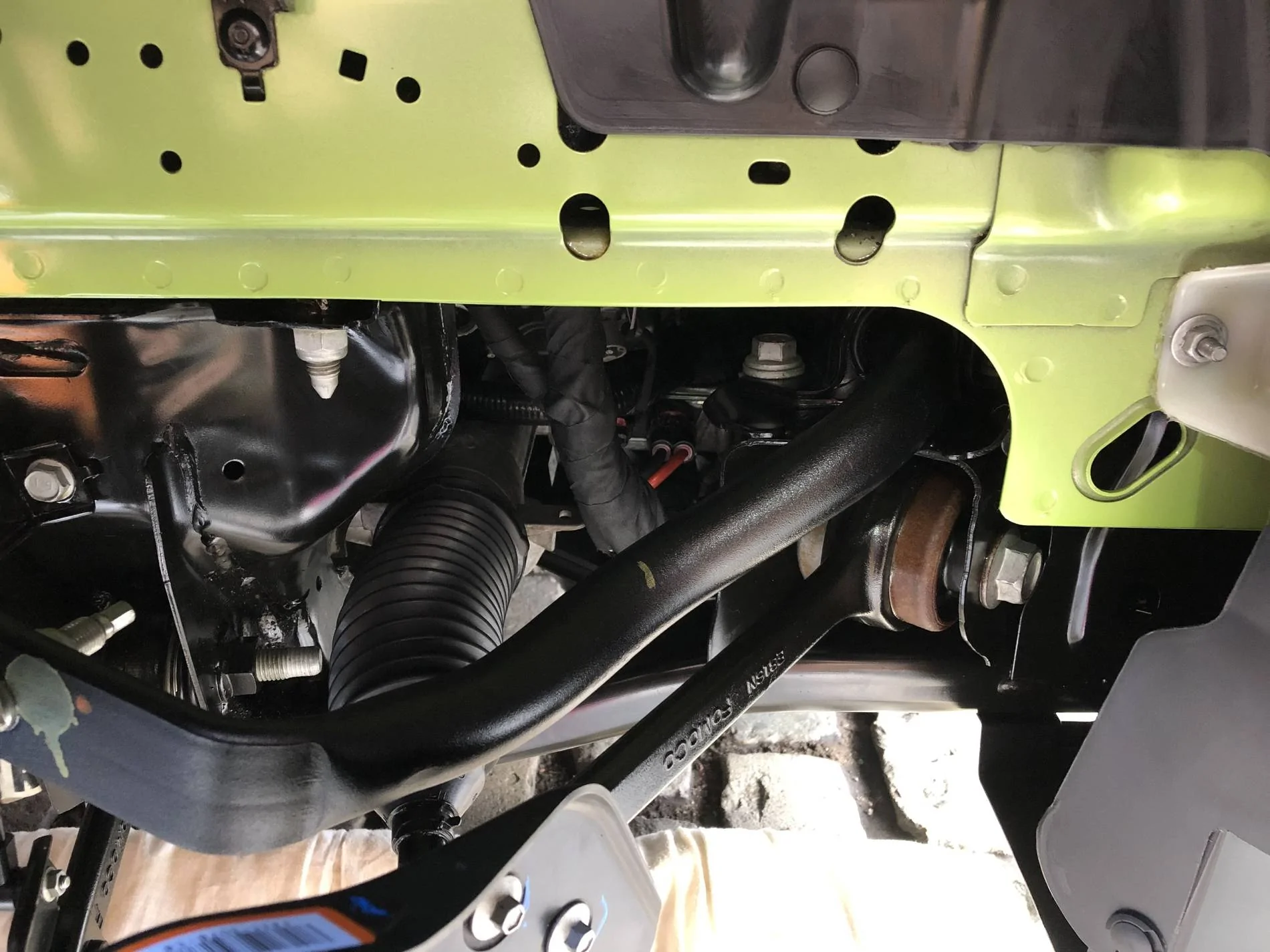

(Yesterday) Other side done, might as well make the most of my last weekend of isolation …
Less cavity wax leaks and overspray on this side :
Much colder this weekend though (just above freezing), so I had to work with the heat gun to keep it spreading evenly :

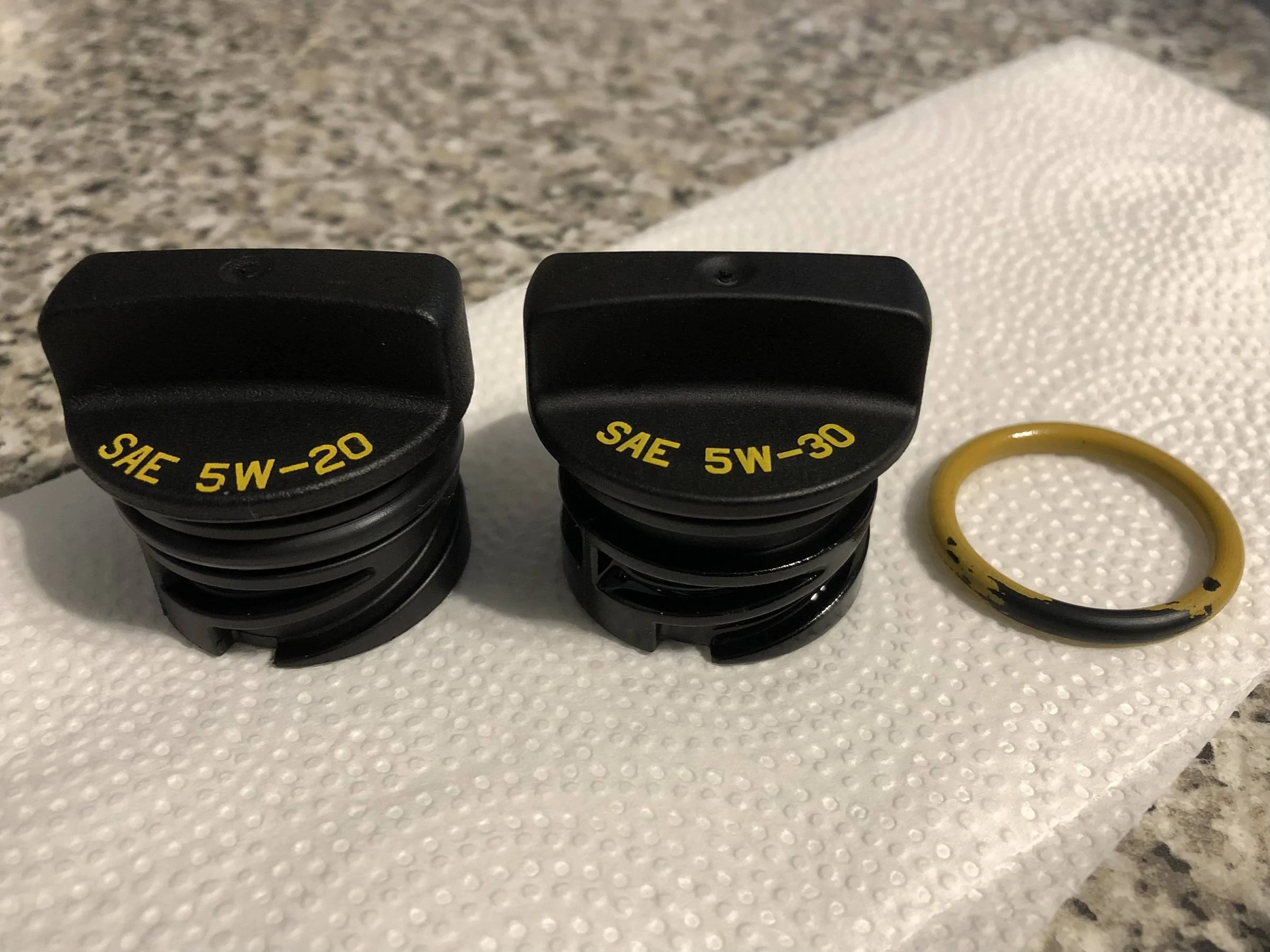

Not a huge amount to report, but I did finally upgrade my engine from 2020 to 2021 / 2022 spec … :giggle:
Although I did decide against updating the engine cover - if I’m keeping the starship enterprise under the hood I would rather have the two tone 2020 version rather than the single colour all black version of the later models … :bandit:
Part number if anyone is interested :
I did notice that the yellow paint that Ford use on the o rings had started to come off and contaminate the oil chimney :
I can’t find any reason why Ford use that paint (there’s also green on the dipstick seal) so I cleaned up the oil chimney and removed the paint from the filler cap o rings :
Regardless of if it is old / heat cycled / hard / brittle or if it’s new / soft, it rubs off easily with a damp microfibre.
