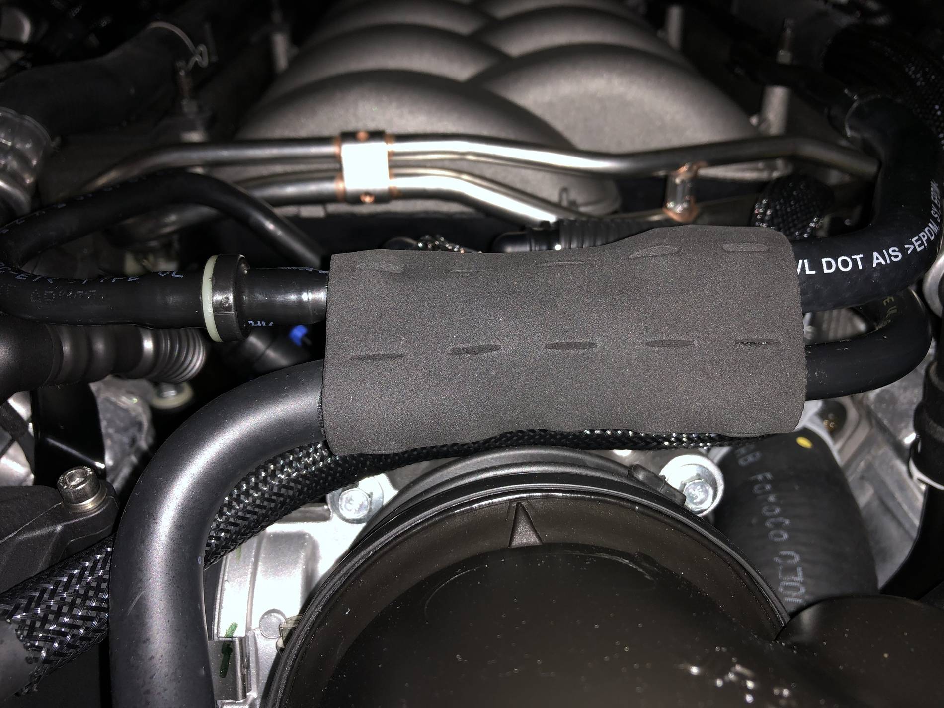

Took the opportunity of the unusually hot weather to waxoyl the inside of the hood :
It goes like water inside a really hot hood so I cycled the hood up and down until it was running out of every drain hole around the outside edges - probably took about half a can plus a bit more.
Cleaned up the mess and other than the smell, you would never know it was there. Maybe it will help in later life, maybe it won’t … ?

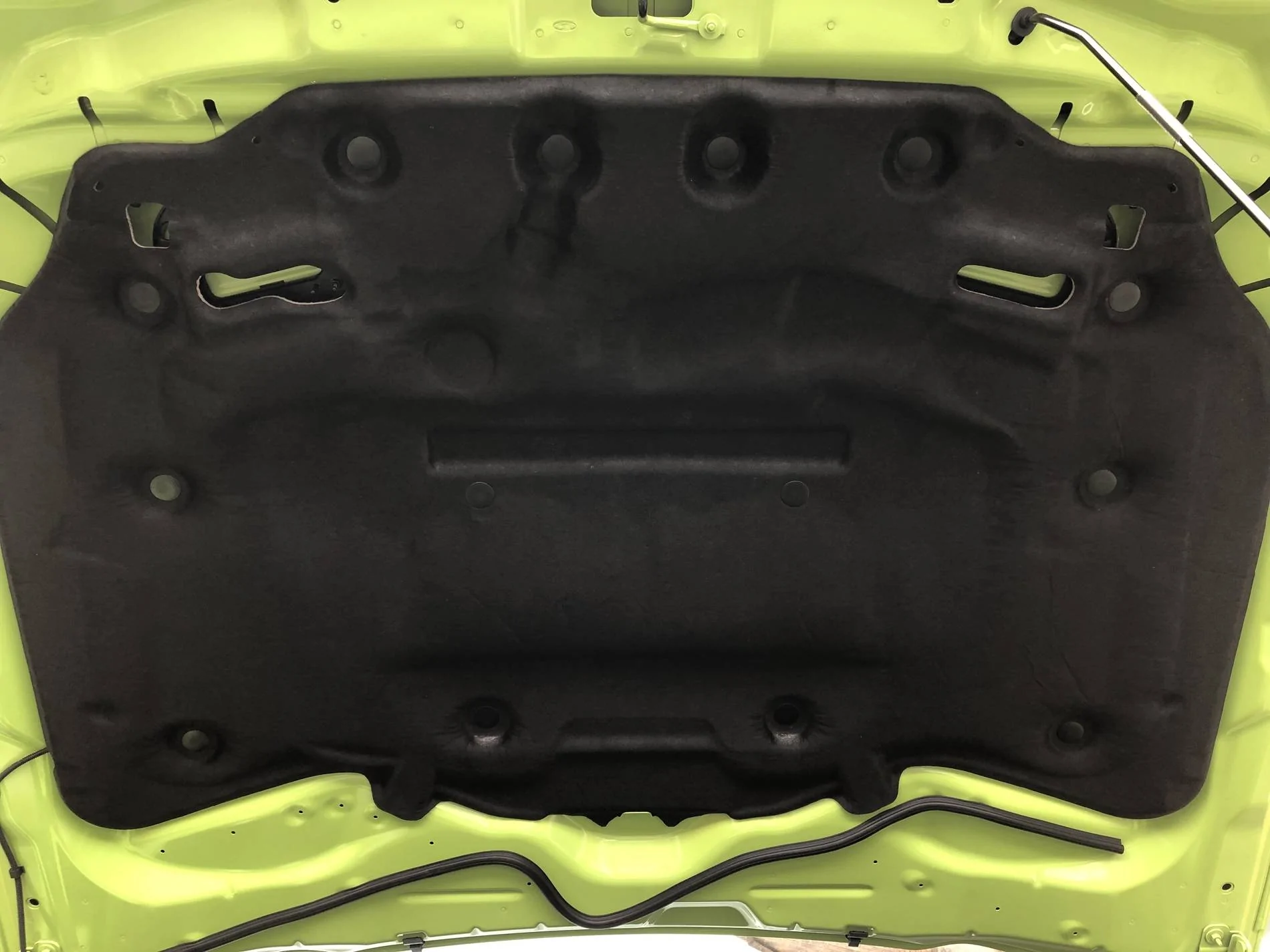

So after sorting the hood vents and adding the waxoyl the new hood blanket went on :
If anyone was wondering why it was new it’s because it was a warranty claim as the first one got holes rubbed in it. The throttle elbow was rotated incorrectly when it was fitted, that lifts the end of the elbow and pulls the air box up a bit = holes in the hood blanket started to show at less than 500 miles … :frown:
That arrow should be at 12 o’clock :
And rotating it the 10mm or so to put it in the right position drops the far end of the elbow about 15 to 20mm.
I had actually corrected the issue and enquired about buying a new hood blanket, but when I found the cost we pushed it down the warranty route. My dealer was great as I had all the before / after photos etc :like:

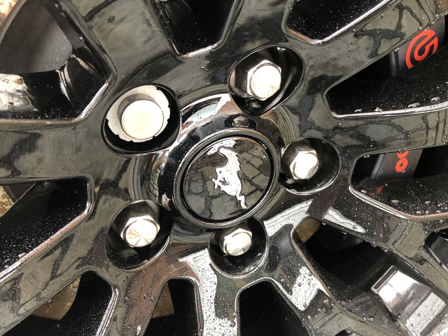

Washed it today. Got another coat of turtle wax hybrid on the hood, roof and trunk, then clayed the sides and mirrors and got a first coat on them :sunglasses:

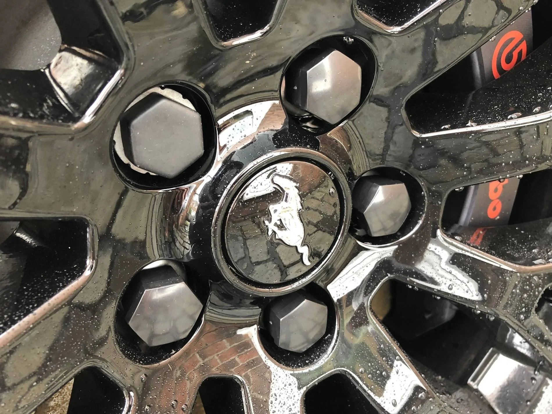

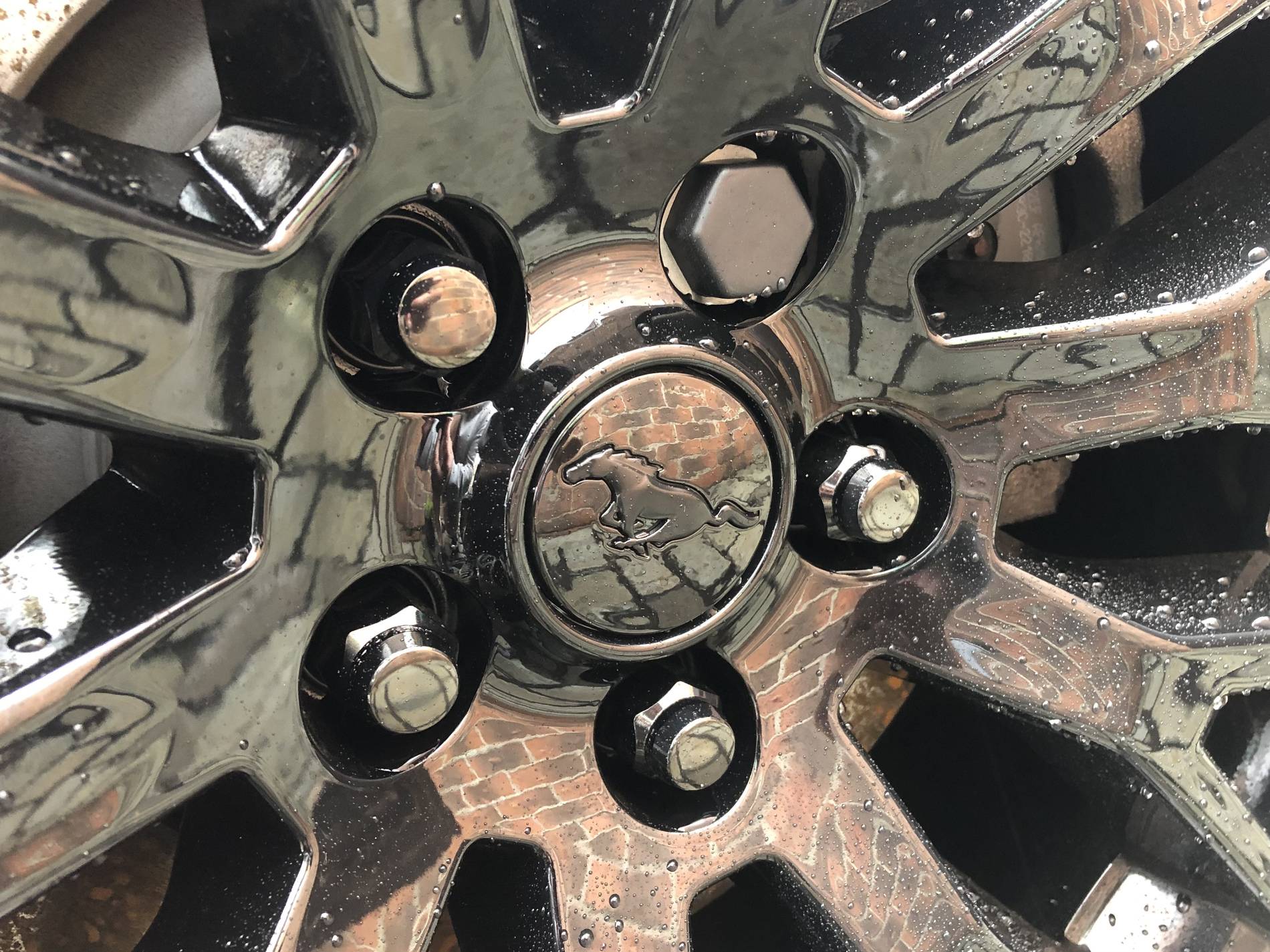

I had taken the chrome pony’s out of the rear wheel caps when the rear wheels were off. I scuffed them up with a 3M pad, cleaned them with thinners and then added two coats of etch primer and two coats of satin black :
I will let them cure on the window sill for a few days and then pop them back in, they should compliment the blacked out wheels nicely :like:

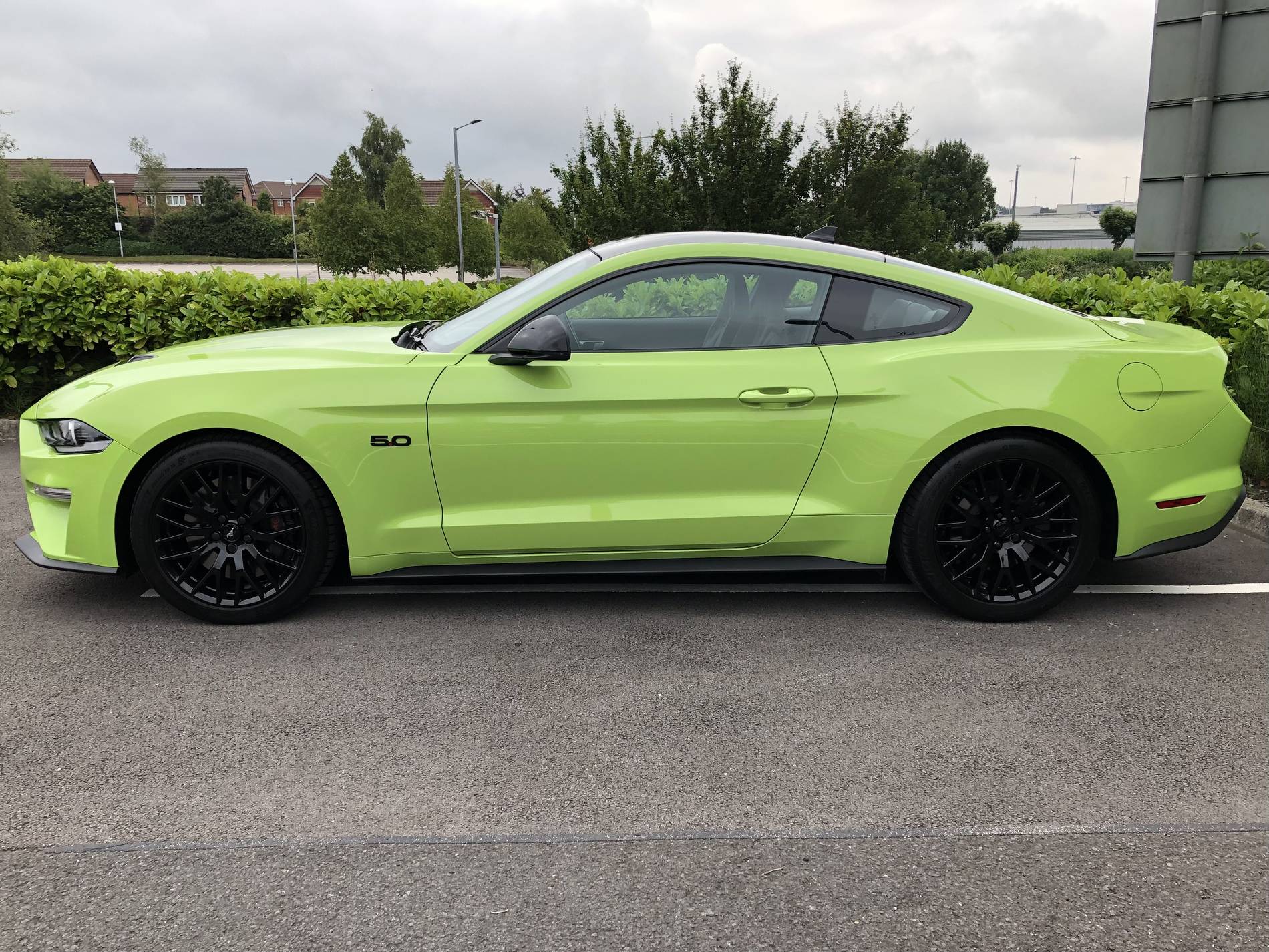

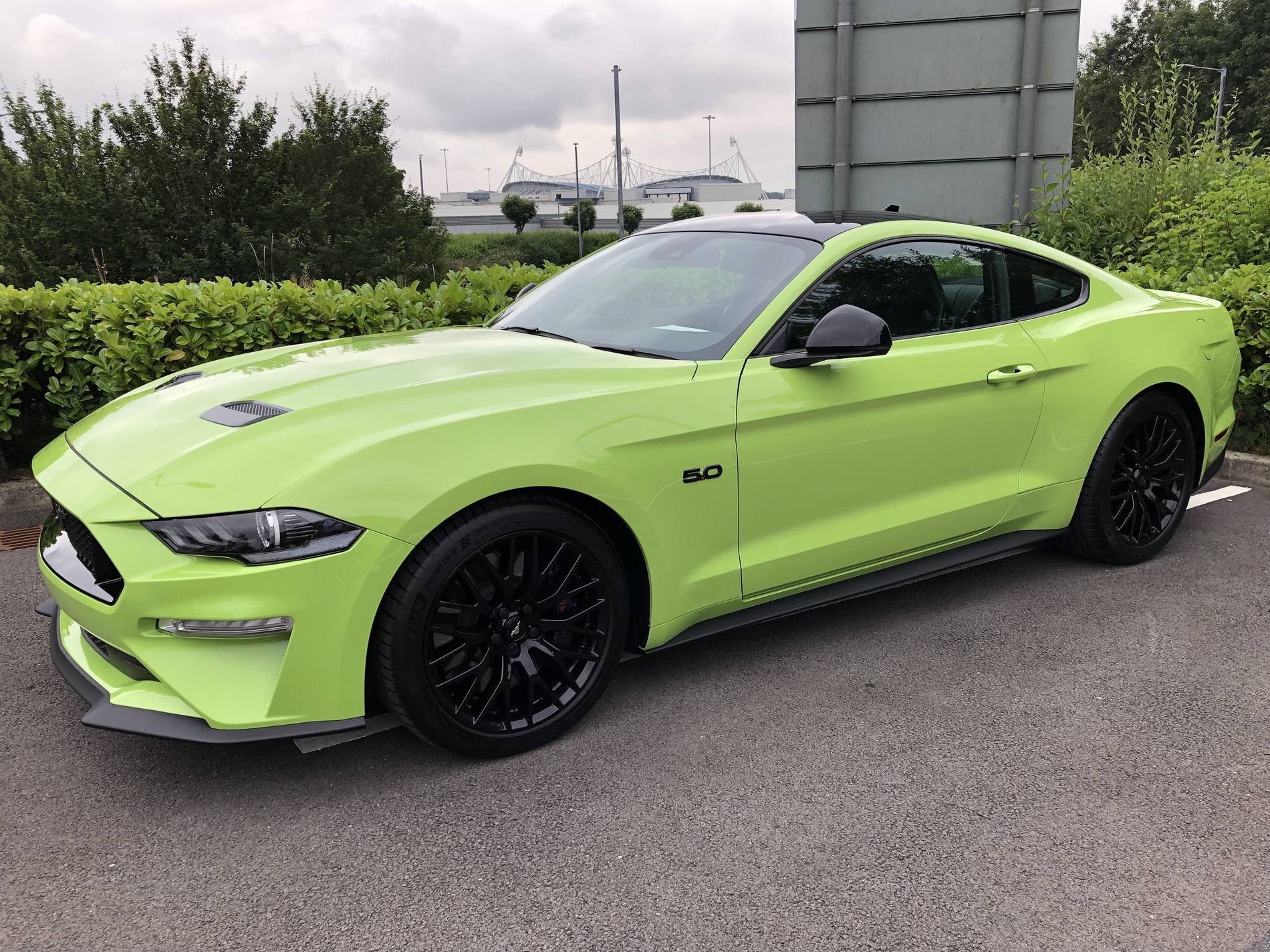

Got to show it off a little before the rain starts again, I think this is its fourth, maybe fifth time into work now :like:
Cleanest commuter on the carpark, but then there wasn't many there (only reason I took it) ... :giggle:
Its funny how people get an impression of you based on circumstances - one guy at work who hasn't seen it before told be it was a well out of character for me, yet others who know me outside of work tell me 'that's you all over ...' :wink:

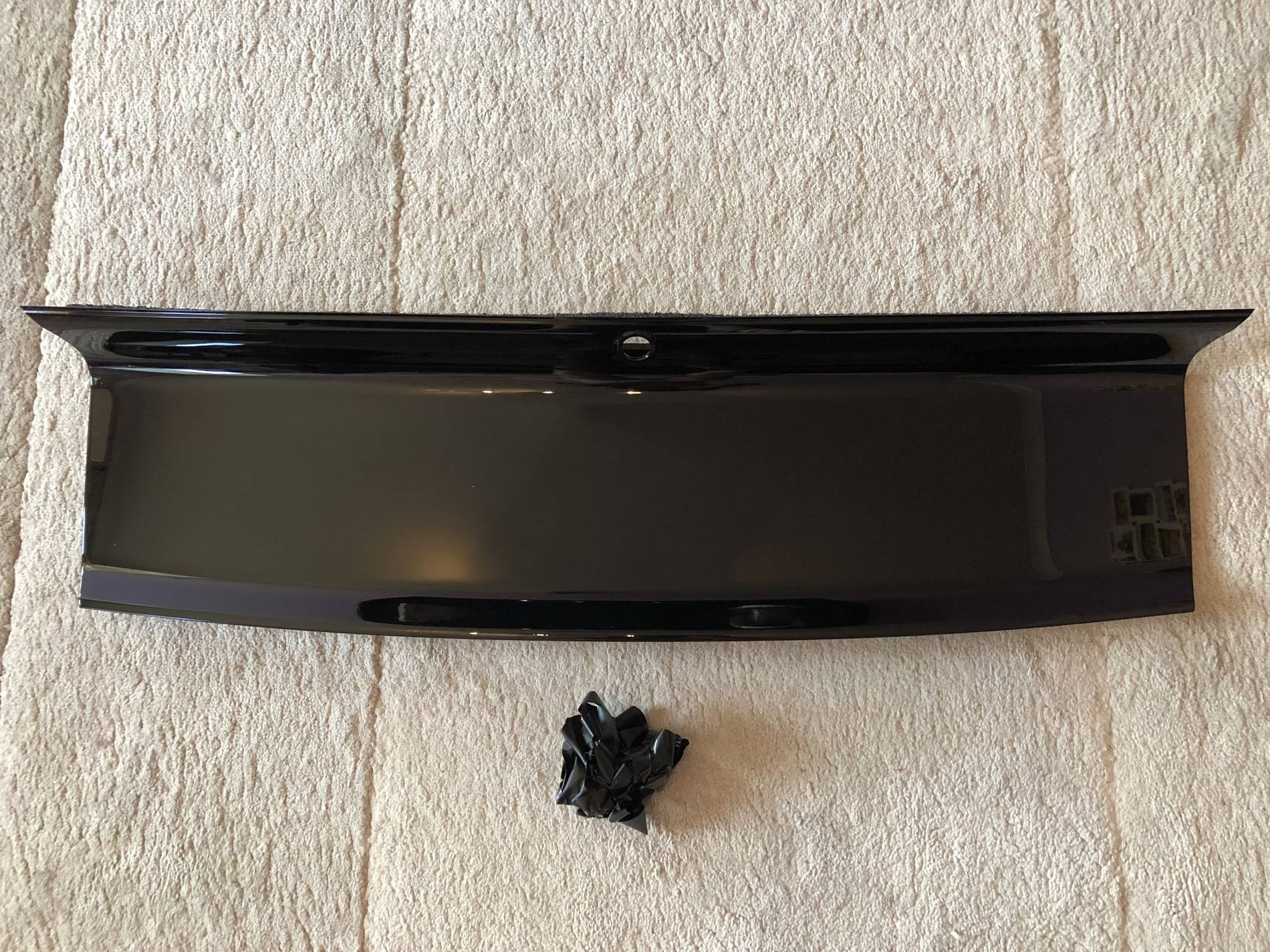

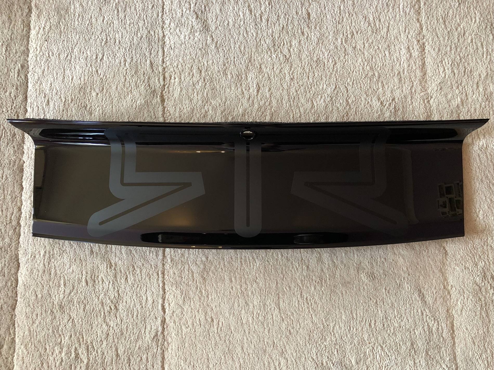

I did finally find a new / boxed / original Ford 15-17 blank decklid panel :
I just had to pull some decals off it first, fortunately they came off very easily :
I also clicked in the rear pony centre caps, very pleased with the look and the overall difference they make to the look of the car when you are aiming to get rid of all the chrome :
This was the temporary measure I had been using (plastic nut caps / silver pony) :
And this is what Ford gave me to start with :
Whilst we are on about nuts, I also had a ‘discussion’ with another forum user on the correct size socket for the standard stainless capped nuts that the car came with. I got called out for quoting 13/16” rather than 21mm so after “Not bloody likely. Any other bright ideas?” and “Maybe the problem is you're just not very good at working on your own car” I found a bit of unexpected spare time on my hands so I decided to make the following short video :
Not that it matters anymore as most people opt for Gorilla’s (21mm) or the awkward sods that pick McGard’s (22mm) ... :giggle:

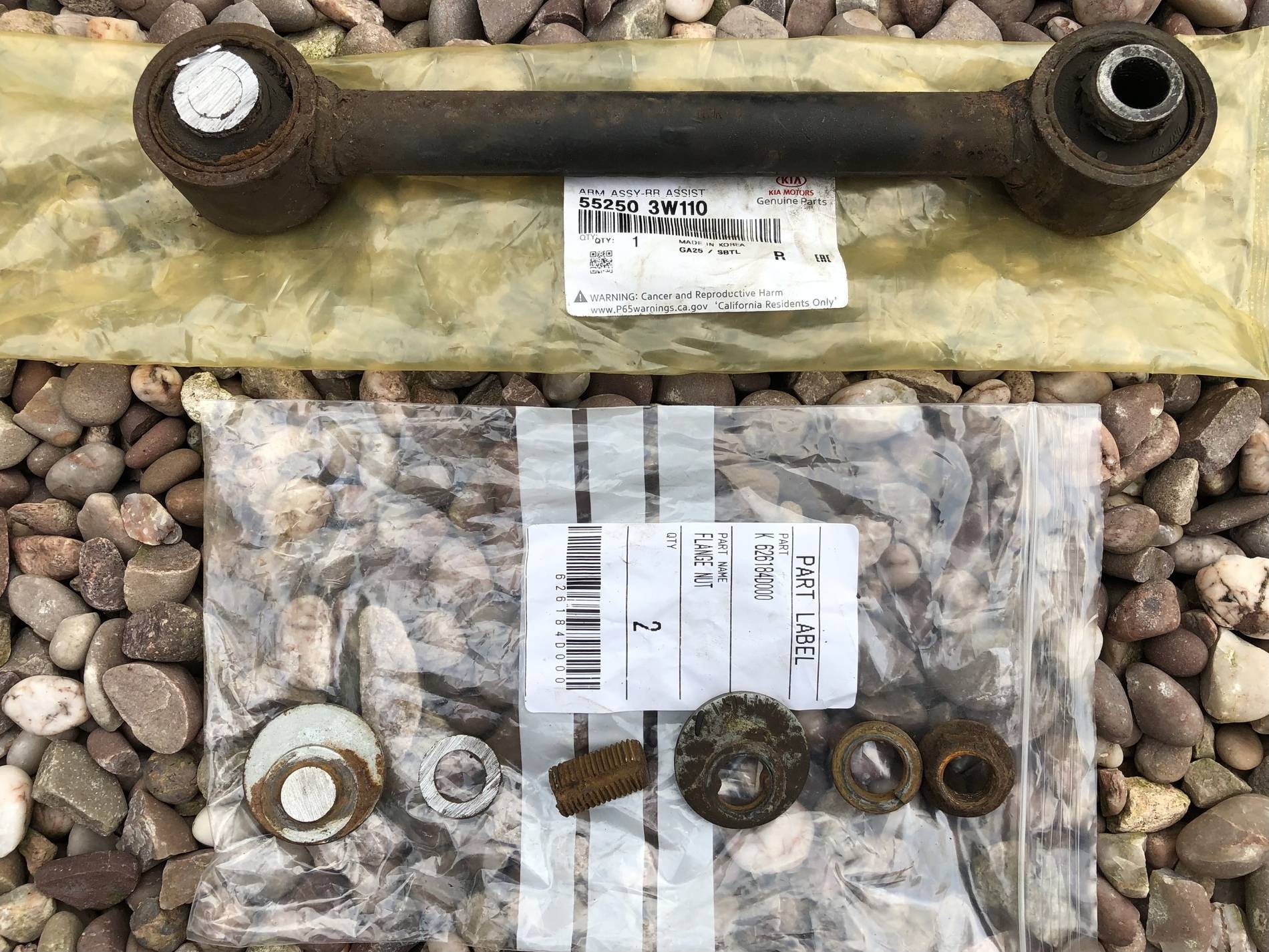

Spare time at weekend was spent replacing a control arm on my daily (Sportage). Should have been a 20 min job but the camber bolt was seized in so it had to be cut out and replaced :
Can’t complain too much, that’s the first what I would class as a non wear item I have done on it in 10 years and 60k. 60K might not be a lot for a control arm, but that’s what a typical (non lockdown) 78 speed hump day does for your suspension … :headbang:

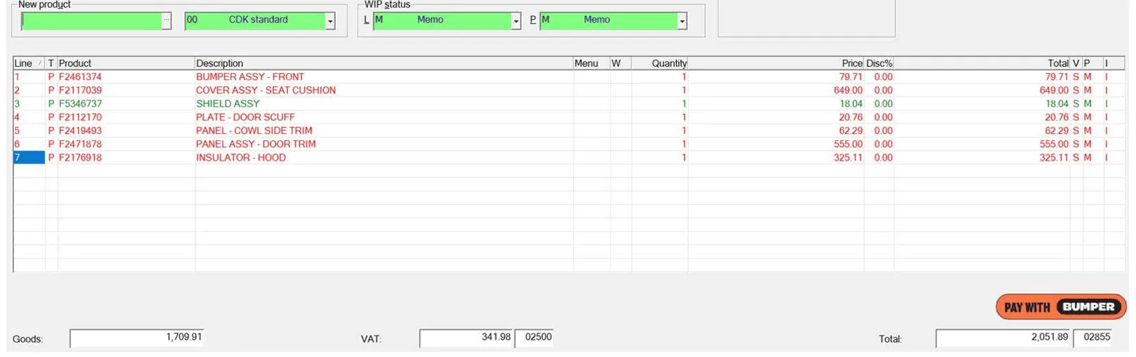

Back on the Mustang. I had kept quiet about the delivery damage / warranty claims I had on the car from new (didn’t want to jinx it), but now they are all done and I have the costs, I will share details accordingly :like:
Items that Ford did wrong at Flat Rock :
  • Hood blanket.
  • Drivers side inner door panel.
Items that got damaged during transport :
  • Passenger side door mirror cap repaint.
  • Front bumper repaint.
  • Front splitter.
  • Recaro drivers side leather seat base cover.
  • Recaro drivers side plastic seat base trim.
  • Lower drivers side door sill trim.
  • Lower drivers side A pillar trim.
Note that the drivers side inner door panel appears on both lists because A) Ford fitted the wrong item and B) they then kicked and scuffed it during transport ! The slightly annoying thing is that I fixed the door panel (using heat) so it didn't need replacement, stood back to admire my work and then noticed it didn't match the passenger side ... :facepalm:
The bumper and mirror cap were repainted before I accepted the car, but adding the other bits up and adding on the VAT that list comes to £2051.89 so maybe £2500 ish with the paint work … ? :shock:
I appreciate Ford will see less cost than that but even so, transport damage must be getting on someone’s radar somewhere … ?

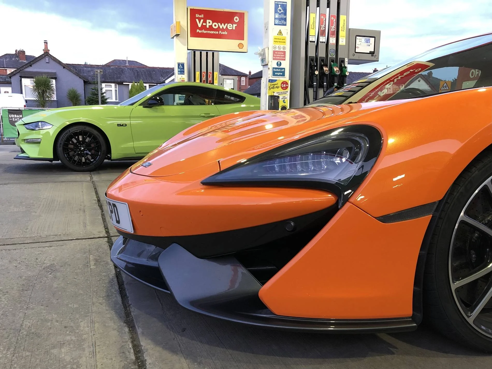

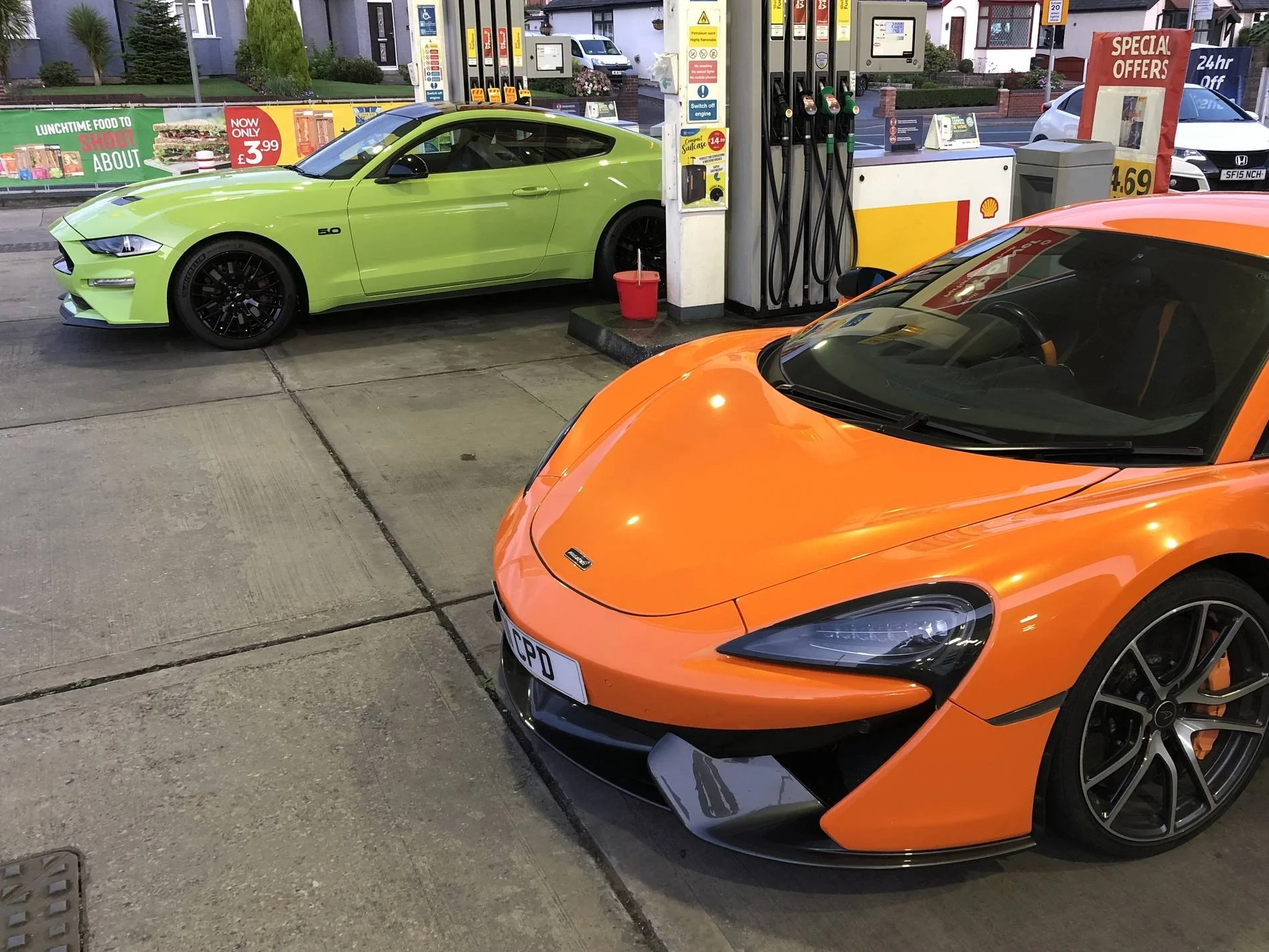

Spotted this when I filled up this week :
I asked its owner who had bought the silliest colour and he claimed it was him – he seemed like a nice guy but I wasn’t going to argue (picture a white Mike Tyson complete with facial tattoos).
