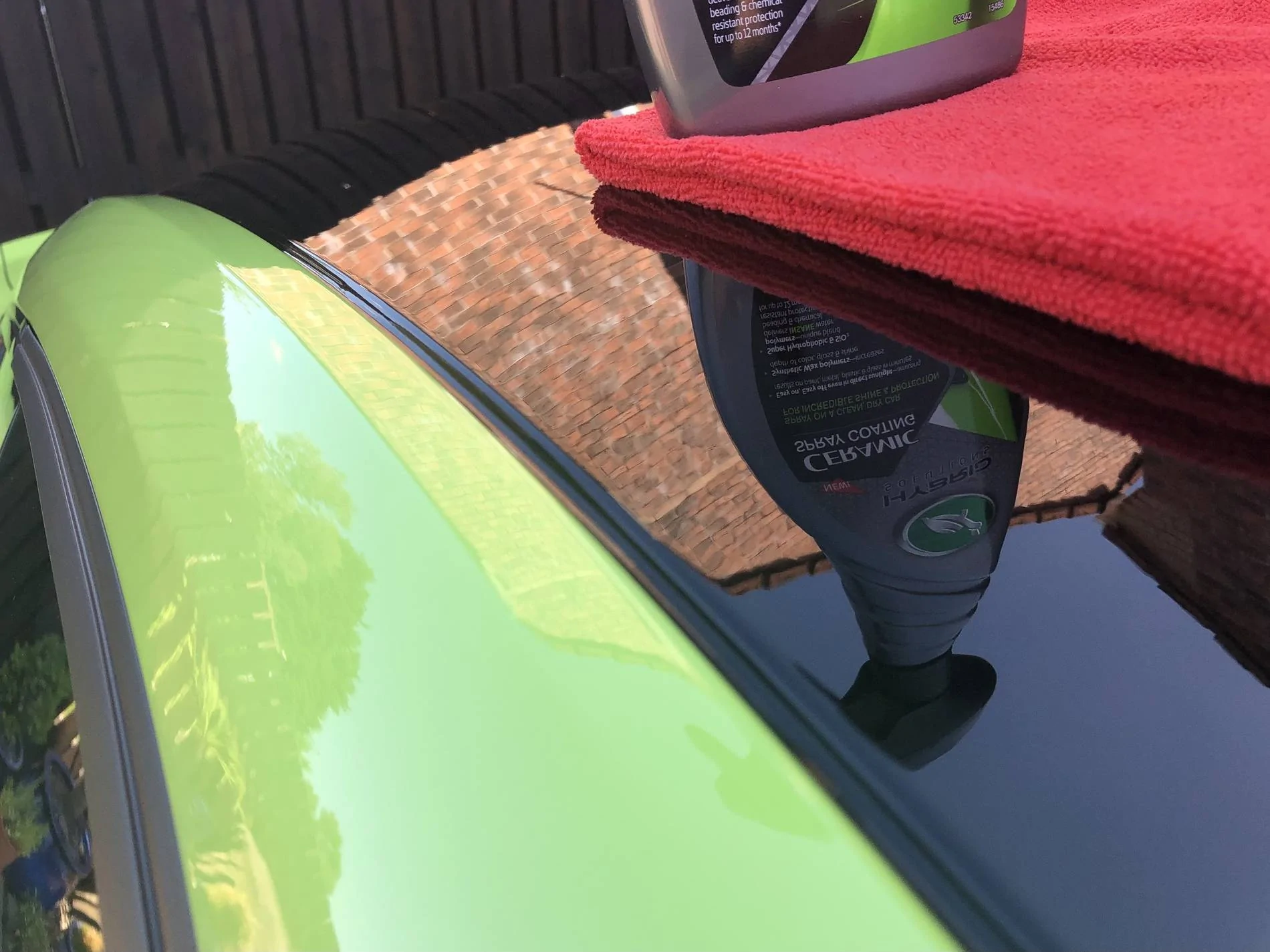

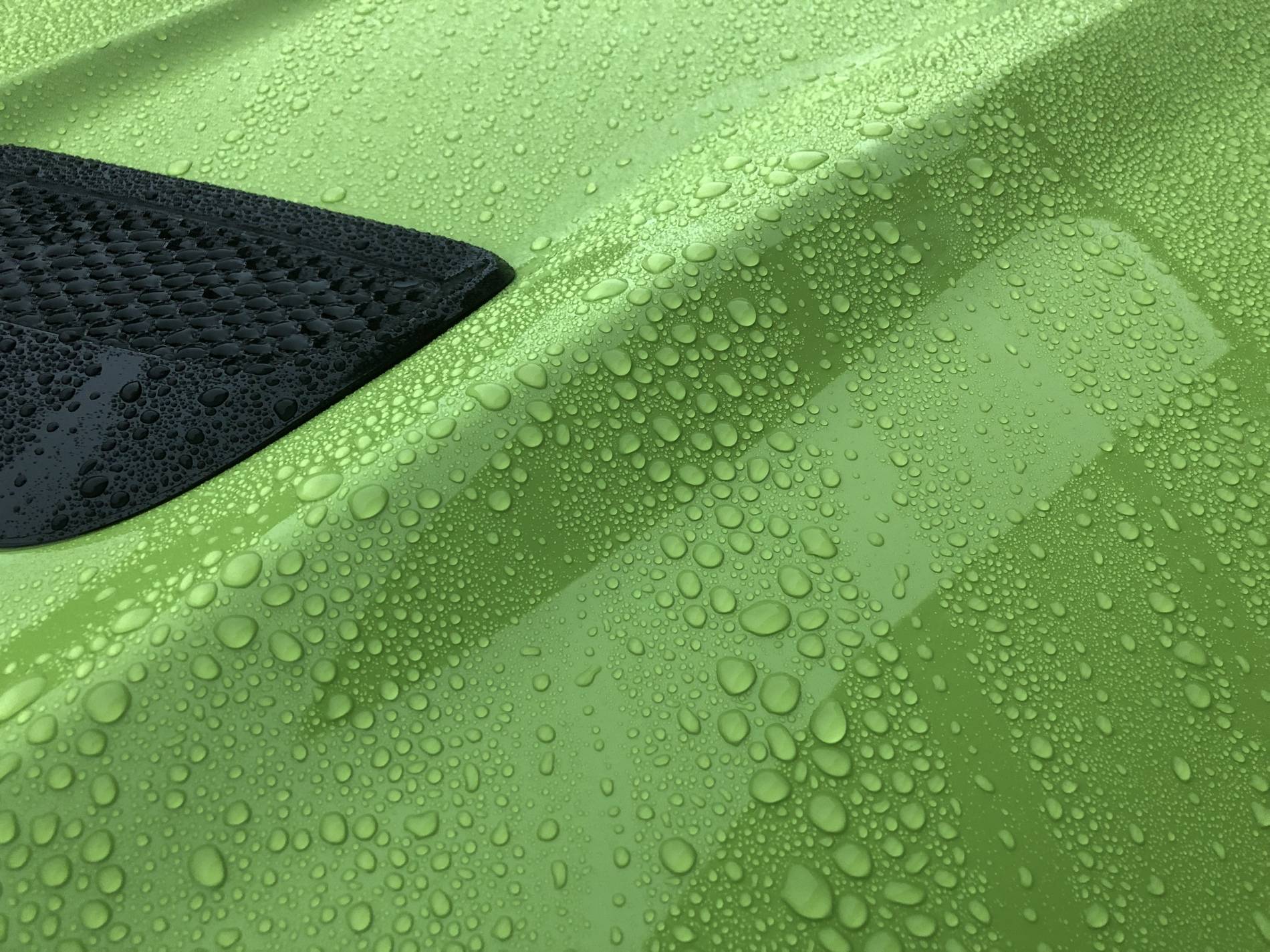

Quick update on the Turtle Wax ceramic :
I have got multiple layers on a few panels now and layering really seems to make a difference to the performance of it. Water behaviour seems very good :
It would be interesting to see if it lives up the longevity claims I see on the internet, but with how quick and easy it is to apply additional coats I’m not sure I will get the chance to test that, even over the winter period.
Whilst we are on paint, I mentioned on another thread how good wash technique and equipment was helping to preserve the factory finish (I pulled the factory wrap off the car and it has never had any polishing / paint correction). I posted this picture after turtle waxing the roof as direct reflections of the run straight into the camera lens highlight defects (swirls) rather than hide them :

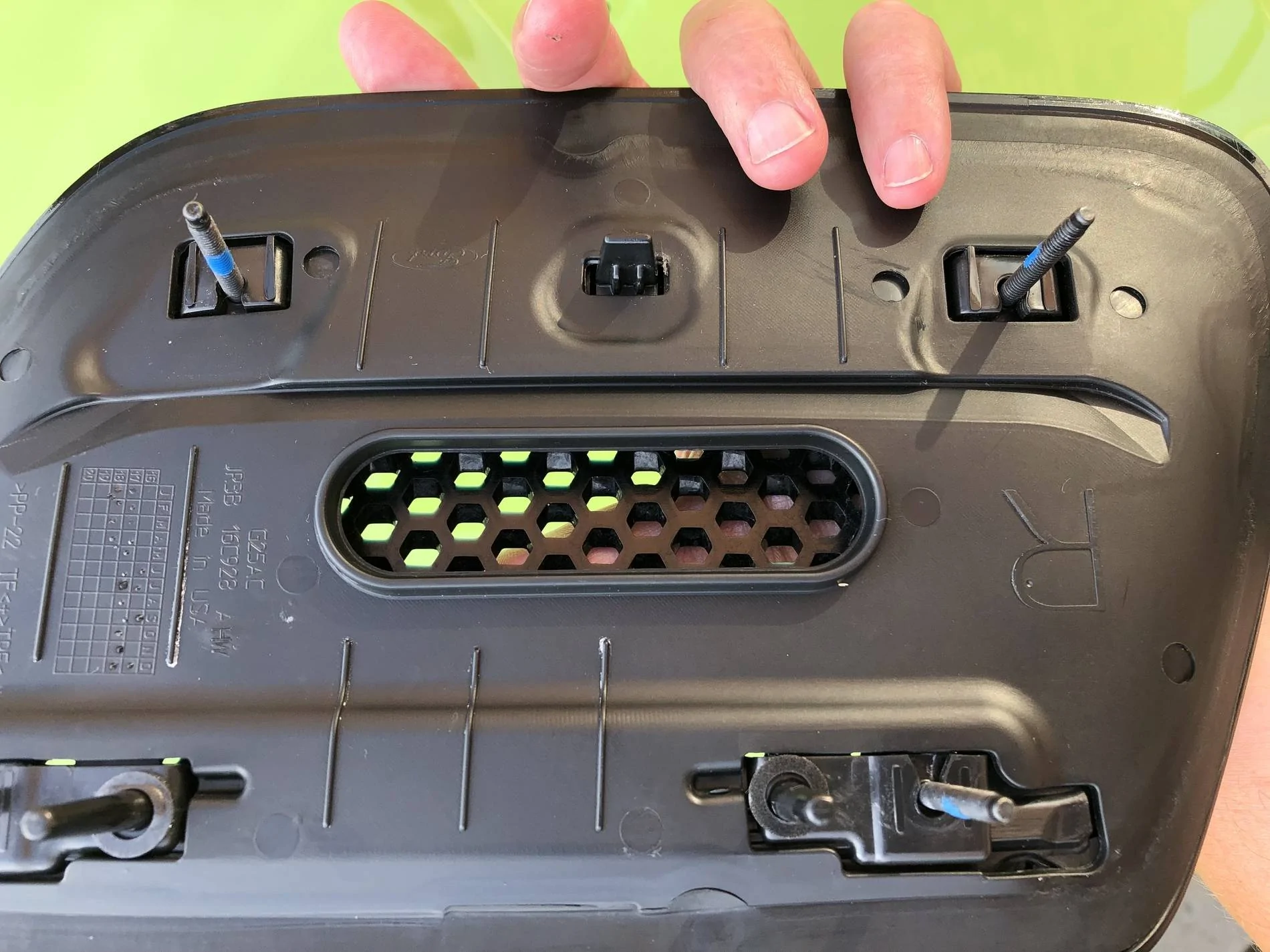

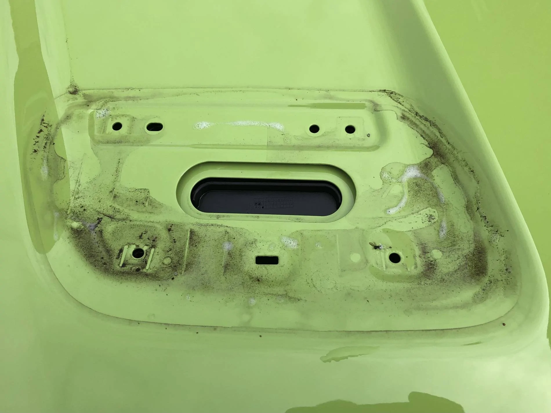

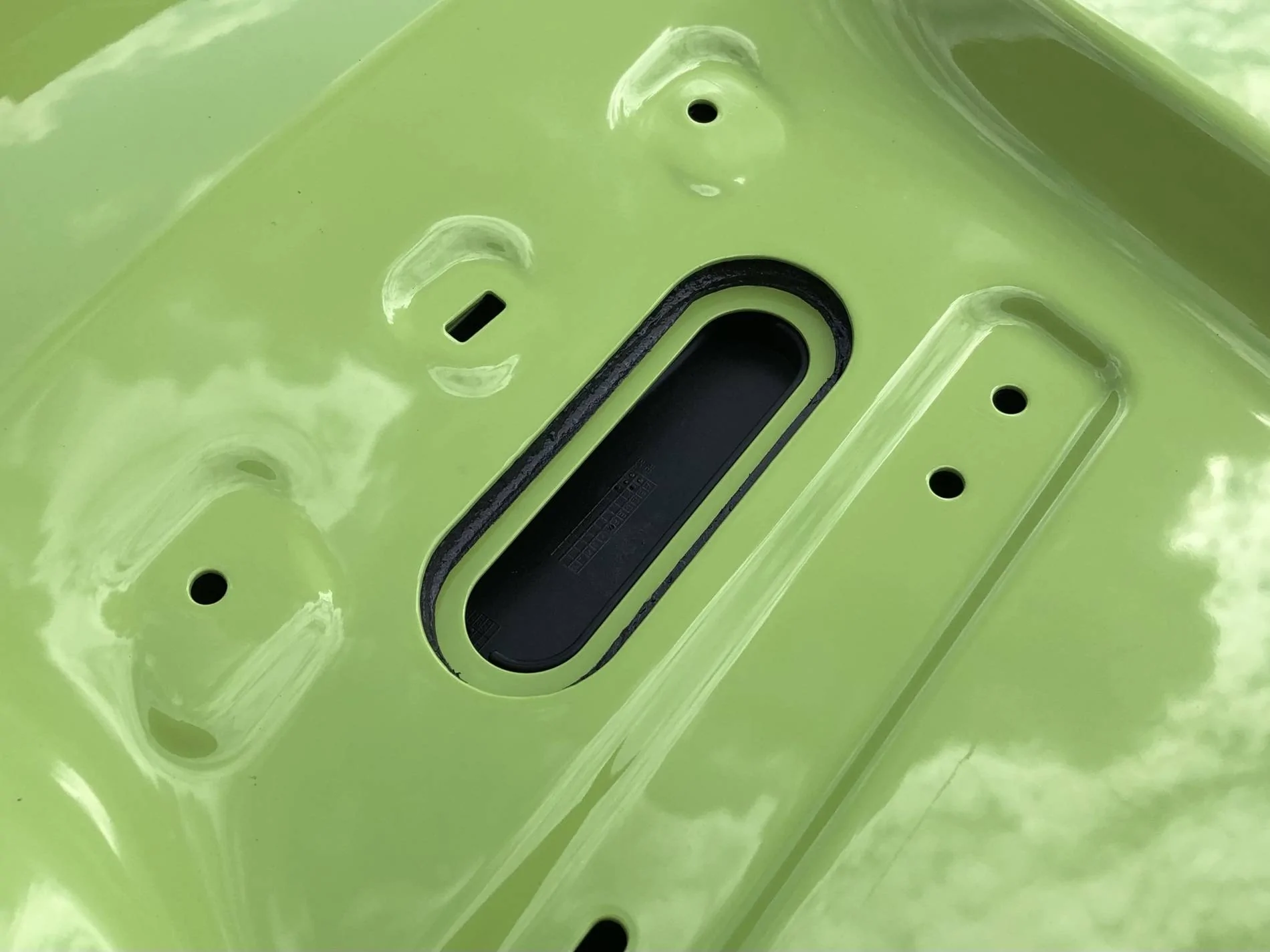

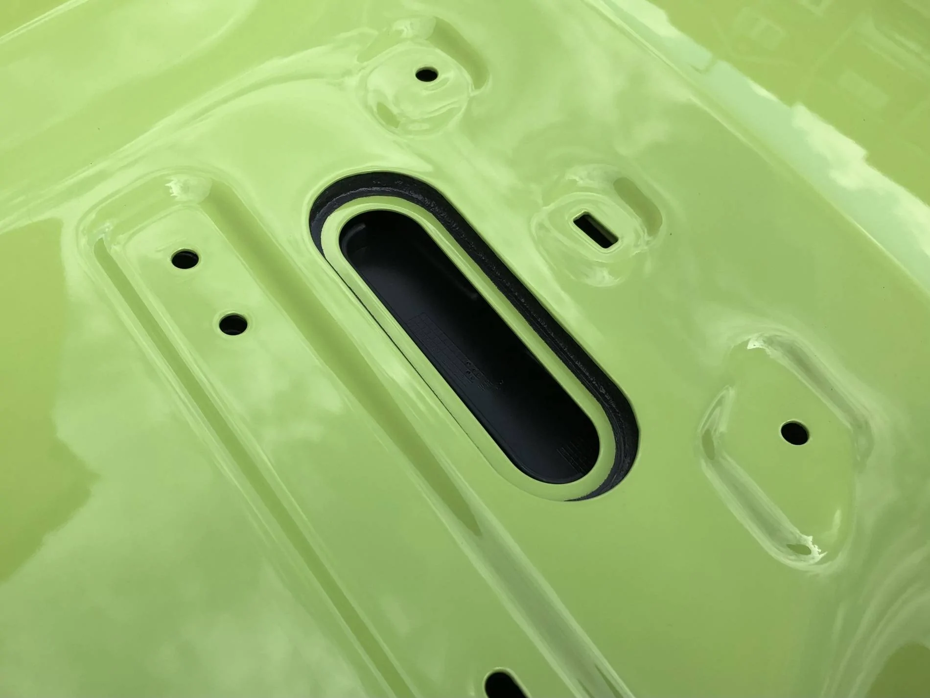

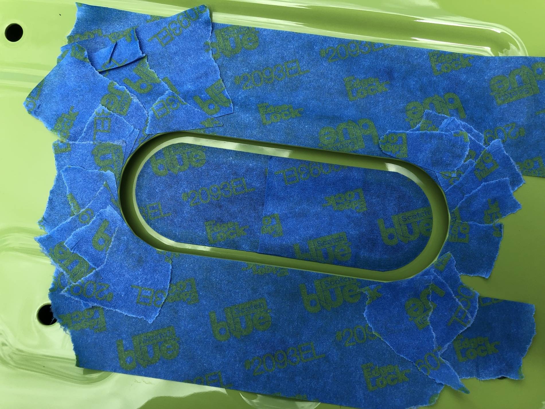

Moving back to the hood vents and a niggle I had with them letting water between the hood skins – you can see the upper and lower hood skins in this photo when the vents were out (and the amount of crap that can get under them) :

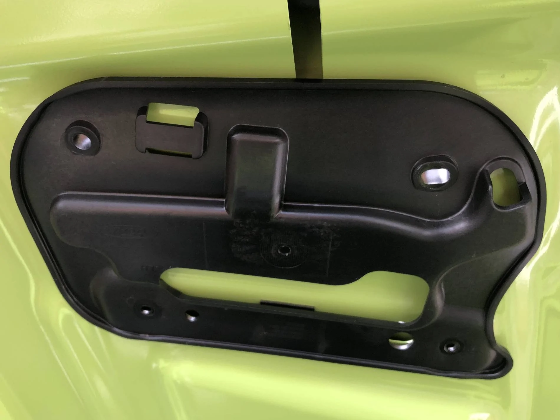

You can just see the underside rain tray in that photo that looks like this on the underside of the hood with the hood blanket removed :
This is the underside of the vent that ‘should’ channel the water down into the plastic rain tray :
That works fine for light rain, but if the vent is flooded (or in the event of washing the car / jet washing the vents etc) water backs up and then escapes between the hood skins, settling in the front edge over the headlights until it is either steamed off with engine heat or the hood is lifted moving the water to the back corners and out of the drain holes near the hinge :shock: :
That didn’t sit well with me … I considered some front edge drain holes but if / when the hood corrosion issues start I don’t think Ford would have taken to kindly to that modification … lol
I decided on this route :
And then some Unibond butyl sealant :
But after five days the Unibond stuff still hadn’t even skinned over, so I dug it all out and cleaned it up with ear cleaners and white spirit (what a pain in the arse :facepalm:) and then did it again with some 150°C black silicone.
All the edges and holes around the vents were covered in Lanoguard (Fluid Film in the states) along with the studs and mounting nuts. Vents back in – note the lower skin of the hood that you can see in lime :
Pre mod, any water that got on top of that lime piece entered the hood skin cavity and didn’t go through the vent to the rain tray.
Torrential rain over the weekend, followed by a wash where I purposely flooded the hood vents with a open ended running hose resulted in a good test :
Happy with that, the replacement hood blanket can now go on :like:

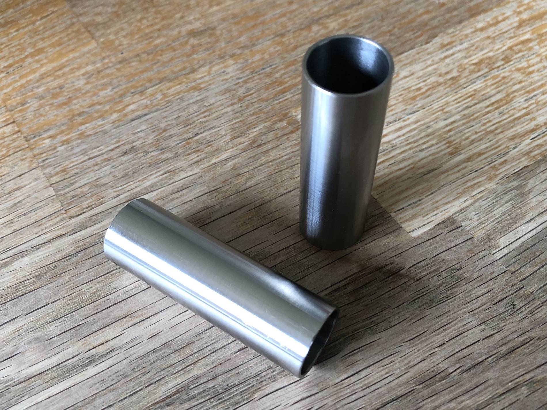

Got BMR style spacers made up in stainless to help the diff mountings out (Ford fitting M14 into M16 clearance …) :

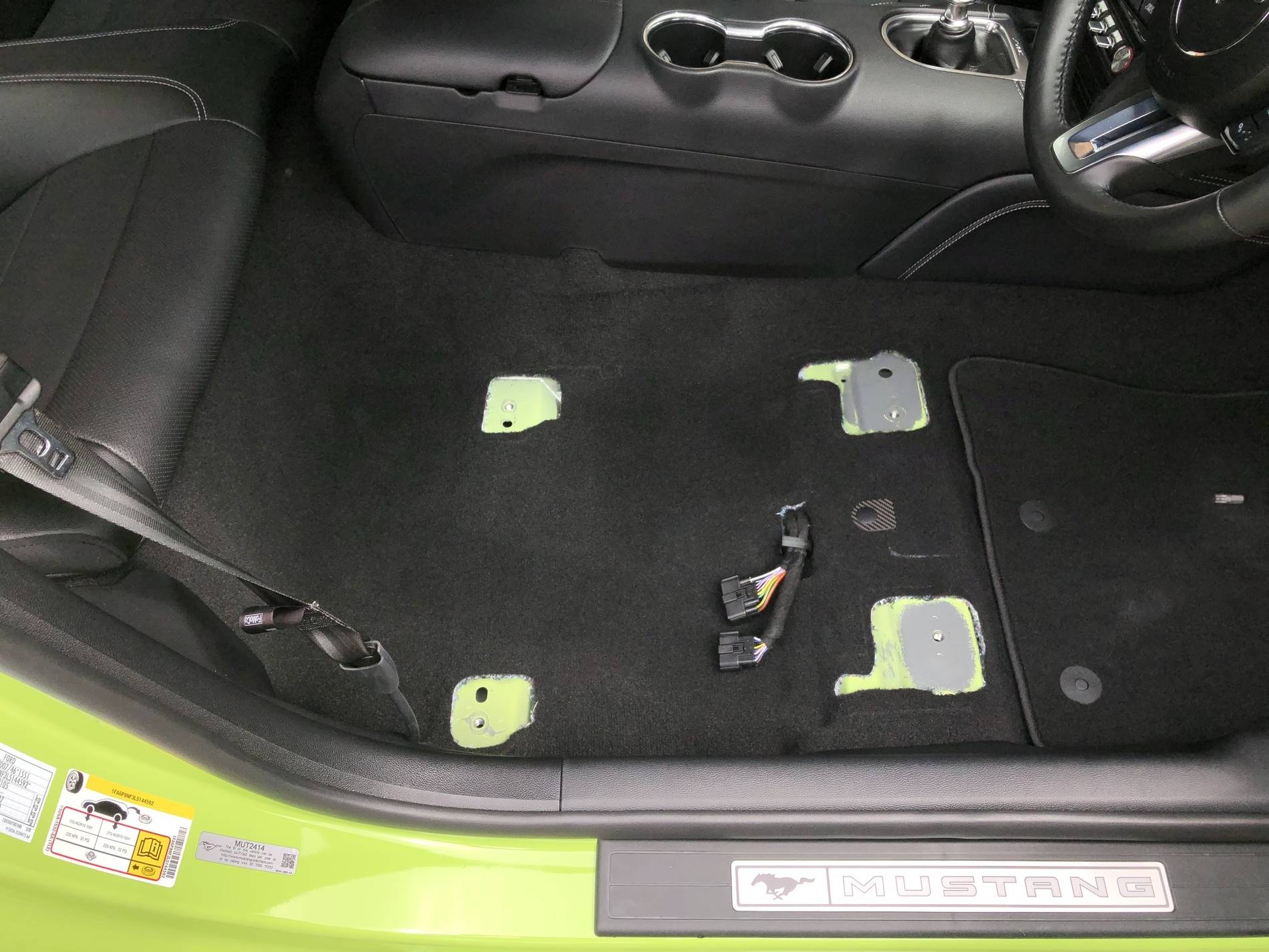

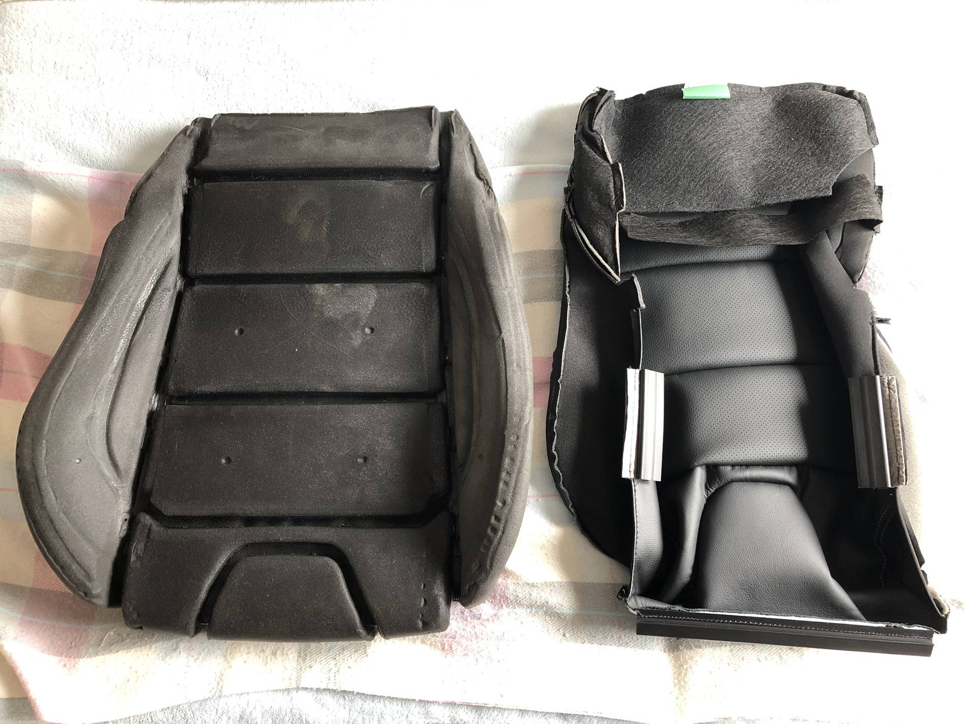

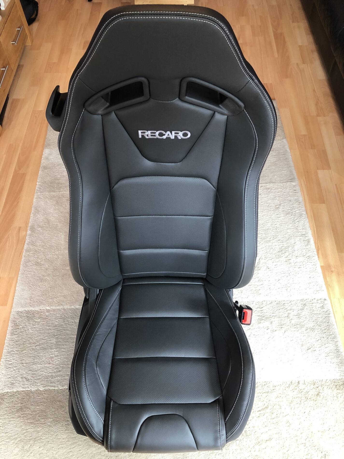

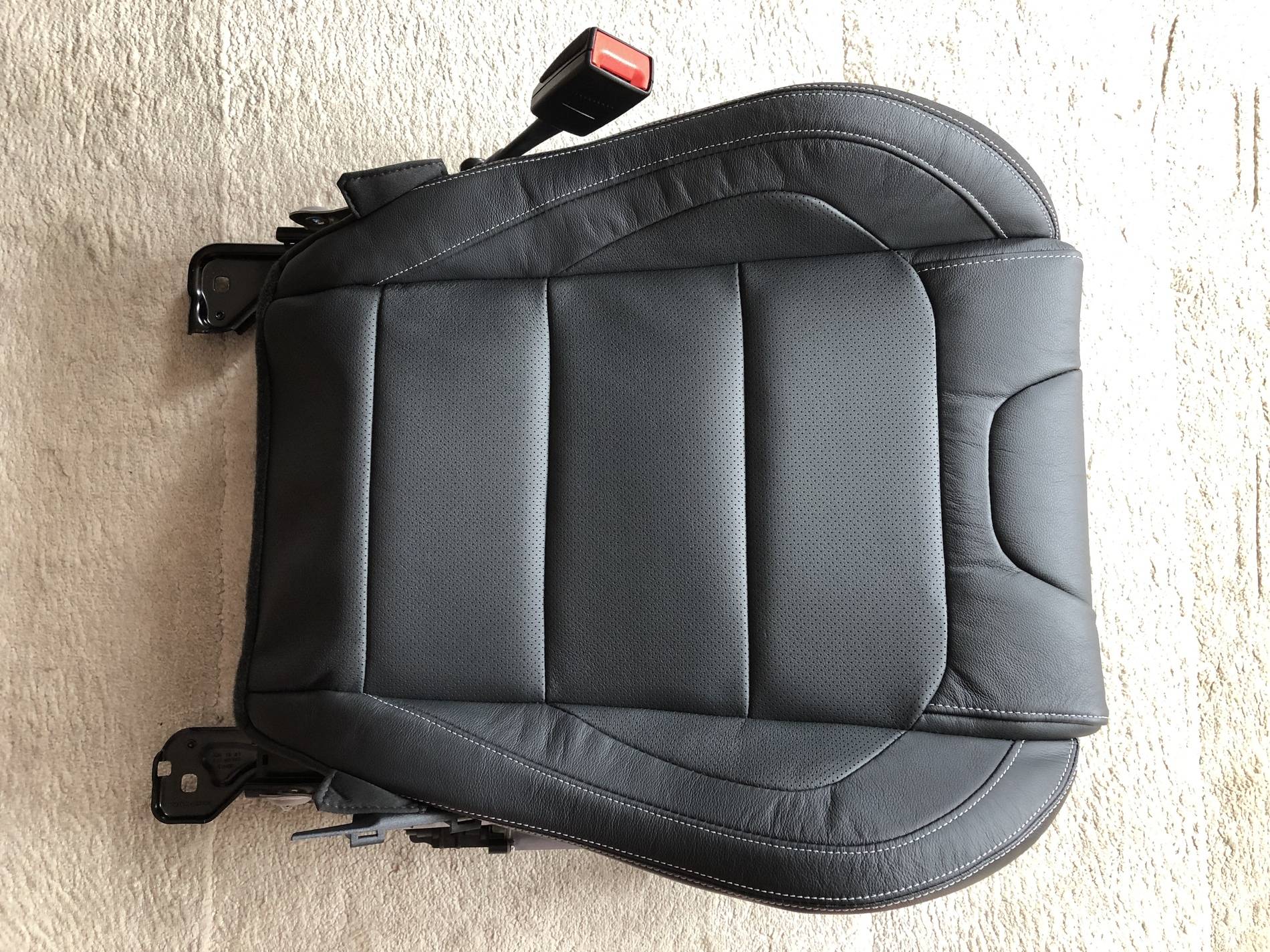

The last piece of the pre delivery warranty work / snagging list is now done :

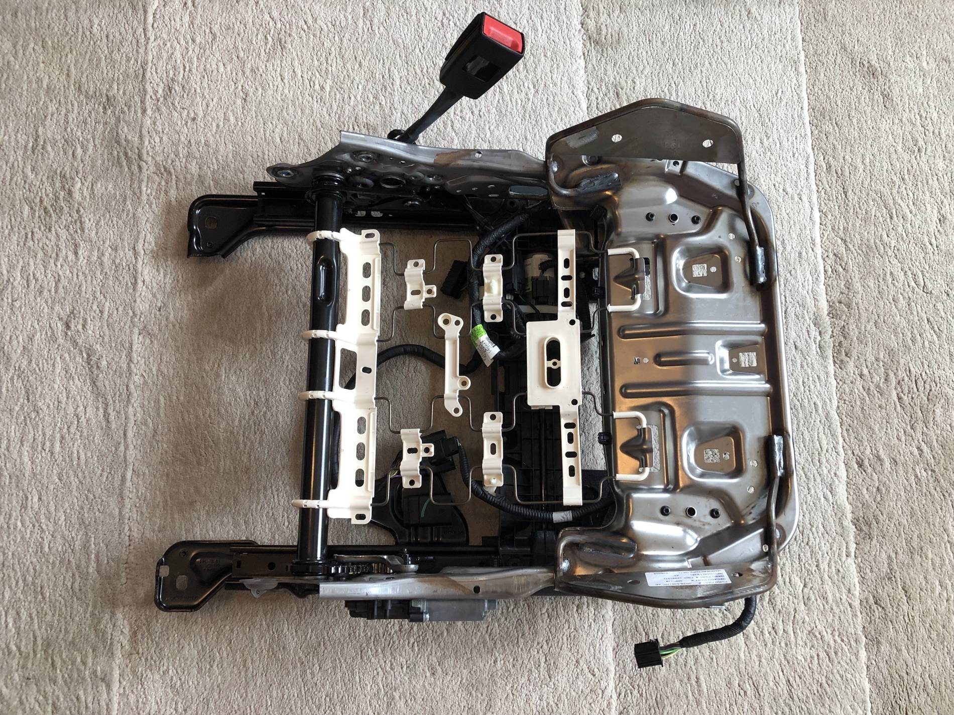

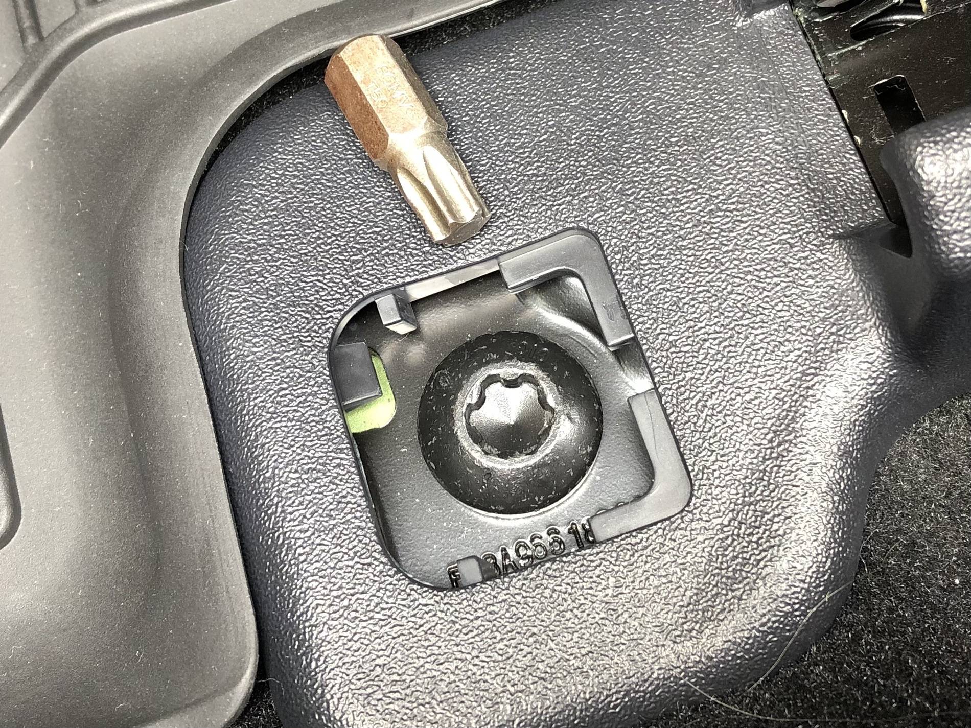

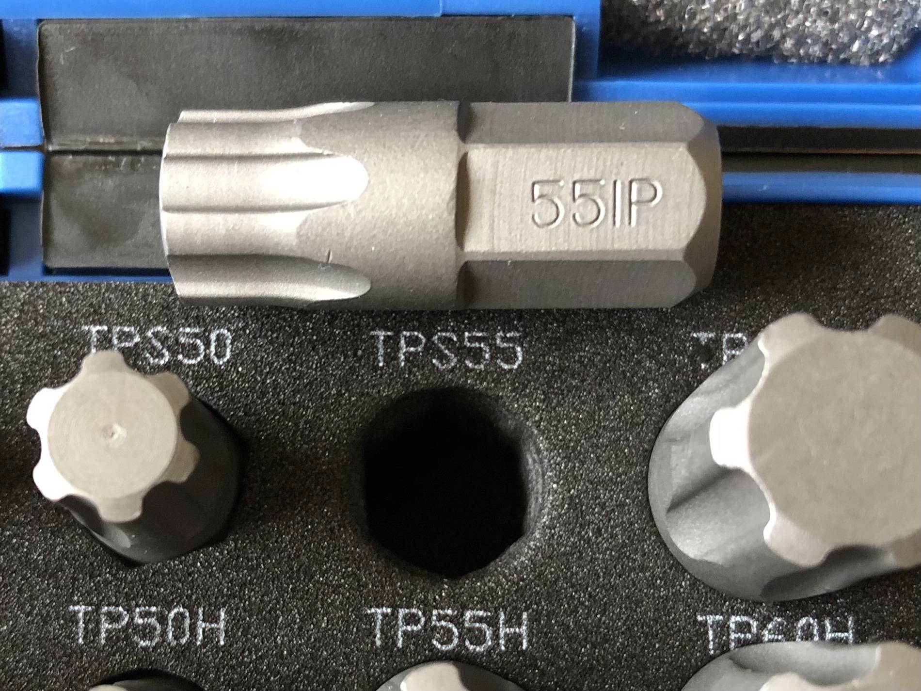

These are really heavy and awkward to manoeuvre out of the car, remember there’s no headrest to take off giving you extra room :
Online guides said I needed a T50 Torx to remove the seats, nope, not on my 2020 …
One new set of Torx Plus later, this is what’s really needed :
The other sizes that’s needed to strip the Recaro down are standard Torx T50, T25 and T20.
All back together now, torqued up and thread locked - hopefully also curing a seat squeak that had slowly been developing.

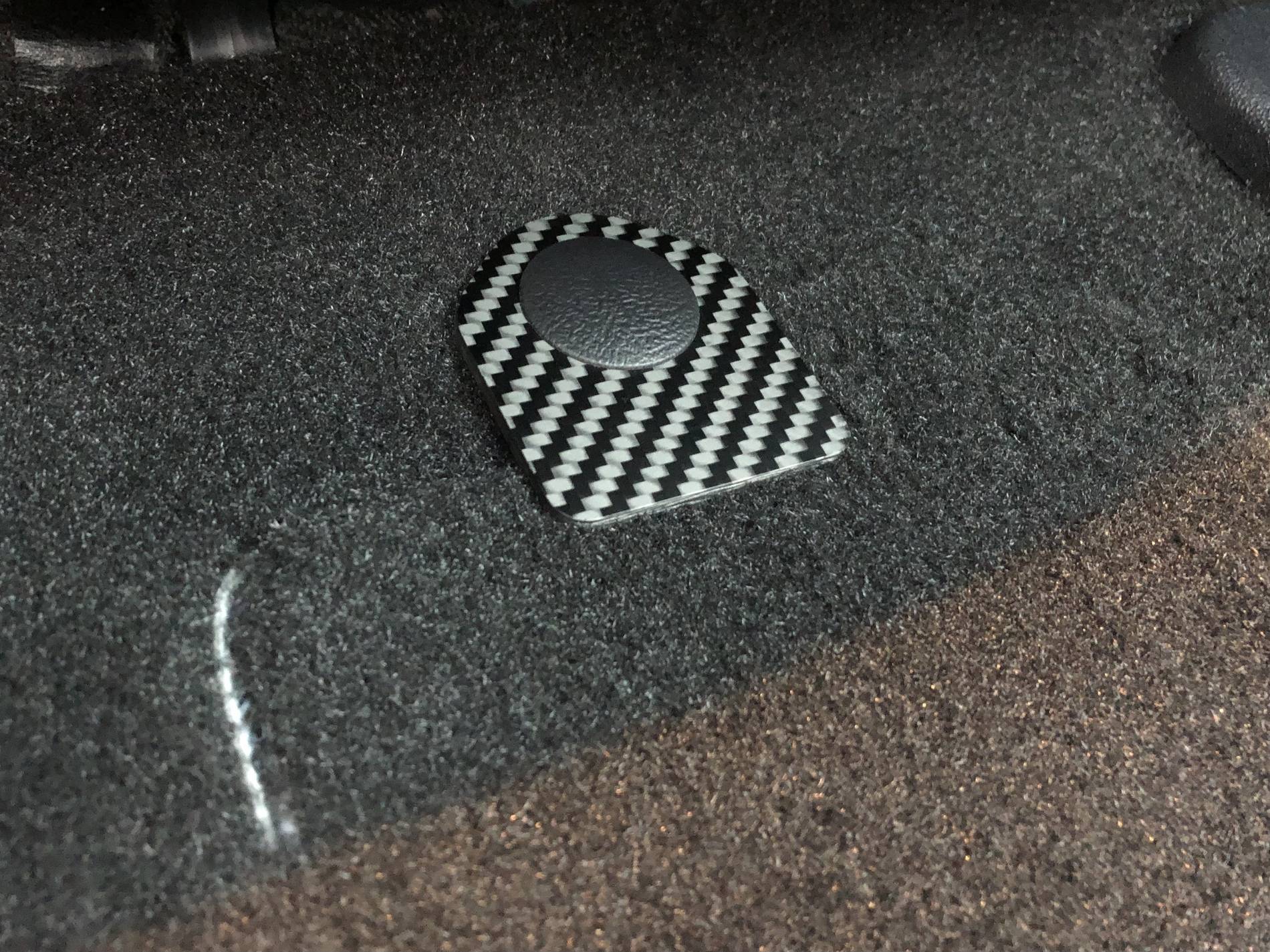

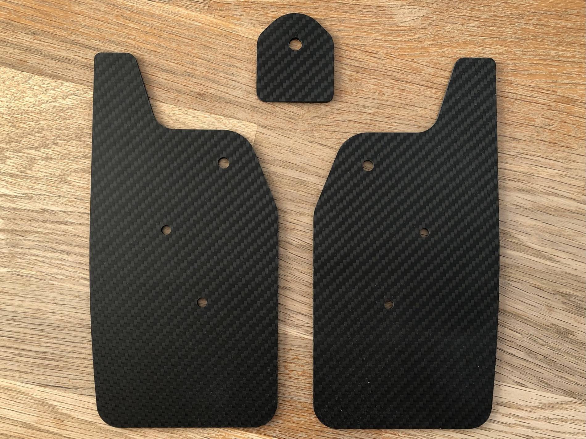

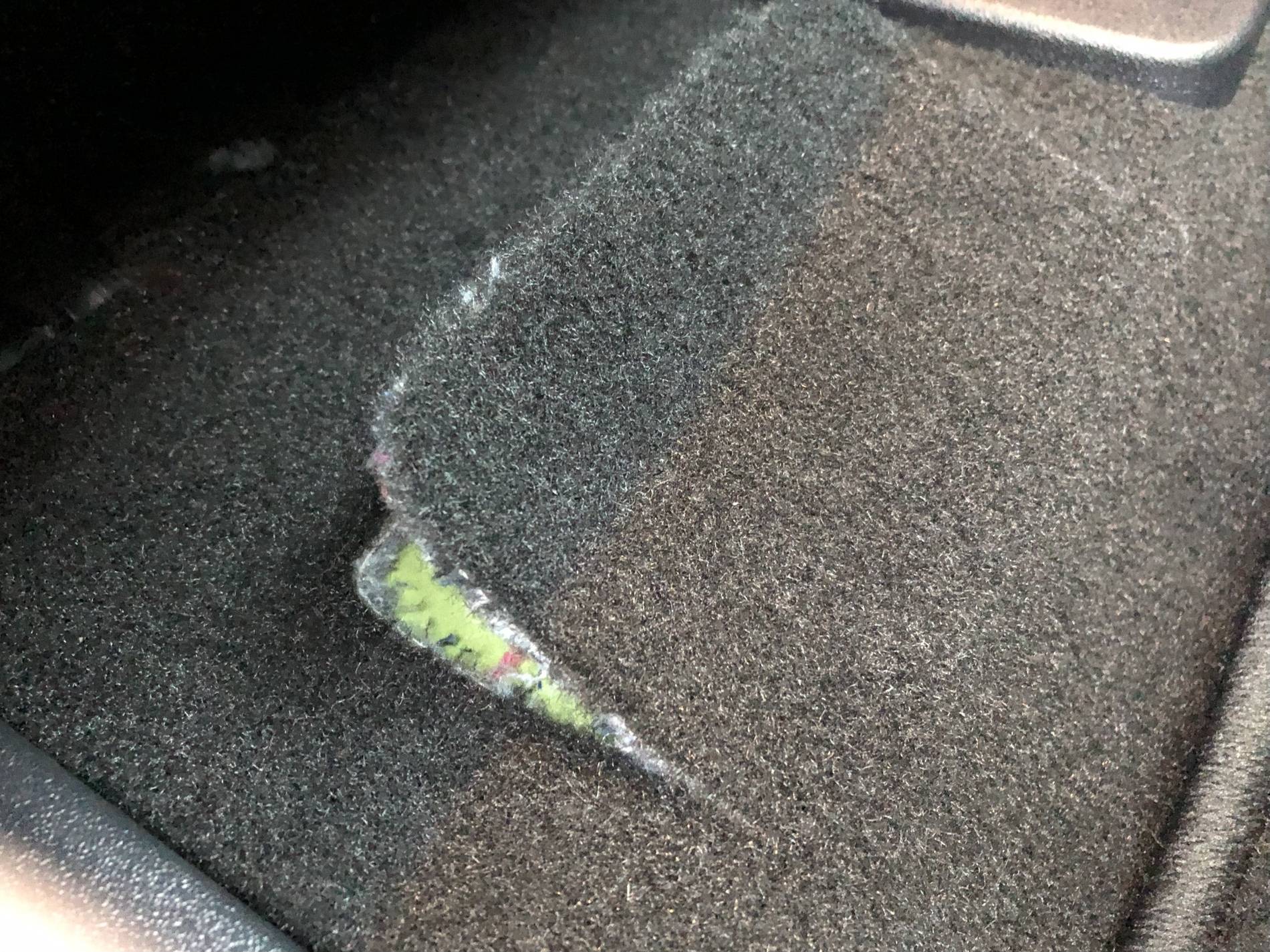

That shitty carpet flap that won’t stay down and gets pulled up every time I move the seat :
Is now sorted with a bit of carbon :
That sits under the existing push pin :
Calm is restored, I will sleep well tonight … :giggle:
