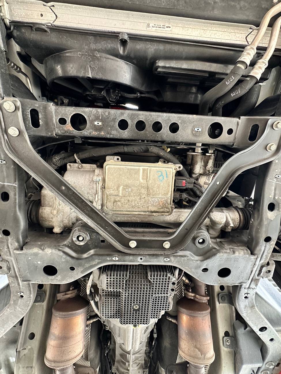

Belly pan off. Let’s see if I can get the k-member off today.
Side note- does anyone have a link or a part number for the rivets that are on the front splitter. Missing a couple and most a ground down.
You’re going for it…..
Let’s have some friendly forum wagers as to what you find.
I bet 10 grand in Monopoly money and a Get out of Jail Free card you find the bottom end in excellent condition.
