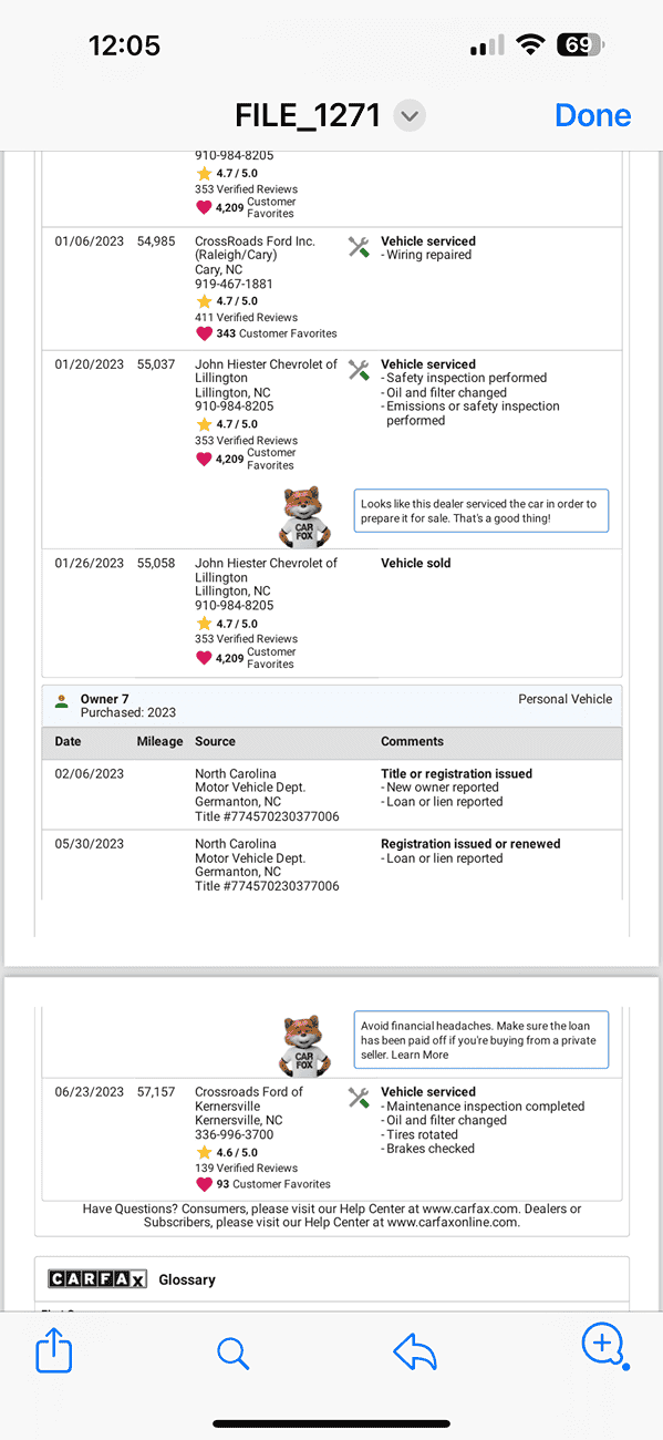

all I know is when I had the dealer do a pre purchase inspection and leak down test they asked if I wanted the oil changed because it had been a year but only 1000 miles is what they said.
wanting to use the AMSOIL I declined that service.

Yes the car fax back up the dealer tech story but 2000 miles ago

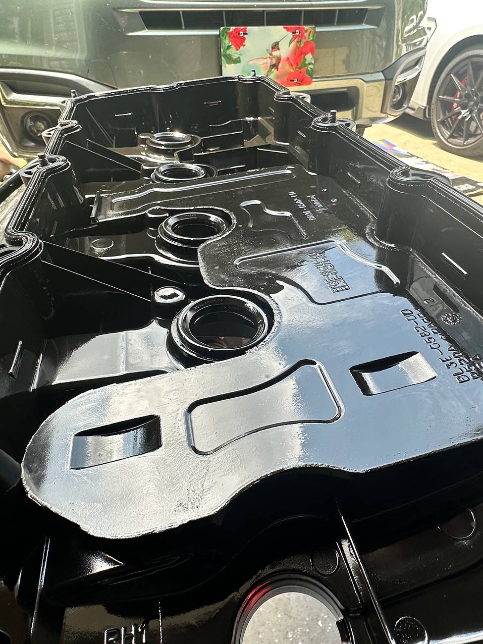

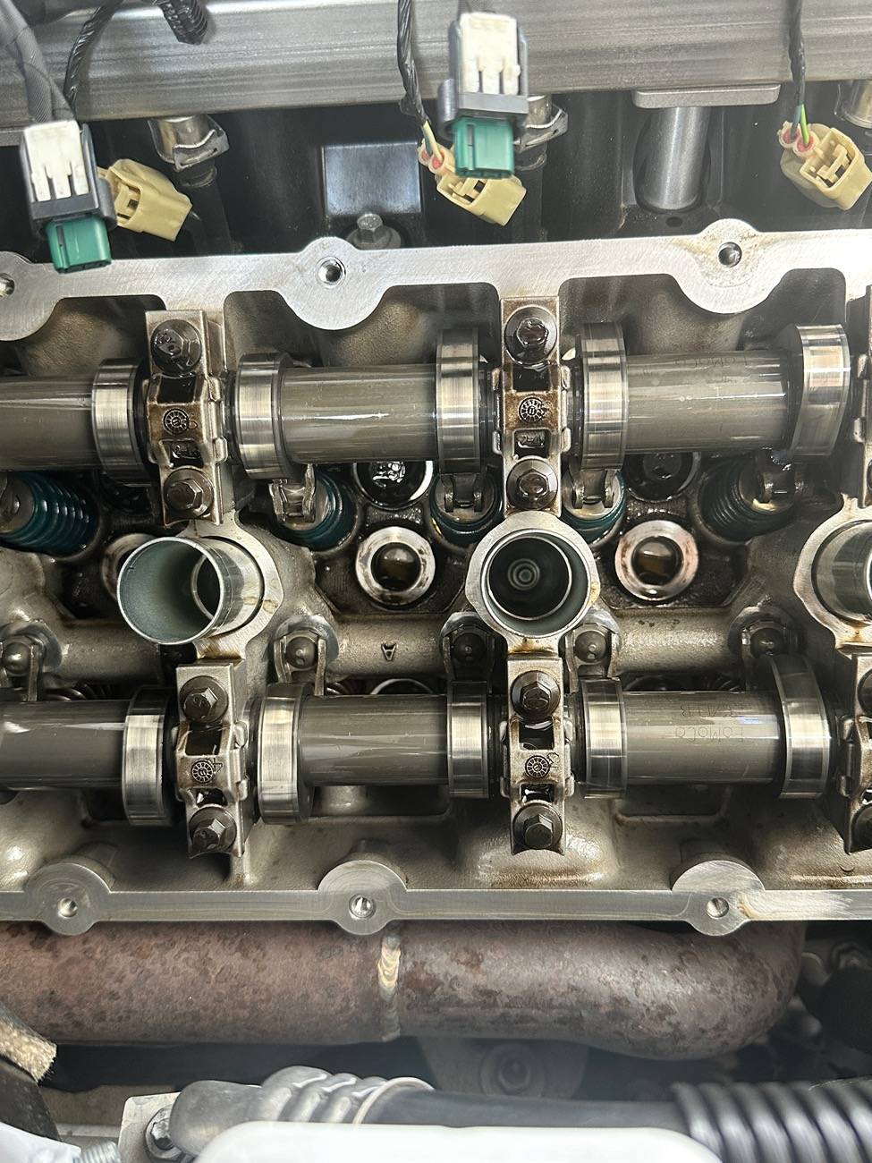

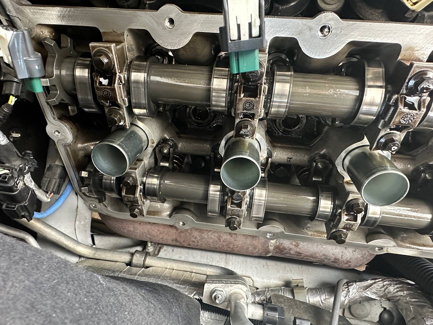

Passenger side

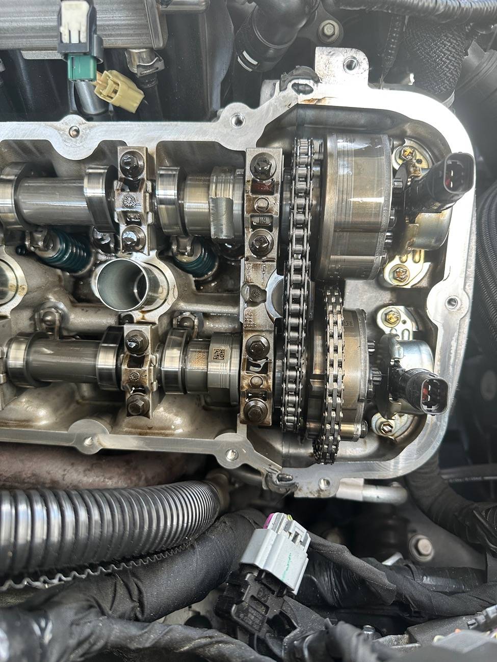

Well that all looks A OK from online pictures.
Just wondering if the UOA comes back with a good report is there merit in performing an oil flush with some less expensive oil before installing the Amsoil 5W-50 ?
I’m still not convinced the glitter is from a mechanical issue. I’m being optimistic here which is totally out of character for my Jaded ass ! LOL

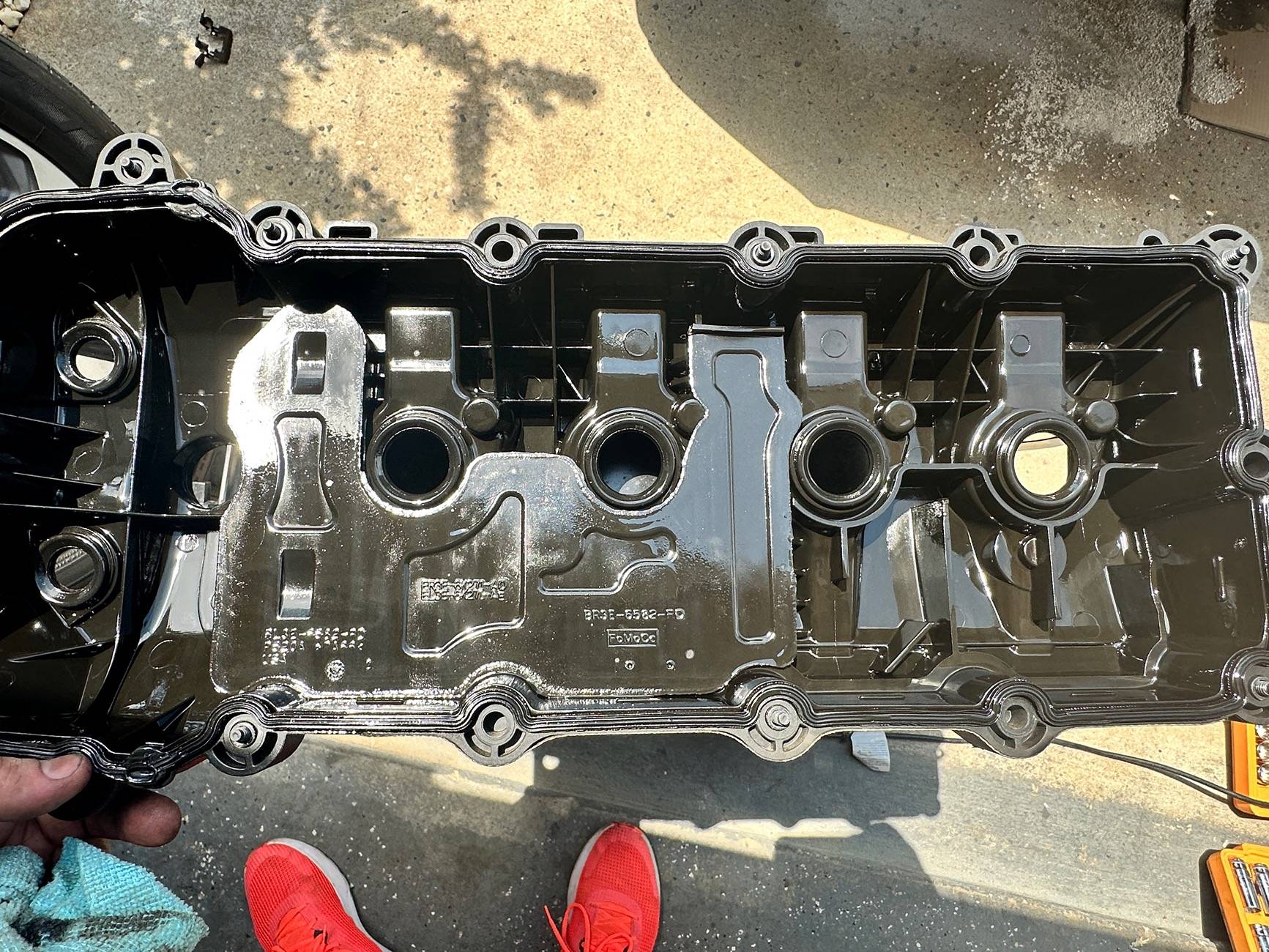

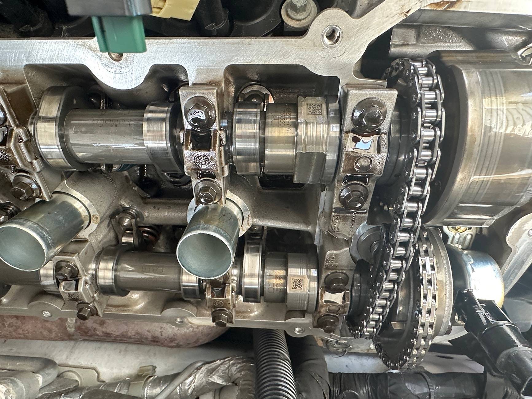

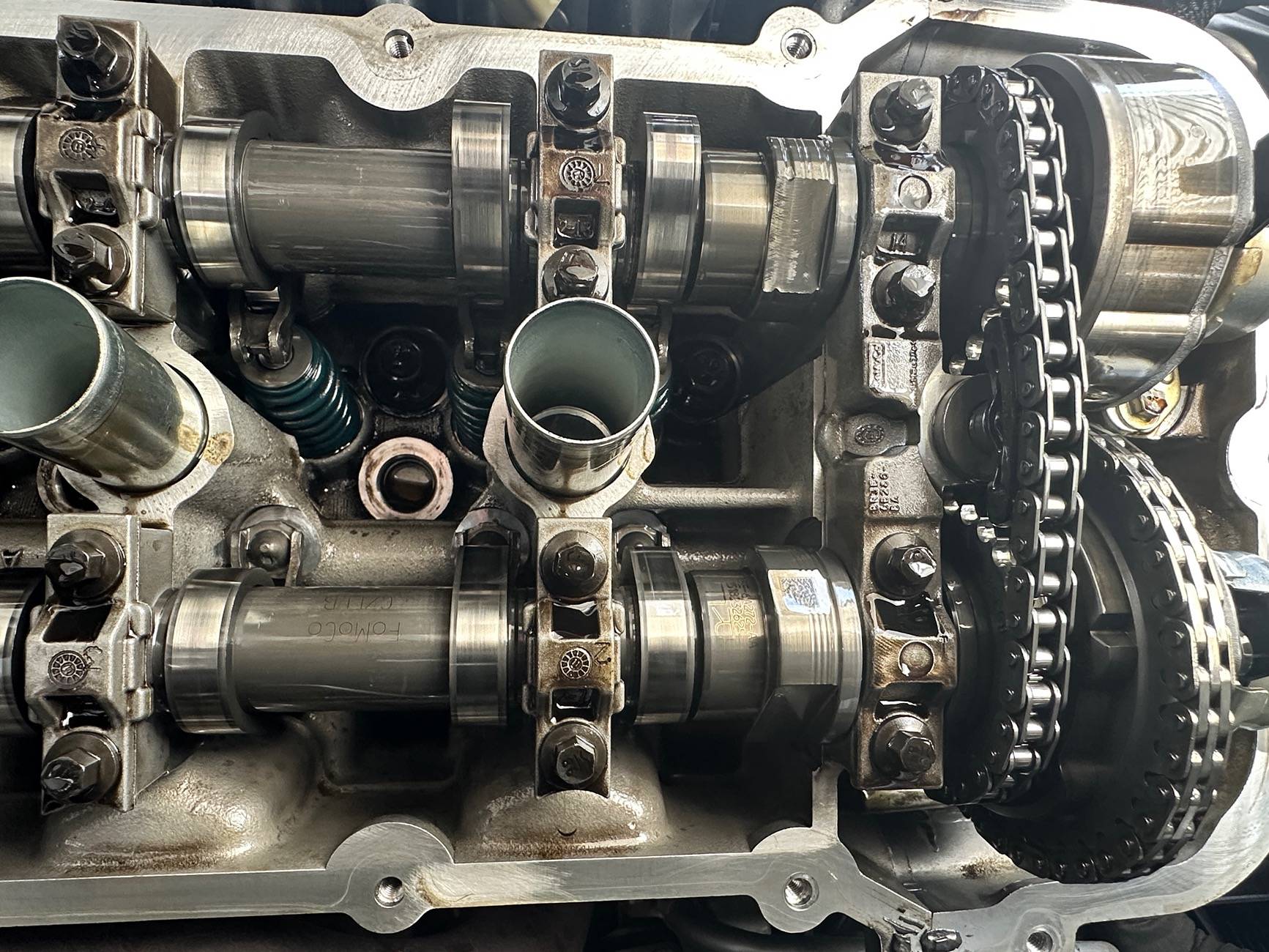

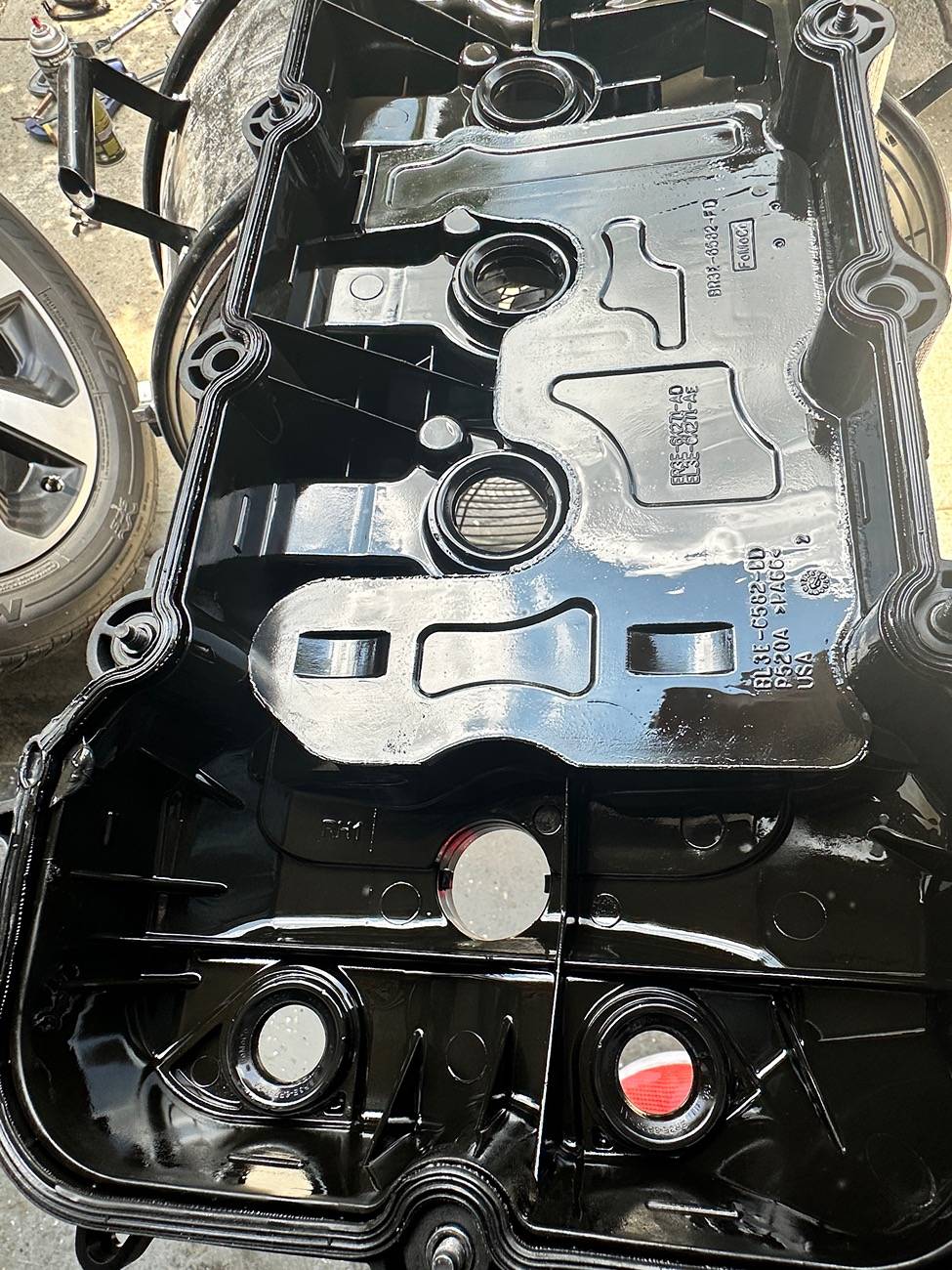

Okay, so you have a clean engine under the cam covers and a clean oil filter. It's beginning to look like you have a clean engine.
A couple of points. First, a used oil analysis won't tell you anything useful in this case. UOA measures the condition of the oil, not the condition of the engine. They're great to establish trends so any significant changes can be detected and assessed, but they can't tell you if your engine has a bad bearing.
As far as Voodoo reliability is concerned, the most reliable engine up until MY2019-2020 was the 2016. Ford changed the rings and a host of other parts in MY2017 and that's when the high oil consumption and other failures started. The 2016 engine you have is about as good as they get.
There's also a post on oil filter bypass systems. They're there to keep the filter from failing when the oil is cold. They open once in a while, but for the bulk of the time, they're closed and the oil goes through the filter. If the filter's clean, the oil's clean.
As for the sound the engine makes, @honeybadger's advice is good. I've listened to your videos a couple of times and there's a low frequency thumping sound, like a bass drum, and I don't know what that is. It could be exhaust or something else benign. It doesn't sound like a rod knock - there's no sharp knocking sound.
So, that's what I see as the state of play. Pick up some of those lovely GT500 valve covers, slap them on and run the thing for a bit to see what happens in the oil. If you put a few hours on it and the oil comes out clean, or at least cleaner than what you took out before, then you've got a good engine.

Passenger side
You could go pickup some new bolts and pull off one of the 2nd cam caps (not the big connected one but one of the individual ones right after).
Check it for scoring. If it has scoring then the metal got up into your cylinder head and damaged your cam caps. Keep in mind with that much metal your timing chain tensioners can fail.
