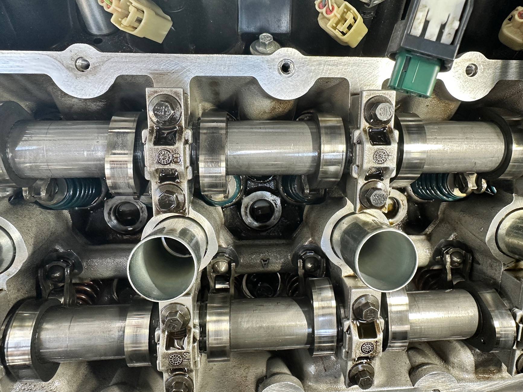

Yeah - I'd pull the valve covers and take a look at the cams and maybe pop some caps to see what it looks like. Also second changing the oil and running it for say 15-20 miles and checking it again. It could something weird like the previous owner changed lines or added something was contaminated and it sent some flakes into the engine. If it's something that is wearing, the flakes will show up again.

I second this approach. There's something strange about this and the "clean" oil filter indicates that whatever the crud is, it wasn't circulating in the engine before you drained it. That doesn't mean there isn't a problem, but troubleshoot it methodically so you don't cause a new problem when you're looking for whatever this is.

I found a bad cam journal once by useing the long screwdriver method. put one end of a long screwdriver on diffrent parts of the engine and put the handle on your ear like a stethoscope until you hear the rattle/ squeak. it can help you pin point down the sound. you can pull valve covers and look. idk how hard it is to pull the pan and check for a wiggly rod or discoloration but that would be my second step.

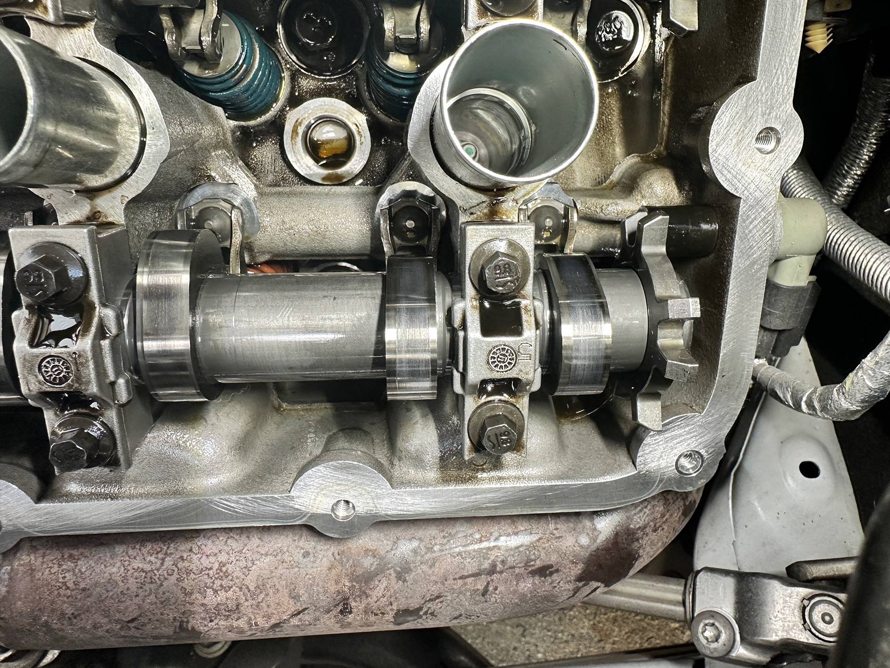

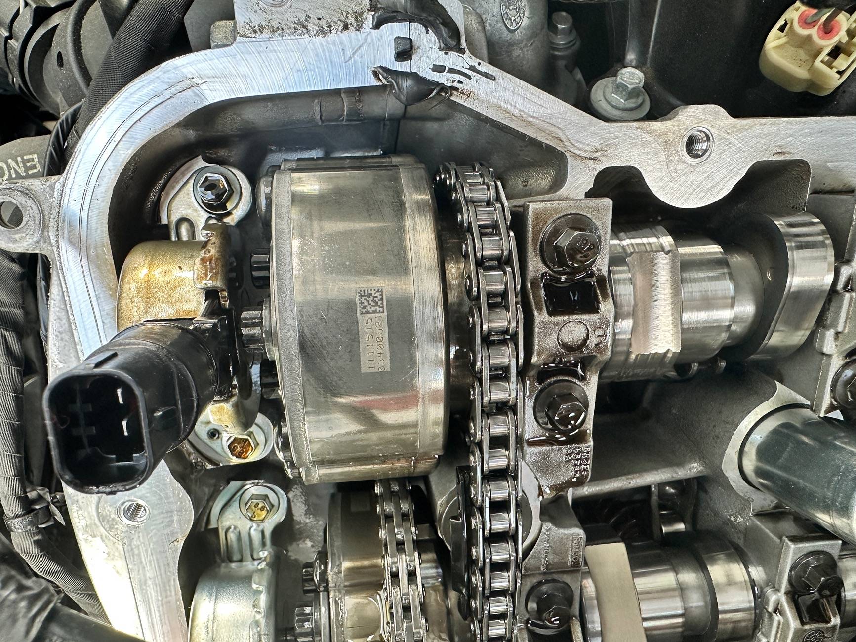

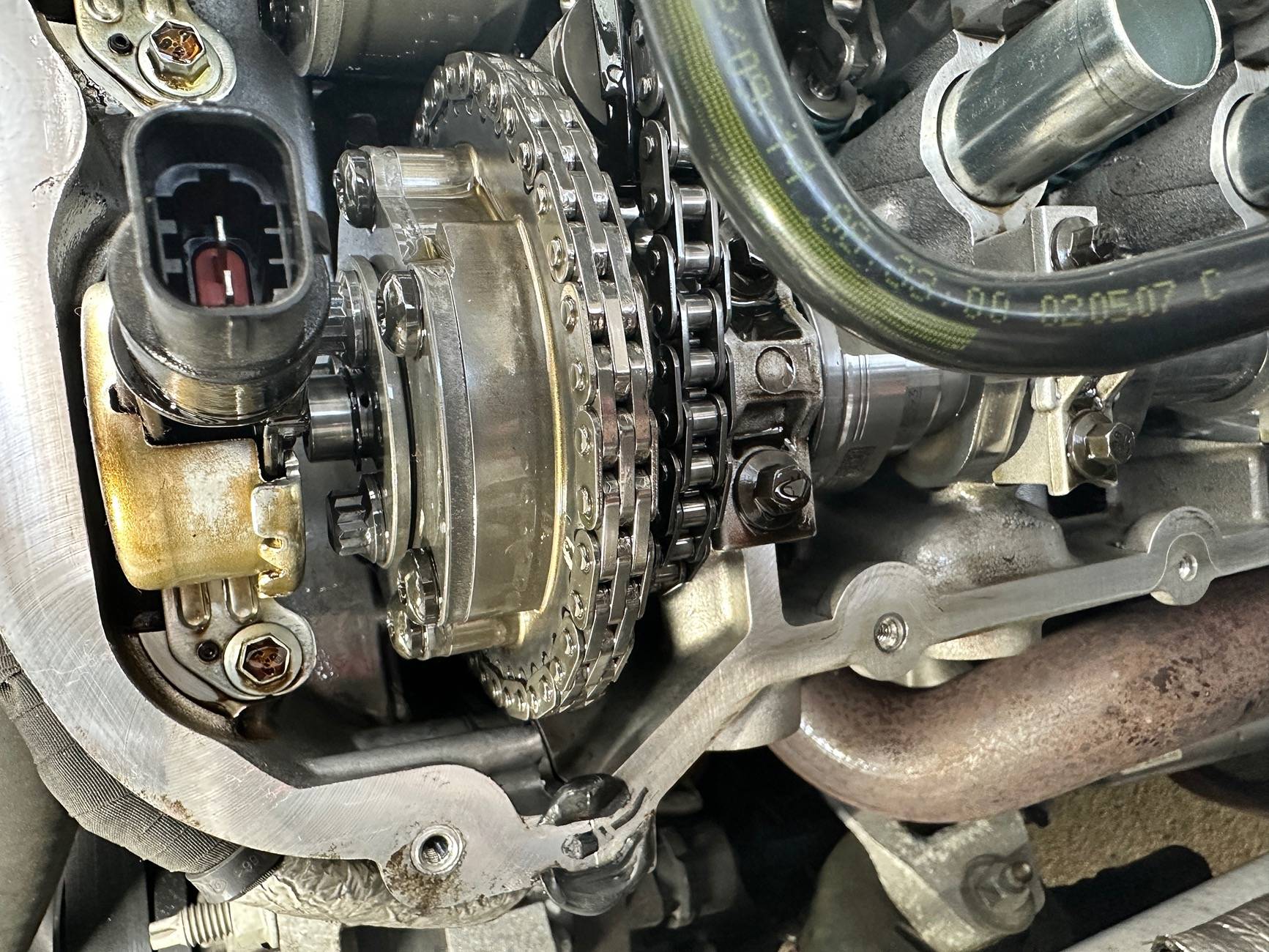

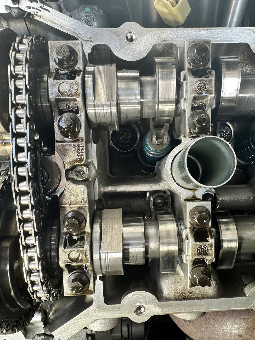

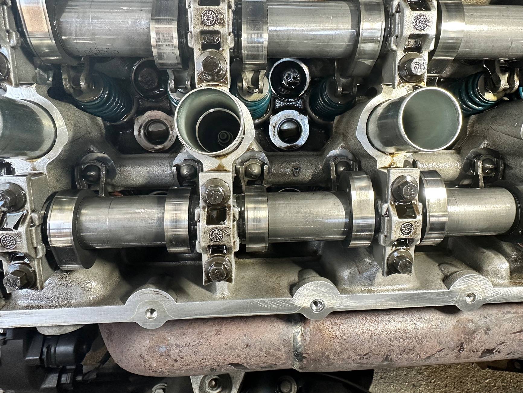

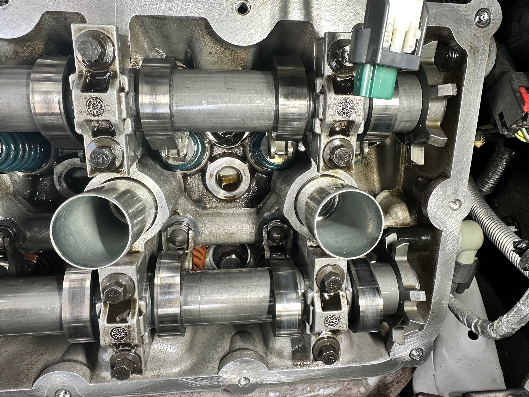

This is surprisingly reassuring, thoughts??
well for the top end at least….before I jump the gun.
