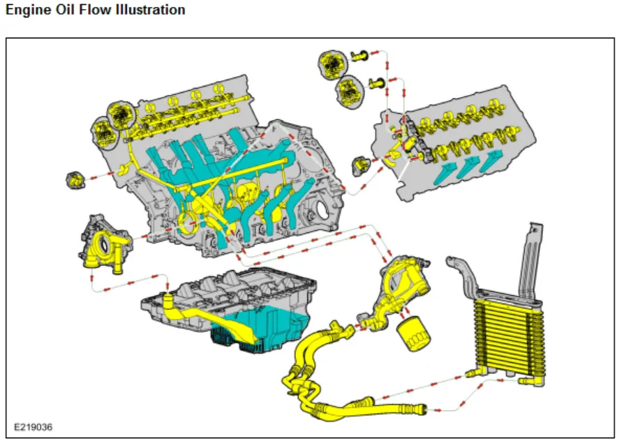

Should I be concerned about not being able to pull the connecting rod cap? Depending on what I find with the main bearings?
I guess if the main bearings look okay then odds are the connecting rods are good too?
TeamGomez
Apr 2, 2022
185
332
San Diego
www.centripetalsolutions.com
John
'18 350, 996 GT-3, E46 M3, SQ5, Tundra
Preface my $.02 with absolutely zero understanding of the oiling properties in the 5.2. It can depend on feed (which bearing gets the first hit of lube). I'd imagine the rod bearings get the most abuse due to their torque generation upon combustion and would be first to wear with contamination.
But given the absolute zero stock on rod bolts, I'd be inclined to check the mains first then decide on path forward after you verify condition. It'd be a shame to have your ride unnecessarily tagged out awaiting parts.
Hope there's a 5.2 Yoda around these parts who can verify oil feed (i.e. which bearing dies first) to help get your steed cleared for 8,250 RPM sooner rather than later.
Mike Pfeifer
Feb 4, 2021
1,555
1,910
Wesley Chapel, FL
2019 Ruby Red Mustang GT A10
According to that diagram, looks like main 1 gets it first
