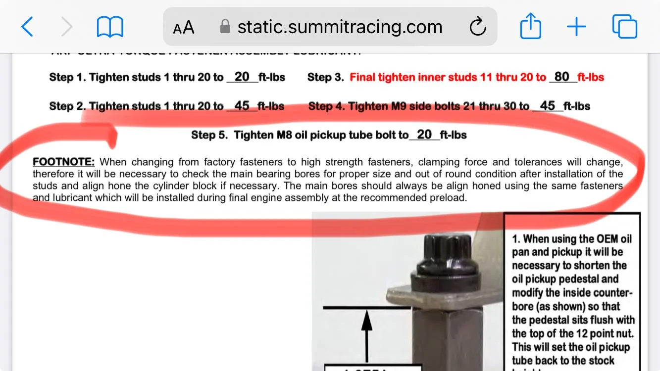

yes, I didn't open the box yet.
Hopefully that cut sheet is in the box.
Did you read the "Footnote" ?
I’d give consideration to OEM TTY fasteners or wait for UOA results.
Just saying.

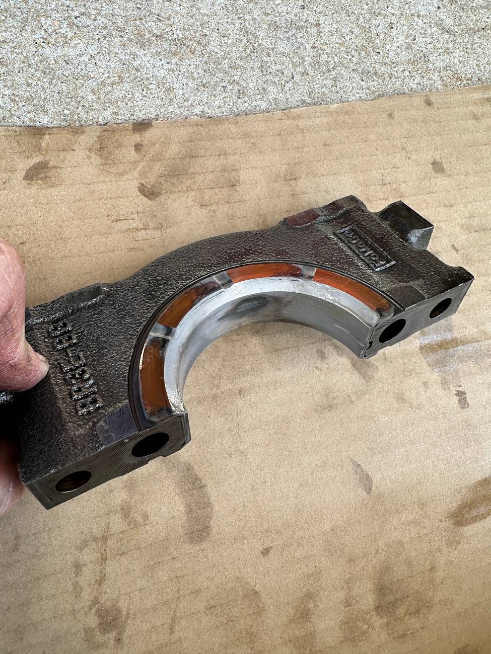

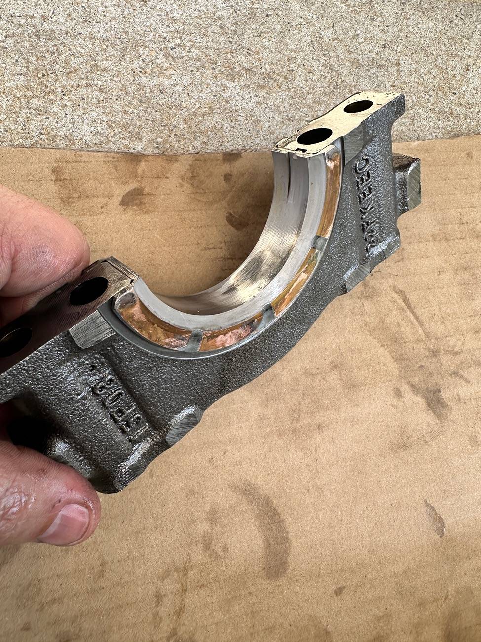

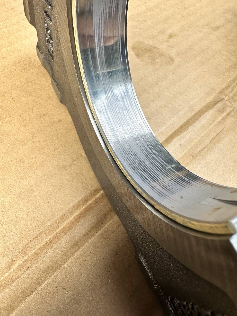

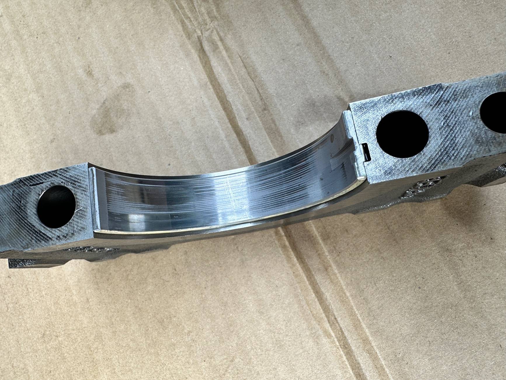

Torque sheet is in the box. Main cap #1 is off. What do we think? Crank looks great. Bearing looked ok I guess. Zero grooves. No discoloration either.
Thoughts?
Thoughts?
And quick glance looks more than acceptable to me.

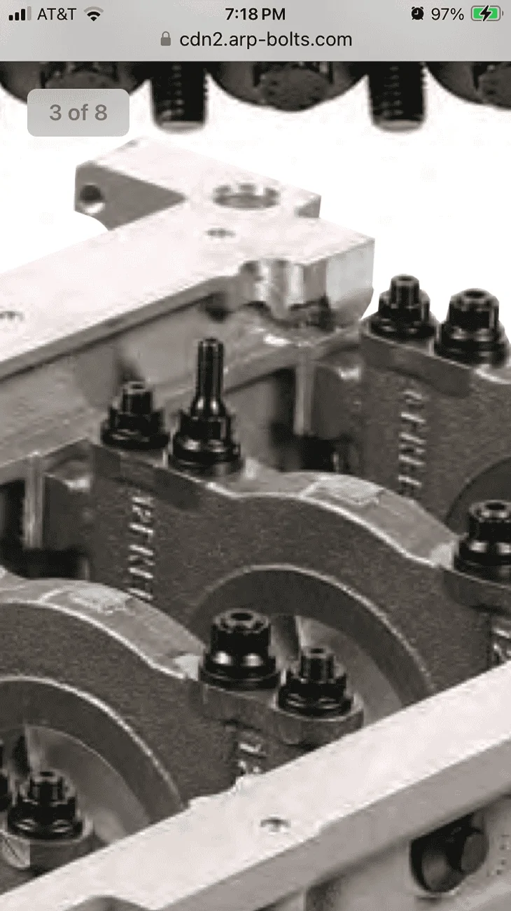

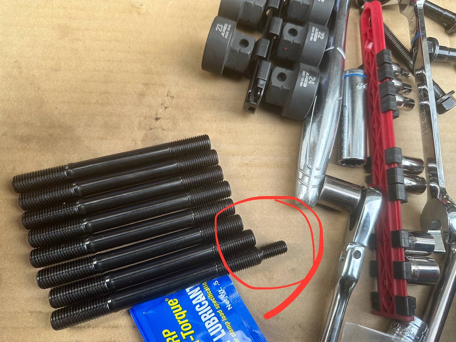

Yo where does this taller stud go. All the factory ones are the same length bolt
Thoughts?
For 60k miles, thats more than acceptable. Looks good.

Did you read over the ARP Footnote in the instructions ?
Yes I did and I have them right here. Am I missing it? I’m looking for something like “hey dumb dumb the special stud is #X in the torque sequence”
Footnote;
The ARP extra clamping force and the main journal dimension changing.

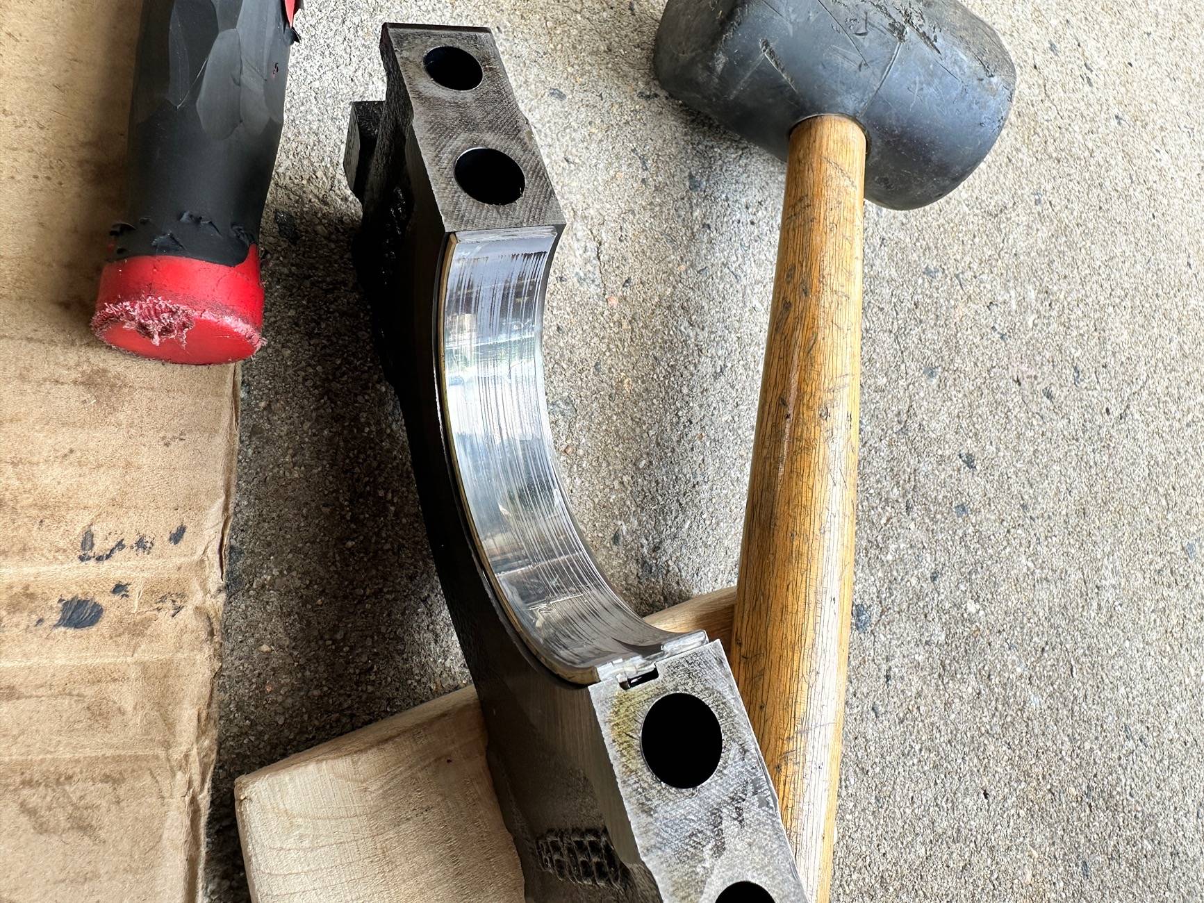

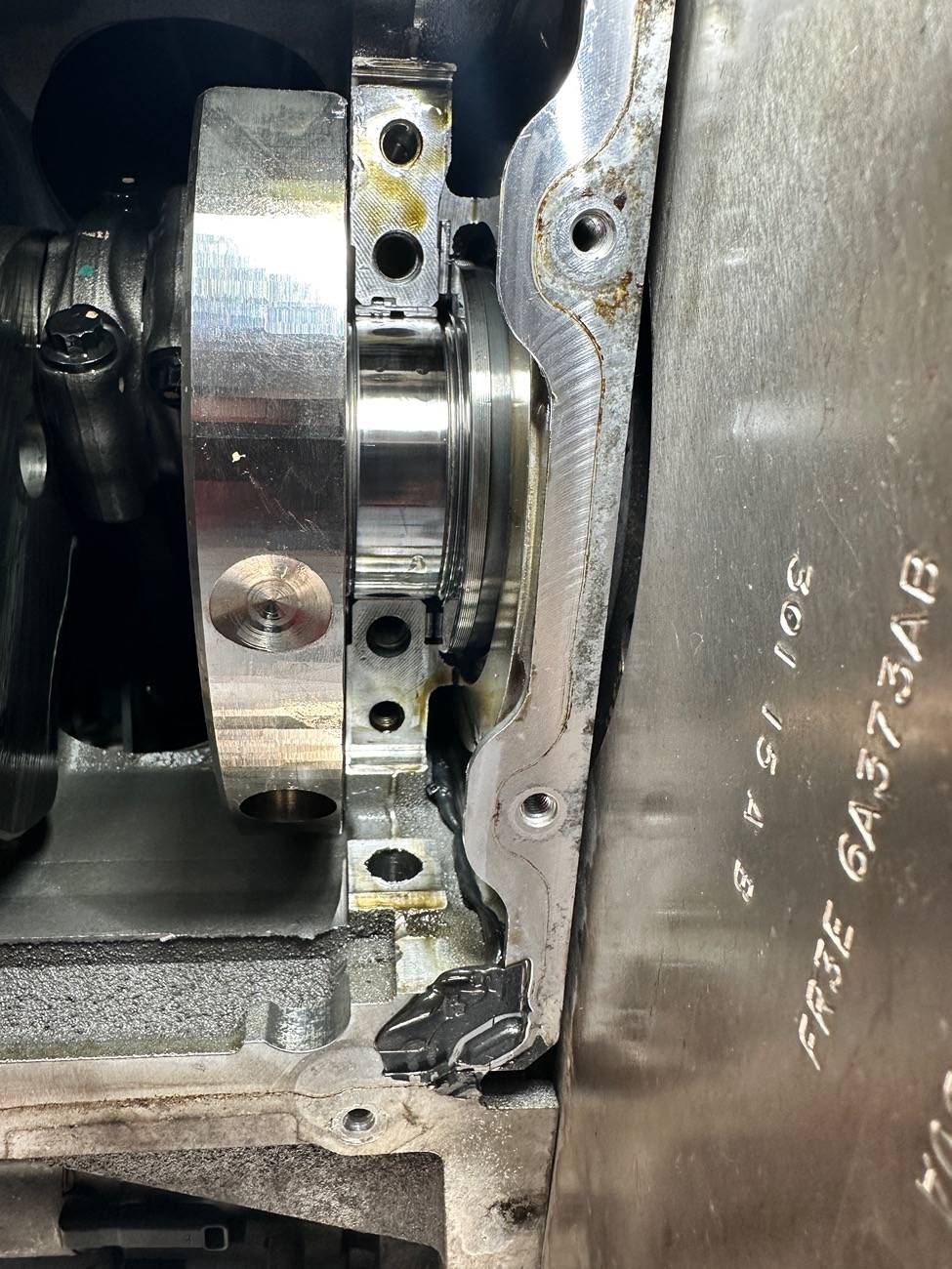

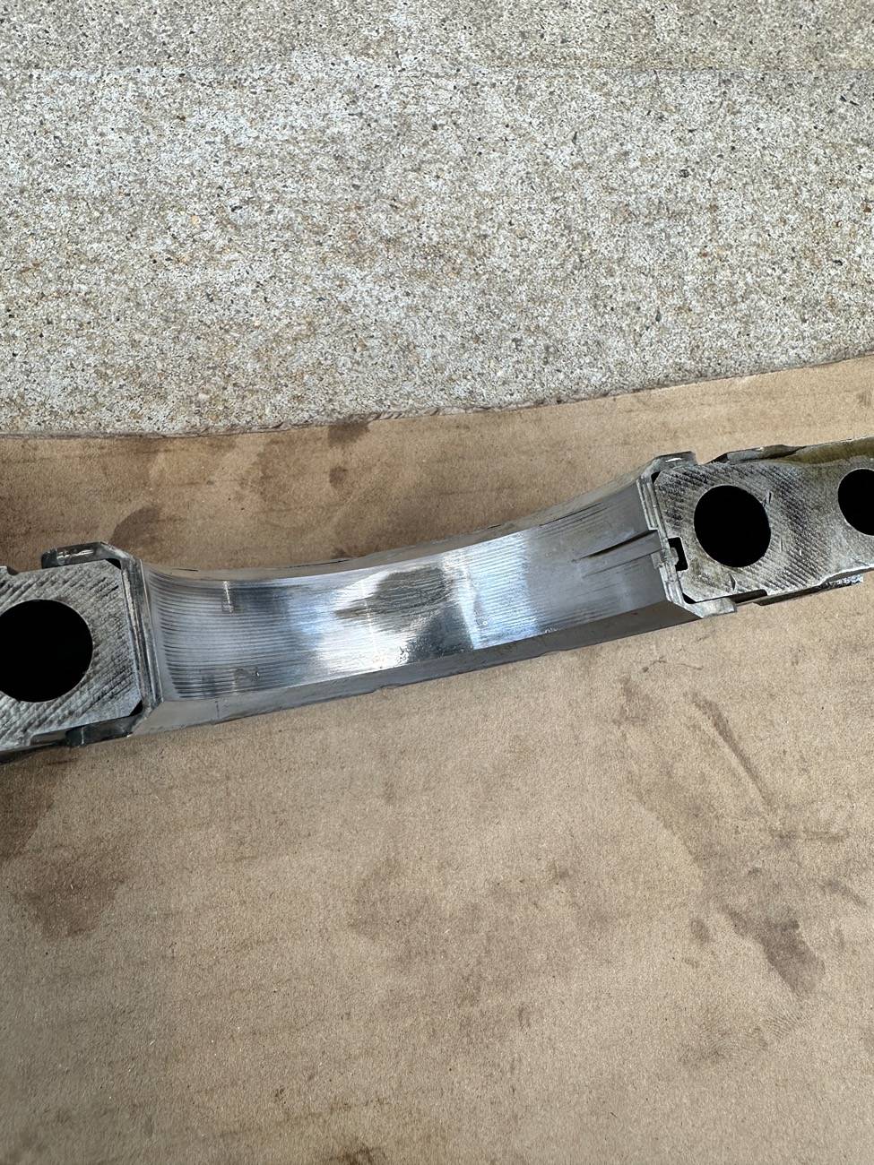

#5 was a pia to get out. The bearing doesn’t look terrible, there is a wear mark but certainly not any cause of glitter in the oil. The other three mains should be straight forward getting out.
