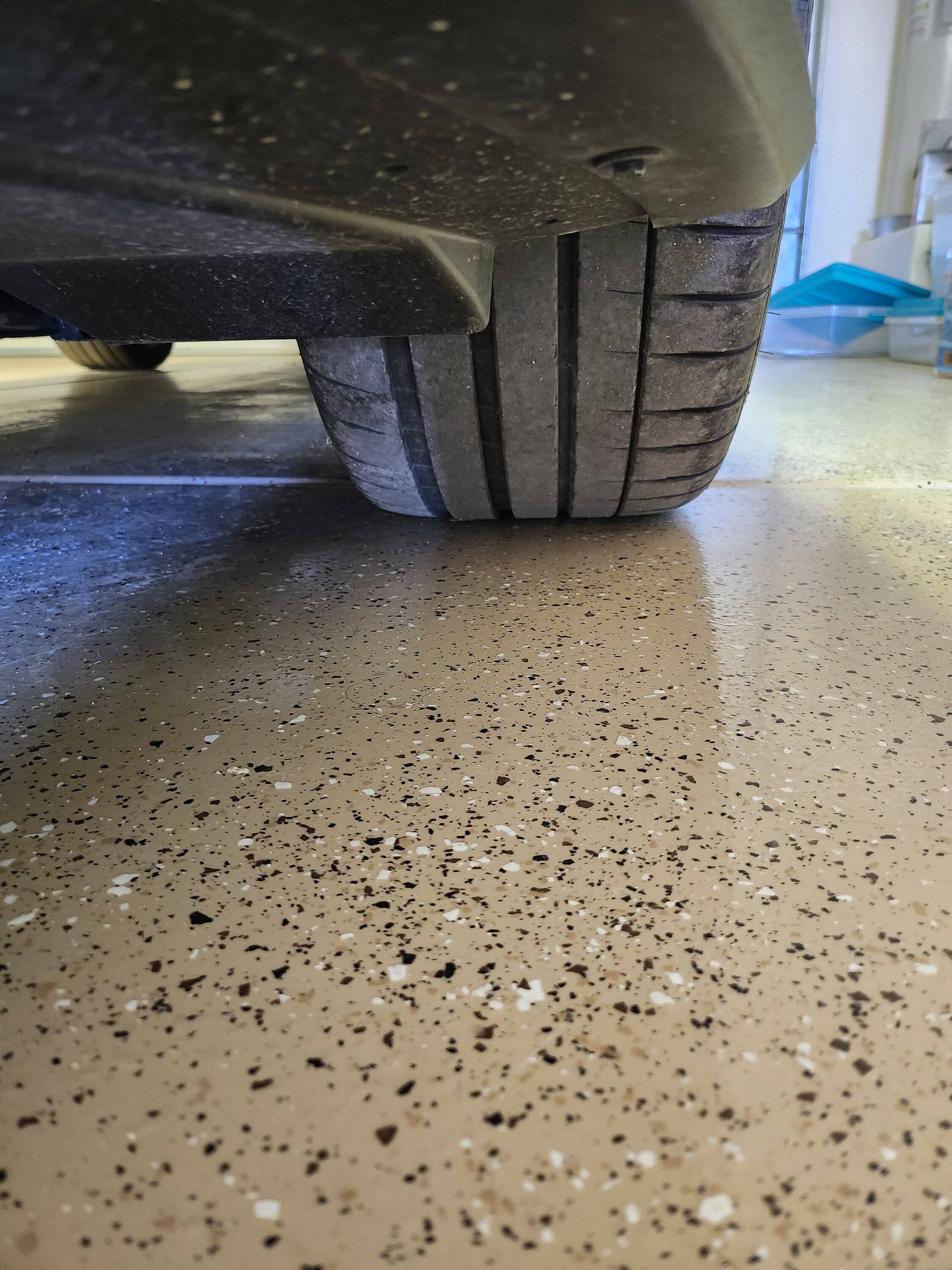

Front tire worn down unevenly, why?

If that was toe out both tires would be worn very similar. That is quite a bit of neg. camber and yes a shop can fix it, be aware there is no camber adjustment from factory. You will either need camber plates ( best, expensive),or bolts (less money and ok depending on how you use car). if you plan on tracking car I would shy away from bolts. It's ok to change just one end at a time with tires. As far as what caused it I agree with all the above ideas, hard to say. Jim
It might be expensive initially but if it makes you have to replace a tire or two every 10k miles or so it might save money in the long run.

Alignment should be checked every 2 years. Things move, esp if you hit them hard enough. Factory alignment was probably total crap.
Toe is evil. Camber of 1.3 ish (about max with stock bits) will last plenty long. Tires should be replaced every 4 years anyway.

Unfortunately this is an issue with the Michellin MP4S on our cars. I’m on my 4th set and no matter how closely you micromanage the alignment, this is what end of life is probably going to look like for that tire. Its probably a mismatch with the weigh of our cars on the front axle and the tires construction.
For best results check the toe once very year and dial just ever so light toe in (so the dynamic toe with road forces at speed is as close to zero toe as possible). Rear tires dont seem to be as much of an issue as the fronts so run normal amount of toe in at the back.

Hm I see ok good to know, thanks Jim. Just curious, if there’s no wiggle room for the camber to be adjusted, how did it get screwed up over time if it has no where to go?
I wish I could tell ya, may have been that way from day one. Maybe a monster pot hole you don't remember, so many possibilities. It's a shame that now days you have to check so many things on a brand new vehicle to make sure it's in spec.

Ok, hopefully the alignment shop can get it sorted out.
