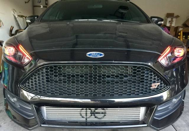

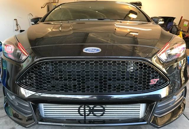

you can always shave the grill, like the focus guys.
before...
after...
...but I never did it, don’t like seeing the crash bar and all the other stuffs.

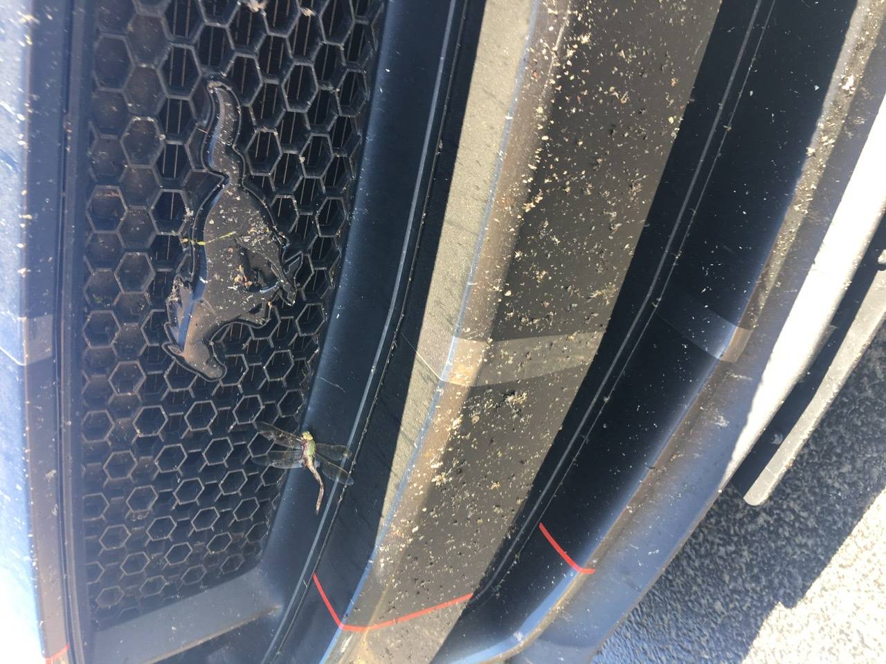

i join you with that concern. Debris can very quickly bring an end to a joy ride. Just look at this buildup after a cross country trip.
