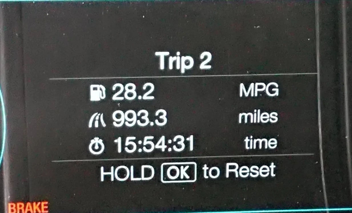

Just did a long drive, drove LA to Tucson round trip and avg was 28.2 MPG. It took some hits due high cross winds between Blythe and Palm Springs and also a few mountain grades at speed limits of 65-70-75 mph

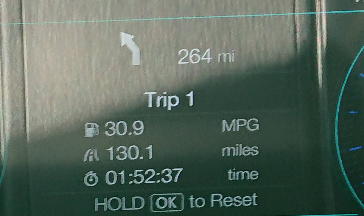

The other was just filling up and driving from Tucson to Phoenix which is pretty flat and that did avg at 30.9 MPG on 75mph speed limit highway.
I guess I am cleaning some carbs out with this Tune. my mpg has performed better since the tune. previous trip pre-tune on same route was about 26-27 avg.
Temp outside was 85-90F. inlet was around 5+ ambient avg
