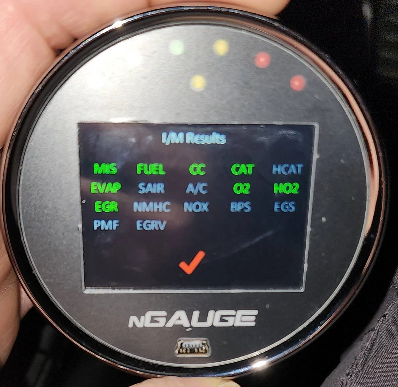

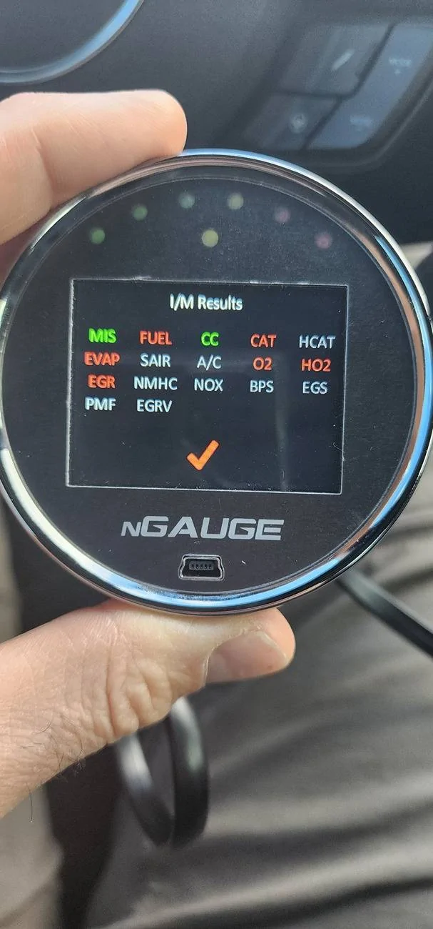

Time to hook up one of these, go for some rides, and see if there is any movement. Sounds like either you need time, or something is off with that header install.
Where is that screen? Under Diagnostics?
