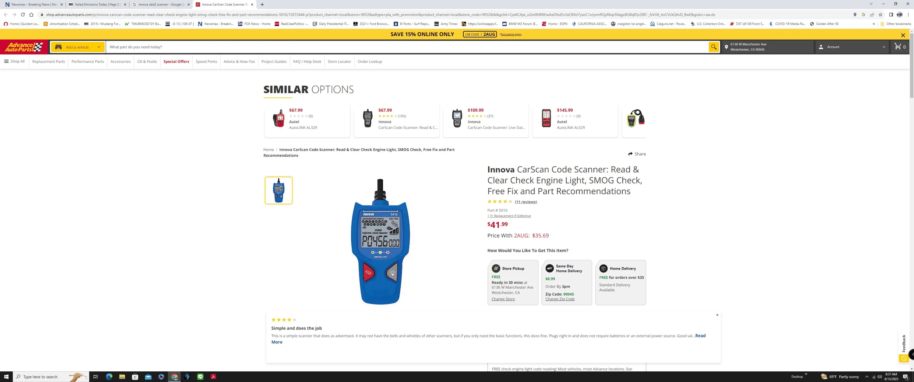

What is showing not ready? Don't keep just taking it to get smogged. Do you not have an OBD2 scanner? You own one of these cars that is tuned you must get yourself an OBD2 scanner.
Here is an inexpensive one. These are a must have...notice all the letters at the top of the scanner. These are the readiness codes which must be green before you can smog. You can reach out to me via DM and I will leave you my phone number.
