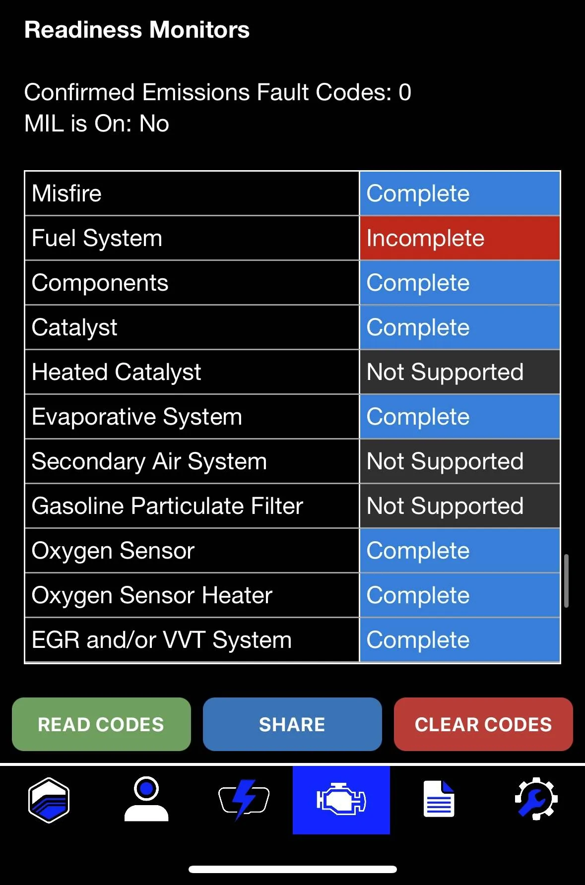

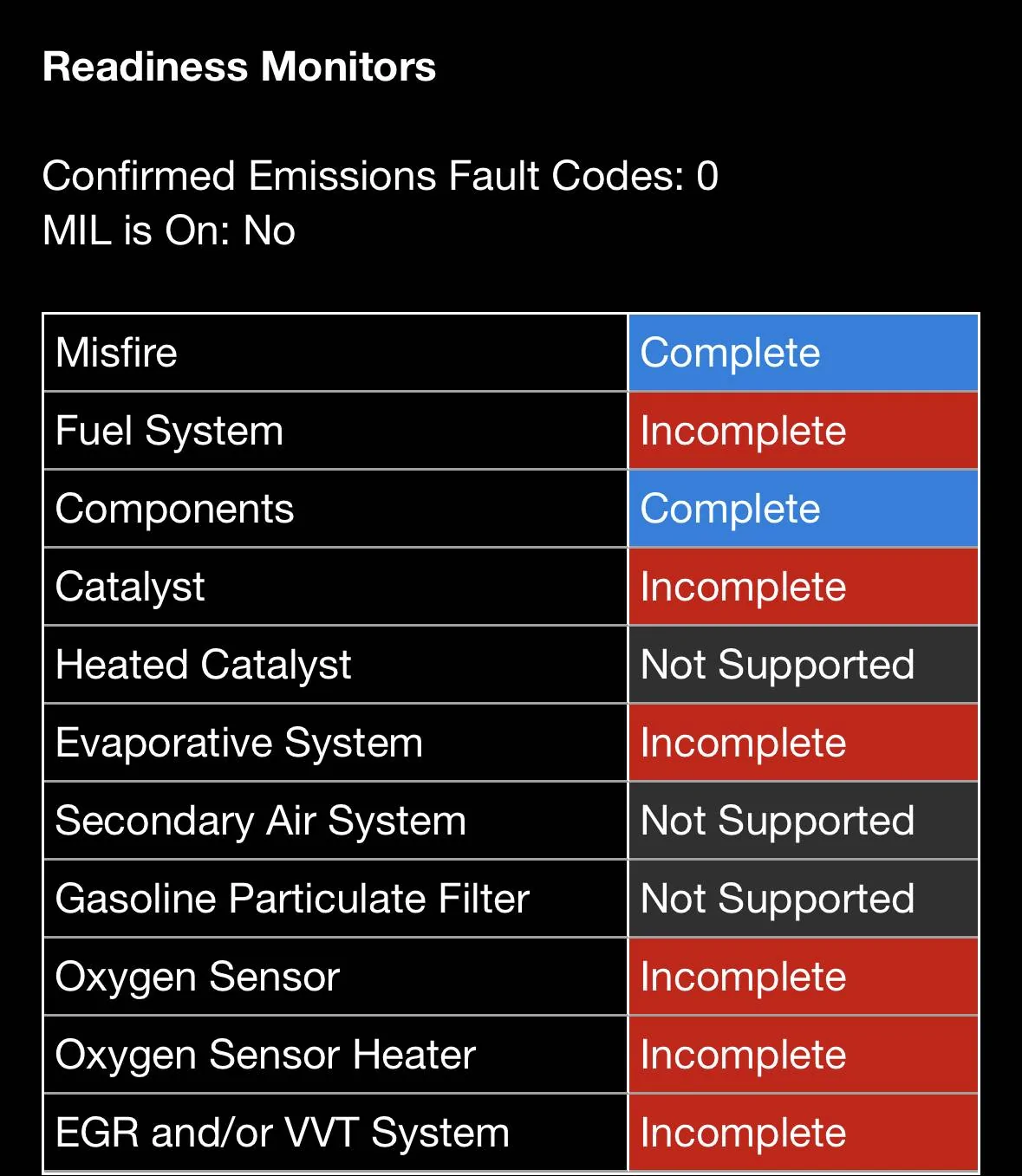

I am currently tuned and trying to get my car inspected (have a friend that is doing it) but I am unable to pass because of so many incompletes. Lund says they will clear but I swear they have been incomplete since I had my blower installed last August.

If it was recently flashed, battery pulled, etc, it'll definitely take 50-100 miles for the monitors to go to a ready state.
Well, the tune I flashed today (after the inspection) was the same one that was never ready for the inspection. Had that tune going since last August and fuel system, catalyst, EVAP & the two O2 monitors never completed after 7 months 😂
