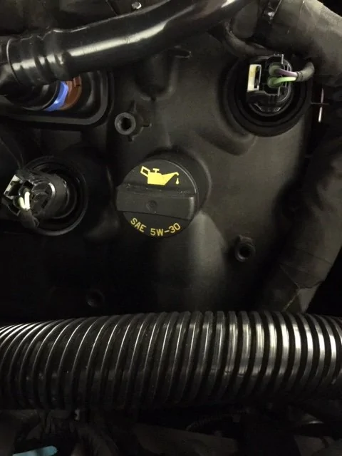

Hey, which year is your car? And where do you live? And yes, change the cap, like I did :D (pic below).
Indeed, since both are 5W when cold. That almost proves Ford is using something else than 5/20 as a factory fill. Hmmm. I'm going to use M1 0W30, and see what happens. And no, I didn't find a 0w30 cap, or I'd have bought that instead. Ha ha.
As a closing thought, I really hope I don't have to use any freaking oil additives, because those are NOT approved anywhere. And at least in the case of Ceratec, it'd be absolutely obvious there's something in the oil, due to its creamy color. Not good.
2019, Ontario Canada.
Although the tick is barely noticeable and intermittent, thinking I will do the 30 weight next change. Like you said... see what happens
I also agree with your statement:
“That almost proves Ford is using something else than 5/20 as a factory fill.”
Bikerman was right, I was looking at the wrong damn page
