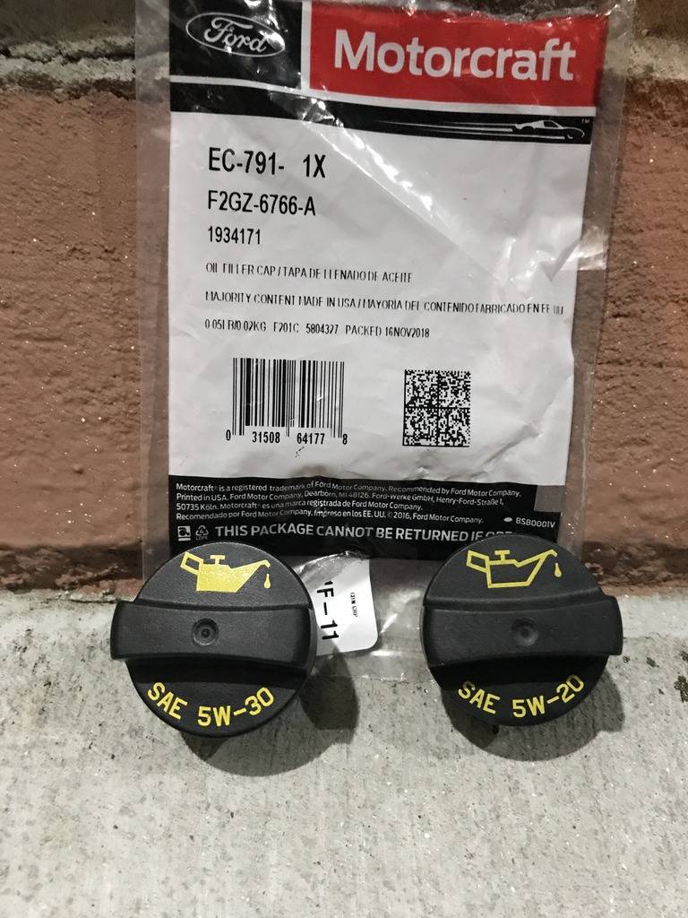

I think it's on the contrary; engine was designed with 5/30, but Ford probably chose 5/20 in the US due to the EPA, to increase their CAFE standards by a fraction of MPG. In many other parts of the world 5/30 is still recommended... on the SAME engine. There's no doubt 5/30 provides better protection; the only question is if you need it or not. Since it's 100+ for months here in hot TX, I prefer to err on the side of caution vs gaining 0.1MPG, but that's just me :). Besides, M1 0/30 is a 'thin' 30 weight, so very close to being in 20 weight range, which probably happens after 1 to 2K miles.
my owner manual specs 5w30, or 5w50 for track use.
Hey, which year is your car? And where do you live? And yes, change the cap, like I did :D (pic below).
If it ticks during the first two minutes after a cold startup, then replacing 5W20 with 5W30 won't cure it.
Indeed, since both are 5W when cold. That almost proves Ford is using something else than 5/20 as a factory fill. Hmmm. I'm going to use M1 0W30, and see what happens. And no, I didn't find a 0w30 cap, or I'd have bought that instead. Ha ha.
