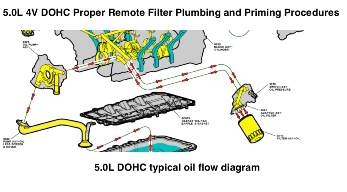

That'd be the direction I am thinking about going.
First photo, realizing the title is a how too for a remote oil filter. The oil flow thru the motor does not change.
The point here is that the filter IS not on the return end of the system.

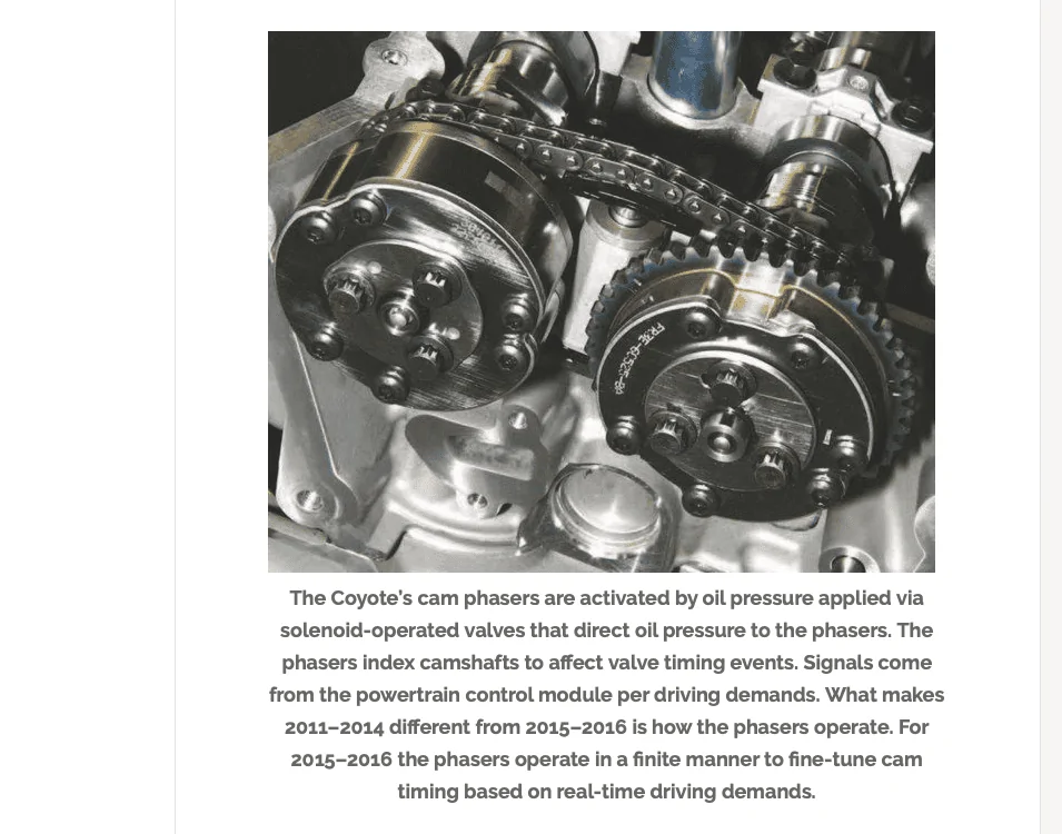

Adding to the engine noise reality. Read this sometime ago, found a picture of the cause.
2 points to make
The sound is caused or there as a result of on the fly cam timing, adjusting constantly. Thus come and goes with the rpm of the motor, explained under the photo.
Saw an after market design. That was hyped as a way to limit or quite the sound.
I'm sticking with the Ford design, engineers and CADs. Make things look good on a display. Even produce upgraded parts that may function . Not one to be the bata tester, take the wait and see approach
Knowing what the sound is and where it is coming from, is good enough for me.

Oh okay, good to know. I hadn't actually seen an oil flow diagram for that.
