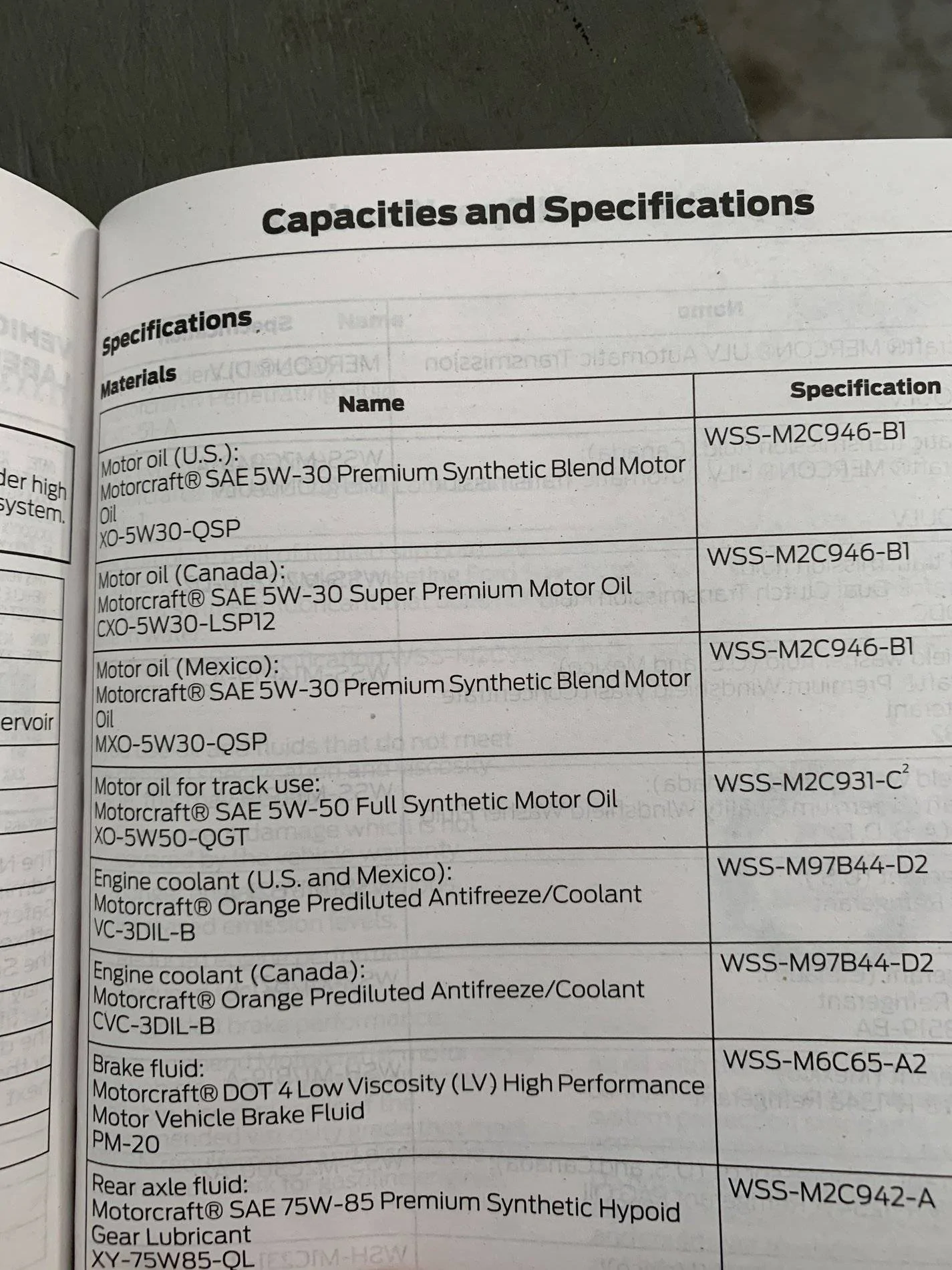

No. If Ford thought 0-whatever was best for our Coyotes they would have specked them that way, especially up North.
The '0-whatever' is a non-issue; ALL such oils are fully compatible and approved by all manufacturers (and yes, both 5/20 and 0/20 are approved on my Bullitt manual, page 309), since again, there's no drawback. They lubricate quicker when cold than 5W, even if it's 90-deg outside. Where there might be an issue is with 20 or 30. But again, like everything else, not all 20 grade oils or 30s are created equal. You have oils that are at the low, middle, or high end of that range. A high end (or 'thick') 20 weight is almost the same as a low end ('thin') 30. Another reason for 30 weight is fuel dilution, which would lower a 20 weight oil beyond acceptable, but not sure if it's a real problem on 5.0s or not (like it is on EBs).
Finally, this particular oil issue is not something I trust Ford with. Why? Simply because they're reportedly doing it to appease the EPA, since they certified our engine using 5/20 (for the highest possible MPG), and they need to recommend it, even if engineers preferred 5/30. In fact, many other countries recommend 5/30 (Australia, Japan, Taiwan, etc) on exactly our same engine; how do you explain that? :D
Bikeman315
Apr 12, 2015
583
16,194
21,915
Myrtle Beach, SC
Ira

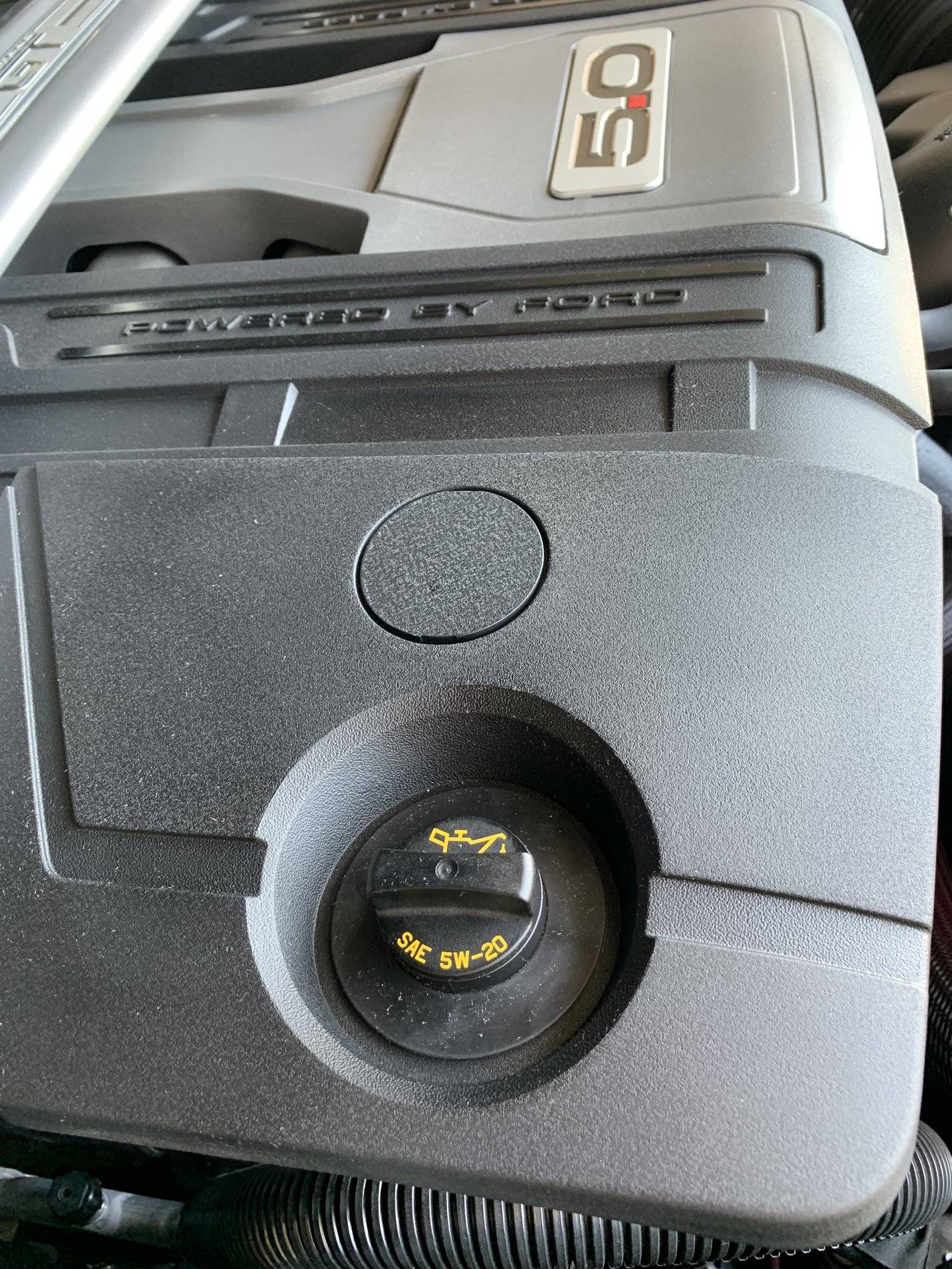

Of course you can use 0- but look at Ford's recommendation, not approval.
Alternative Engine Oil for Extremely Cold Climates
To improve engine cold start performance, we recommend that you use the following alternative engine oil in extremely cold climates, where the ambient temperature reaches -22.0F (-30C) or below.
When was the last time the temps hit -22 in El Paso, TX. :) Kind of like gas, Ford approves of 87 but recommends 91/93.
As far as 5W-20 & 5W-30 Mexico and Canada have the same recommendations as the US. Considering the warranty issues/costs that could arise in using substandard grade oil to appease the EPA, not likely.
Motor oil (U.S.): WSS-M2C945-B1
Motorcraft. SAE 5W-20 Premium Synthetic Blend Motor Oil
XO-5W20-QSP
Motor oil (Canada): WSS-M2C945-B1
CXO-5W20-LSP12
Motor oil (Mexico): WSS-M2C945-B1
MXO-5W20-QSP
Motor oil for track use (U.S.): WSS-M2C946-B1
Motorcraft. SAE 5W-30 Premium Synthetic Blend Motor Oil
XO-5W30-QSP
Motor oil for track use (Canada): WSS-M2C946-B1
CXO-5W30-LSP12
Motor oil for track use (Mexico): WSS-M2C946-B1
XO-5W30-QSP
So if i understand you correctly, you gave Ford $50k for your Bullitt but do not trust what they are recommending for something as basic as engine oil. Fascinating.

you gave Ford $50k for your Bullitt but do not trust what they are recommending for something as basic as engine oil? Fascinating.

I have read through many of these threads regarding the “tick” many opinions and “possible” solutions?
I just did my first oil change at just under 5000 miles and used a 5w20 full synthetic. Noticed the sound within the first 2 min of startup. So far I have found to be super intermittent, ticks less than it doesn’t.
What I find most interesting is the conflicting info, both from people on forums and from Ford.
Forum posts almost all say 5w20, my filler cap says 5w20, but my owner manual specs 5w30 or 50 for track use.
I will switch to 5w30 on the next change. Likely sooner than later
