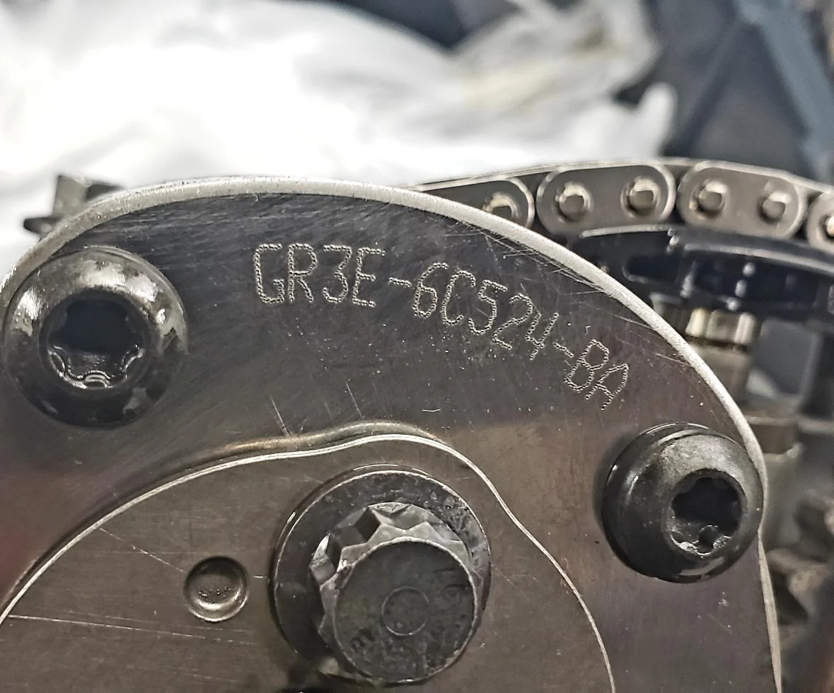

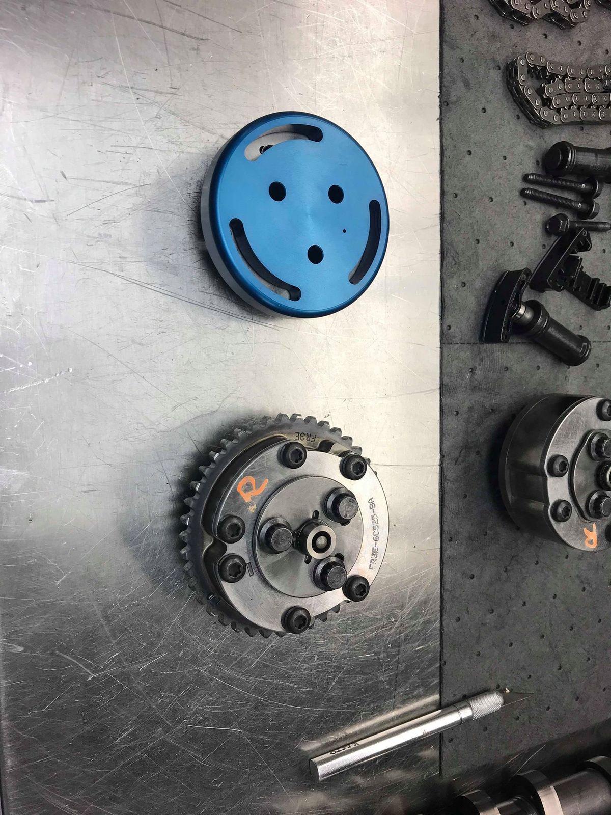

Anyone tear down an 18 350? Not keeping me up at night but I find this fun, in a weird way :)

Ist it possible sometime in 17, all GT350s received the GR part
