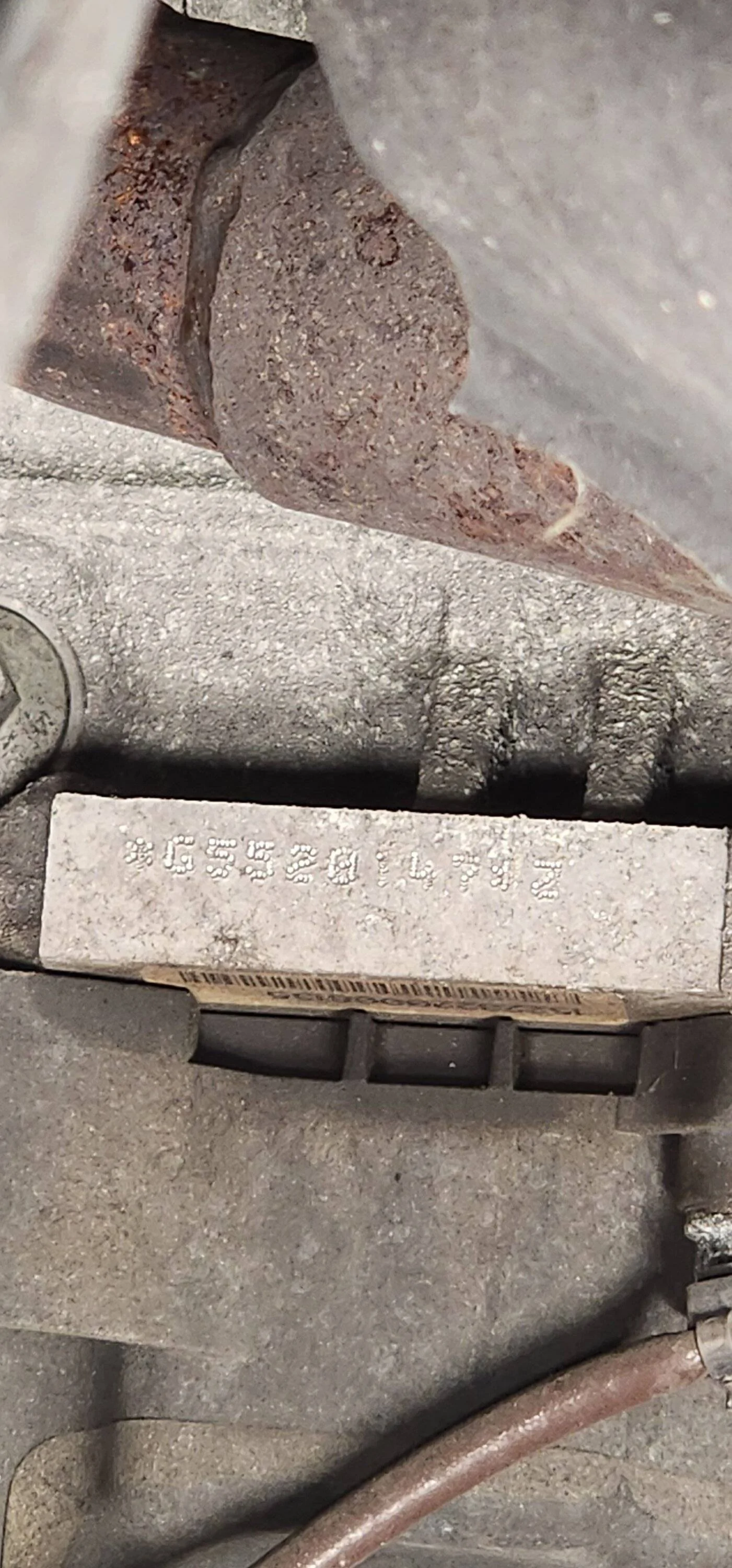

Just ran through this entire thread. My car is missing the ID tag on the valve cover. It was pulled off. The car came with 30k miles on it. Does anyone know where/if the VIN or any other codes are stamped or etched into the block or heads that can identify my engines origin? 2016 GT350R

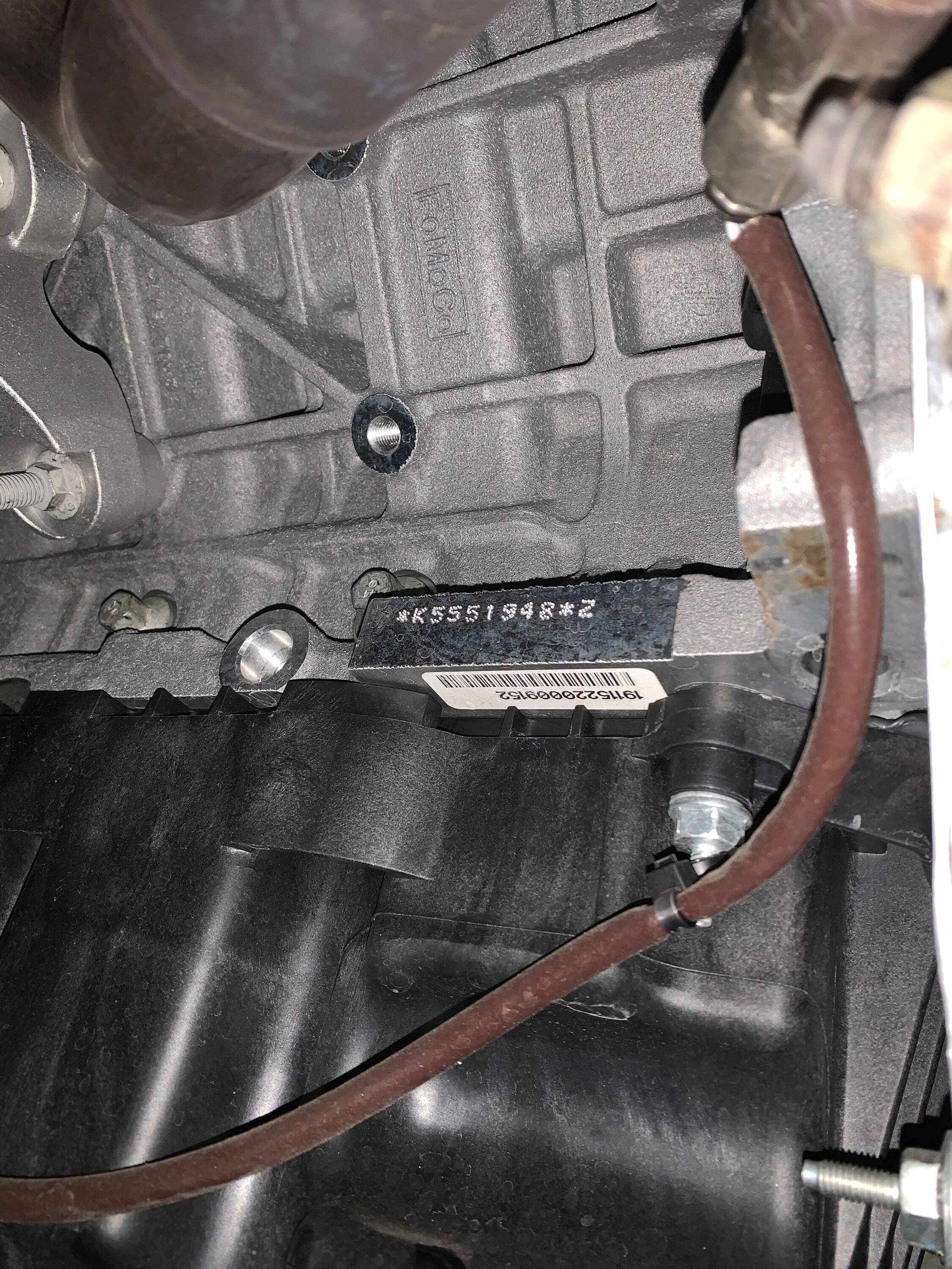

Only thing I can say is on Drivers side rear engine block is where the vin is stamped. If the engine vin matches your cars vin then it's the original engine. If it dosent it has been replaced.
Underneath the car, drivers side, back of the engine.

@passwords @sox3 Thanks gents. Found it. Matches my VIN. Original engine. I'm happy about that as the car was a Ford fleet test vehicle.
I do notice @passwords is a lot cleaner than mine. I guess that's what 25k miles in Detroit over 5 years does.
