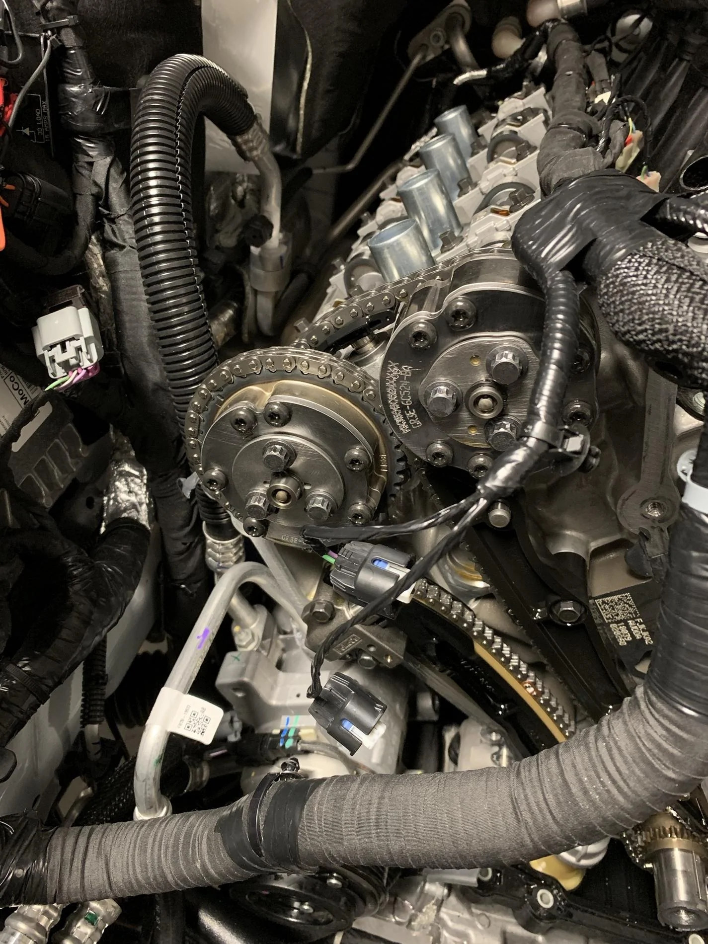

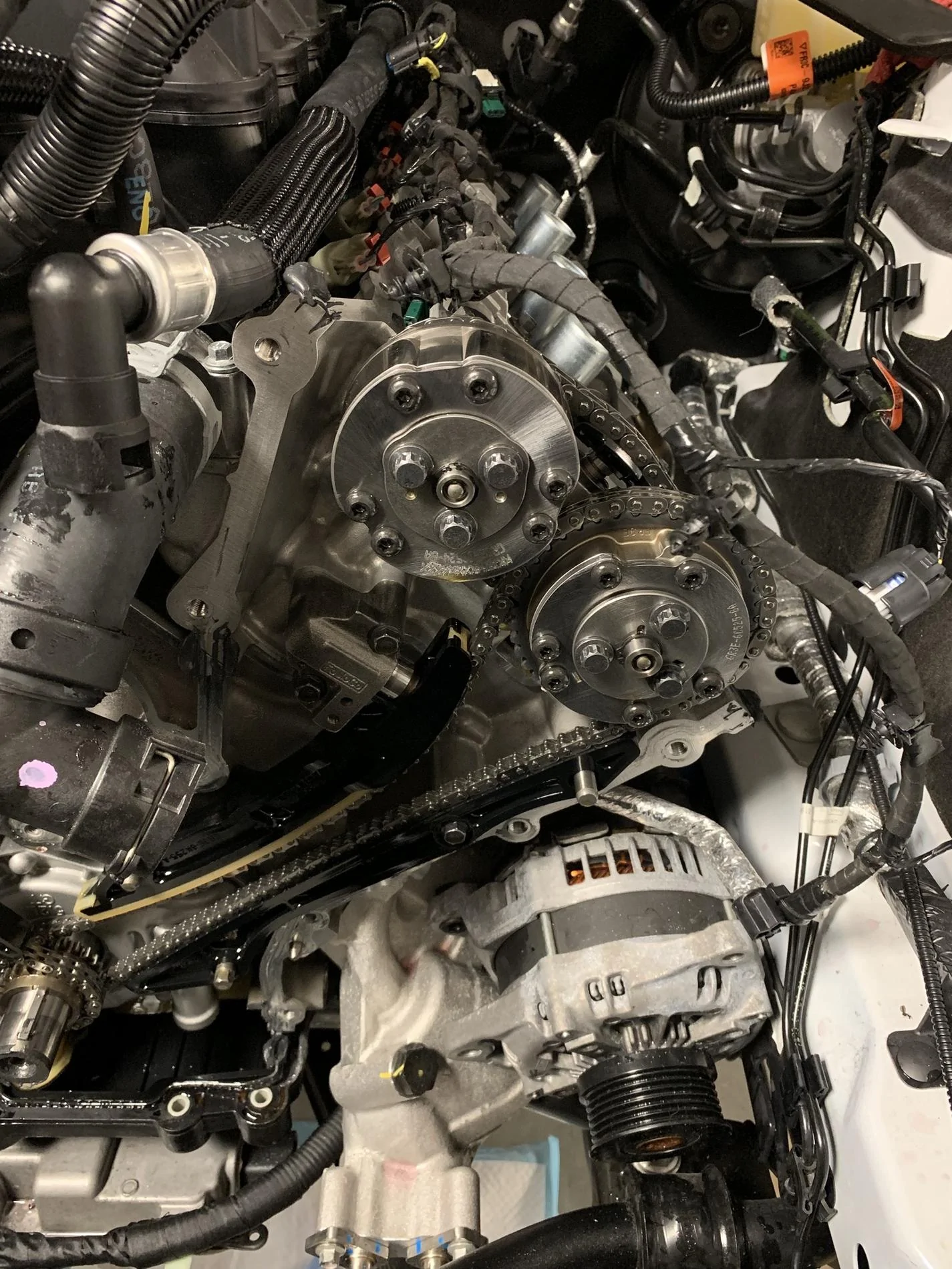

I have pics of the phasers on my R. Give me a bit to upload and post after my meeting.

From my buddy with a 2016 R
Pretty much confirmed at this point me thinks.

Thanks @honeybadger and @madlag that just about wraps this up I believe. :)
The GT350 and GT350R engines are in fact, not identical. Seems the GT350R gets the Ford Racing phasers, that's all we know at this time.
