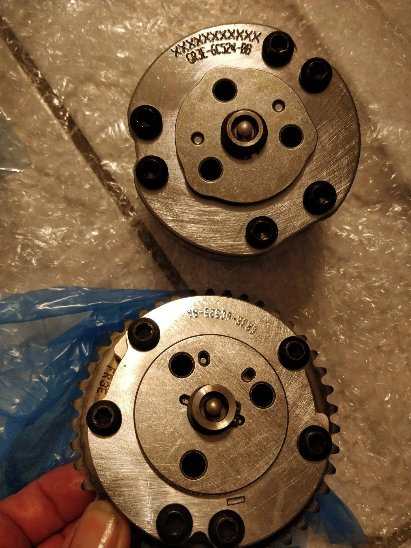

This is what came in the FR upgrade phaser kit:
These are not the part numbers for ordering though. The FR kits is probably the easiest way to get them. they come with new bolts too.

@honeybadger
One is the intake phaser and the other is the exhaust phaser. the gears are attached. You need 2 of each.

The M*6004*A50R is just the phasers and the 12 bolts to attache them on cams. I didn't mean the full timing kit...I don't know if the GR3Z phasers even come in the full timing kit...they didn't in 2016 when I built my first one.
