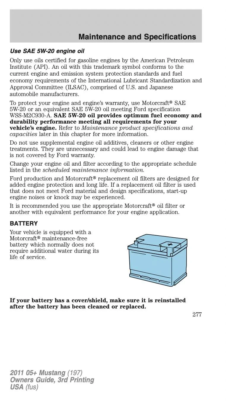

More on the "temporary blip" from 2011 to 2021.
2011 coyote mustang owner's manual.
Oh NO!!!!! I've not been checking the oil in my battery. It clearly says it does not require additional water....so it must be oil may be required...it's on the page with oil as the heading isn't it? :shock: :shock: :shock: :shock: :shock: :shock:
Of course this is where reading comprehension exercises in school come in handy for real life.

I will cop to being wrong on the 'blip'. I could have sworn I remembered (wrongly apparently) that 15-17 the manual called for 5w30 and the caps likewise reflected that. There was a big kurfluffle about this when the 18's first released.
In any event 5w20 is "wrong" for any number of reasons and I will never use it unless I'm in the middle of AZ desert during the days of MadMax and it's the only fluid available so I can outrun the gangs intent on pillaging the last of the precious hydrocarbons left on the planet. But hot, sandy is the definition of extreme usage, so once I can make it to the Canadian border to change out, 5w30 or 10w is going back in.

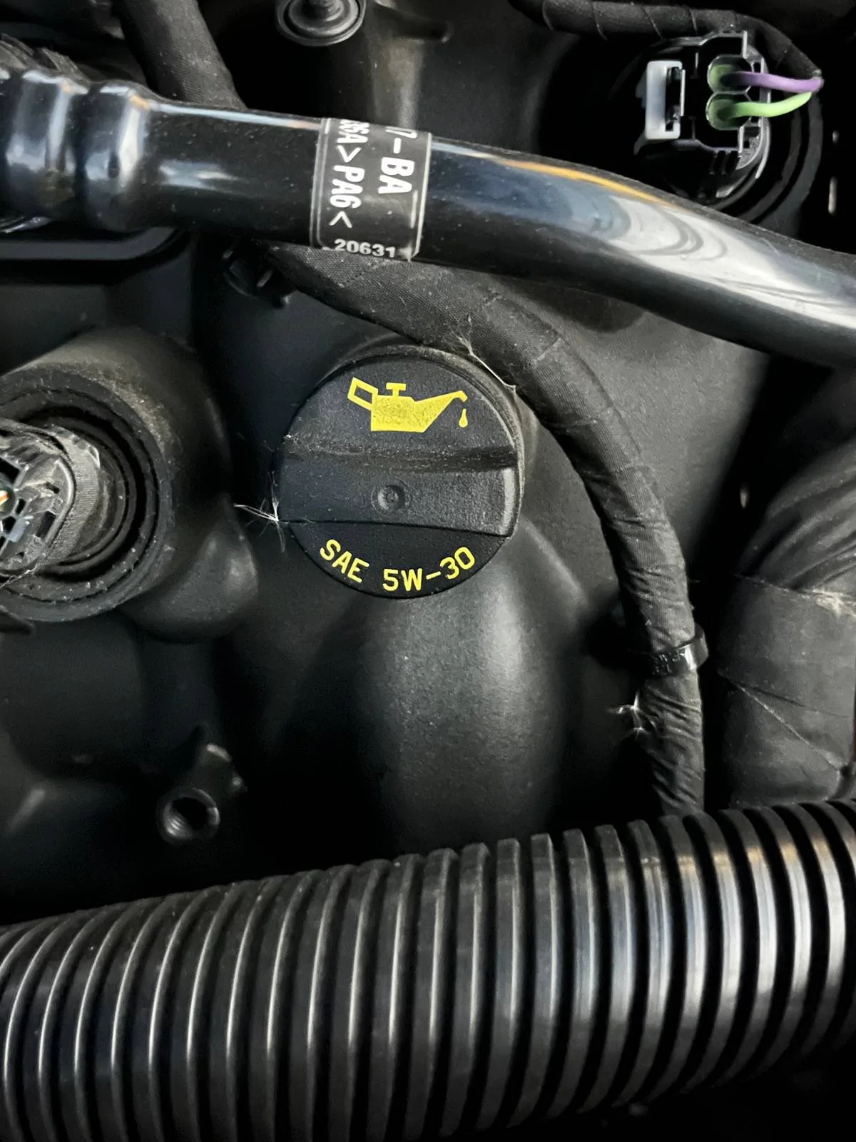

Im sure you think you're funny, but my 19 also says 5w20. Now go outside like a good boy and look at a late year 21 or 22+. And then tell me Ford didn't change the cap and manual. K?
The only time 5w20 disgraced my engine was the first 500 miles from new. I threw that water out and been using 5w30/40 or mixing in 10w40 when I feel like it.
Next thing you'll tell me I imagined Ford changed the rotor venting in 21 for all the 4-pots. Because your car and those from the previous 15 years also had it the wrong way ..
Here’s my 2022 cap…

I love how Ford carefully worded the manual. I could see how it could be interpretted two ways:
"SAE 5W-20 oil provides optimum fuel economy and durability performance meeting all requirements for your vehicle's engine"
In other words, you could break it up into parts and it would read like this:
"SAE 5W-20 oil provides optimum fuel economy"
"SAE 5W-20 oil provides durability performance meeting all requirements for your vehicle's engine"
The second clause might lead to you wonder, what were these "requirements"? "Optimum" means it's maximized, but for durability is just "meets requirements". Is the requirement that the engine lasts 150k miles while driving gently? I don't know.
Add one comma and it changes the meaning: "SAE 5W-20 oil provides optimum fuel economy and durability performance, meeting all requirements for your vehicle's engine". If this is what it said then there would be a stronger argument for the 20. So did Ford word it that way to intentionally fool the drive-by reader into thinking 20 gets optimum durability?
