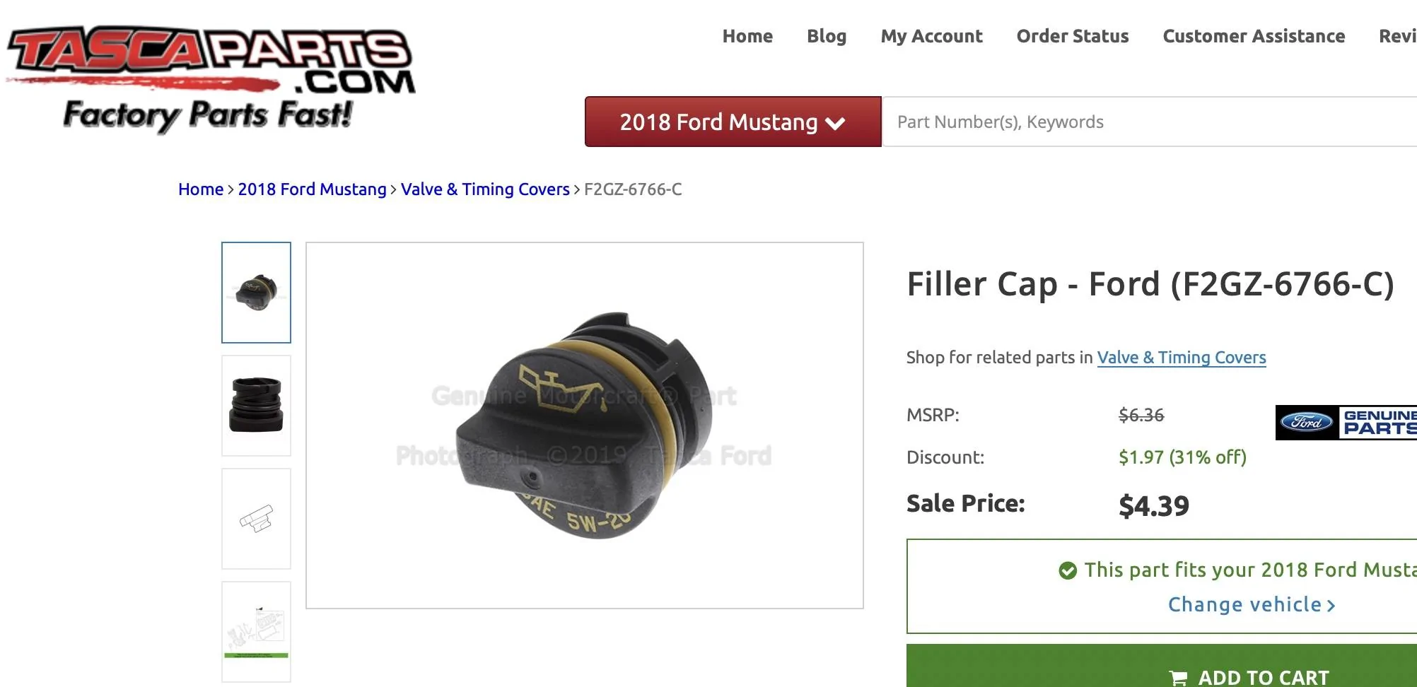

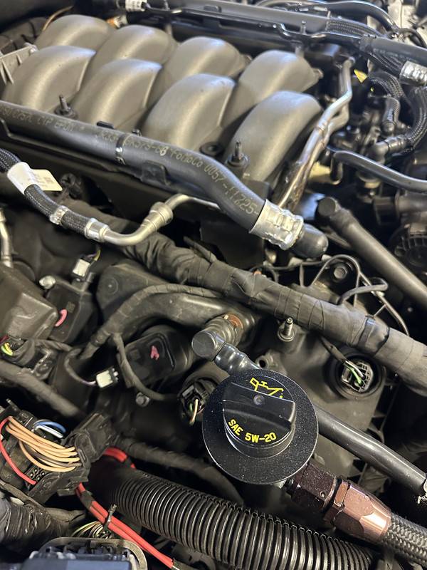

100% not correct. Every coyote's oil cap for 10 years said 5w-20. But you all are smarter than Ford's R/D department.

My filler cap says 5W-50

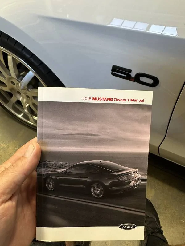

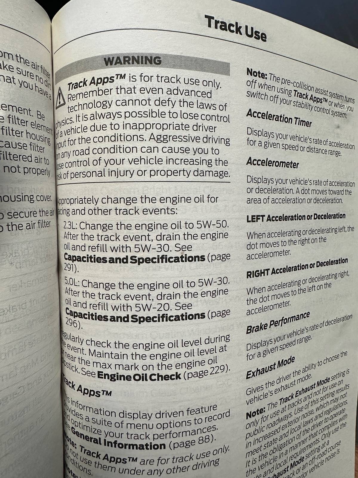

I took @shogun32 advice and went ahead and took a look at one of these cars (my own lmaoooooo).
I thought my eyes might be deceiving me, so I consulted the trusty owners manual that people like @shogun32 surely wrote.
Strange... for TRACK USE it calls for 5w30 and actually states (lol) when done racing to drain the 5w30 and refill with 5w20.
Well shit.
Here's the greatest part... I don't even run 5w20 in my own car (yes I beat on it regularly, unlike OP).. I actually run 5w30
But to sit here and ARGUE on the internet that you CANNOT or SHOULD NOT RUN 5w20 (temporary blip! lolololol) is absolutely stupid and should be called out.
In fact -- for people who LIGHTLY use their 5.0 Mustang... 5w20 is the correct choice.

More on the "temporary blip" from 2011 to 2021.
2011 coyote mustang owner's manual.

Doubtful if for over 10 years in multiple sections of the manual covering track use and non track use. Also... language in F150 manuals is similar (replace track with towing or heavy duty use etc etc), not exact, but similar.
