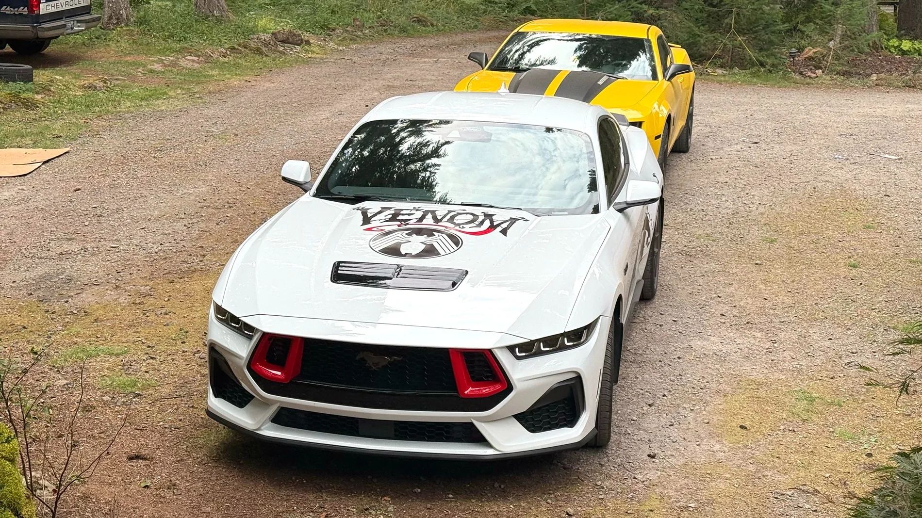

I assume that's just a random picture since it doesn't match the picture in his icon... Plus, isn't that white "venom" an S650?
That said, I don't know if my explanation makes much sense, either, since I have no idea why he would attack a picture of a random car to this post...
