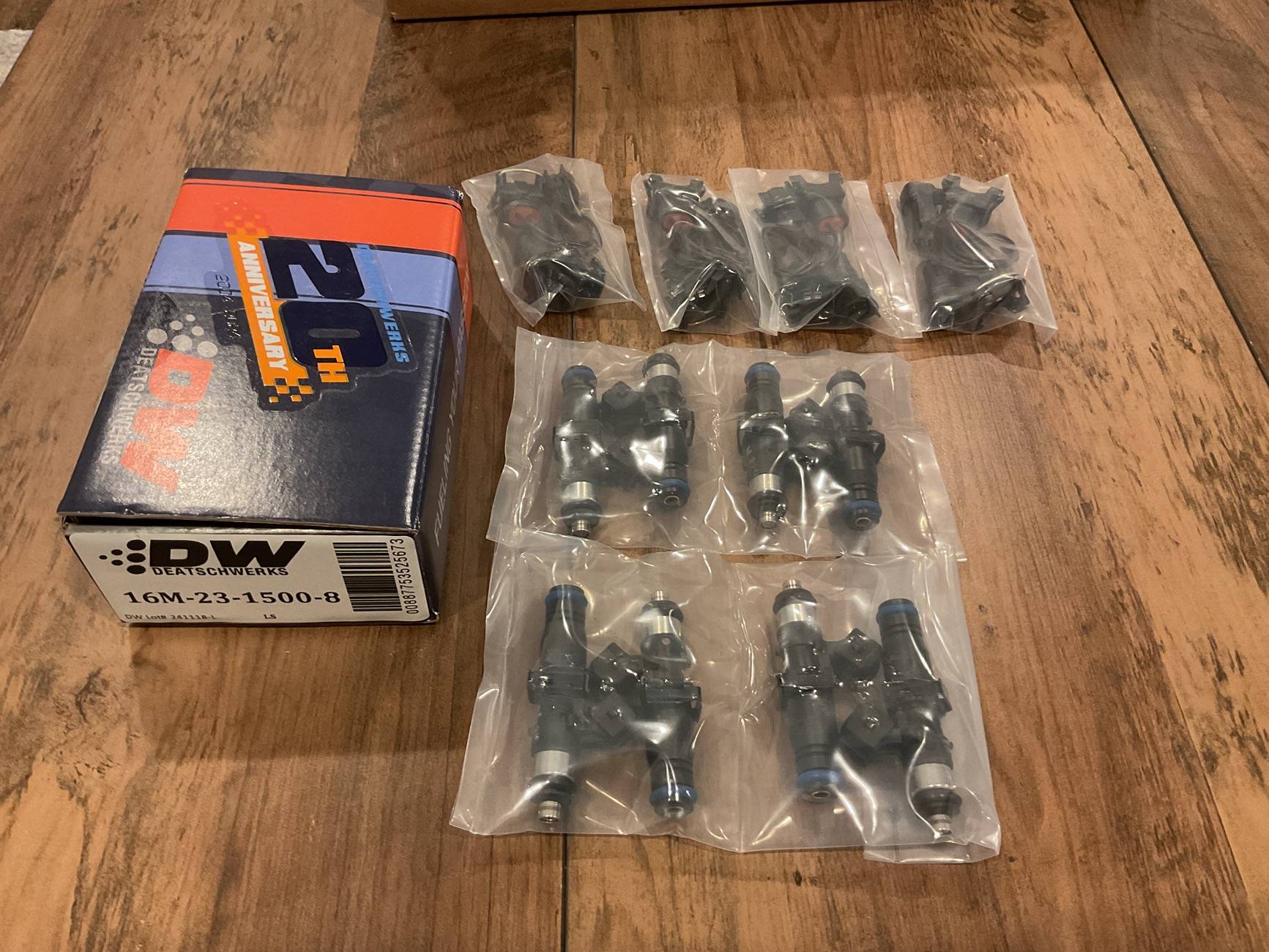

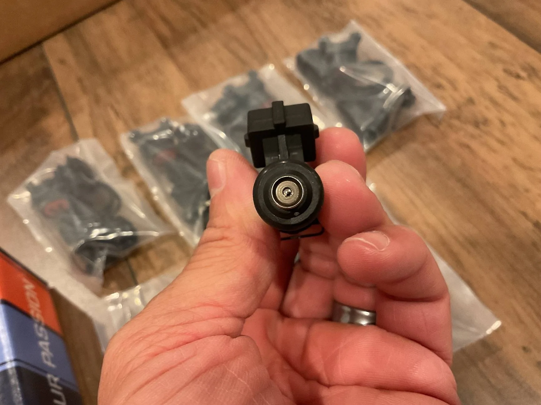

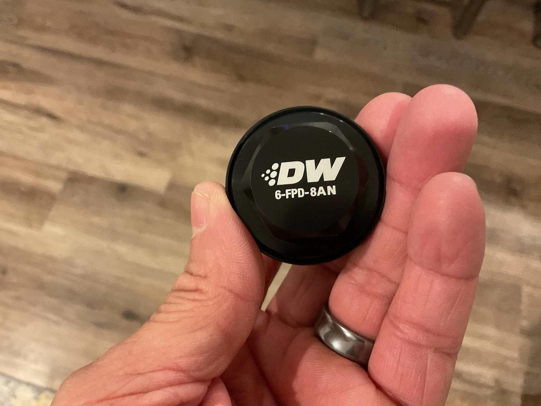

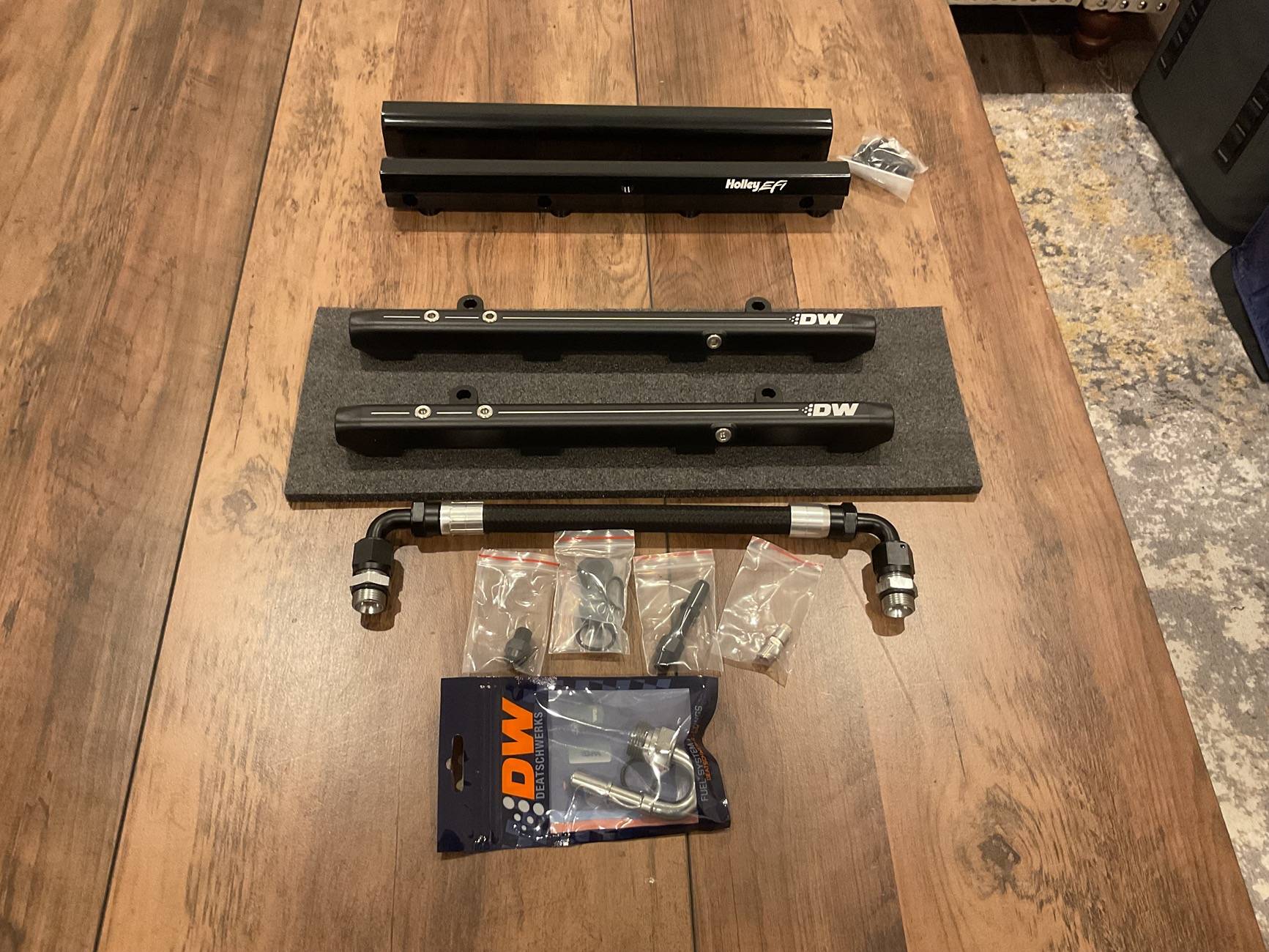

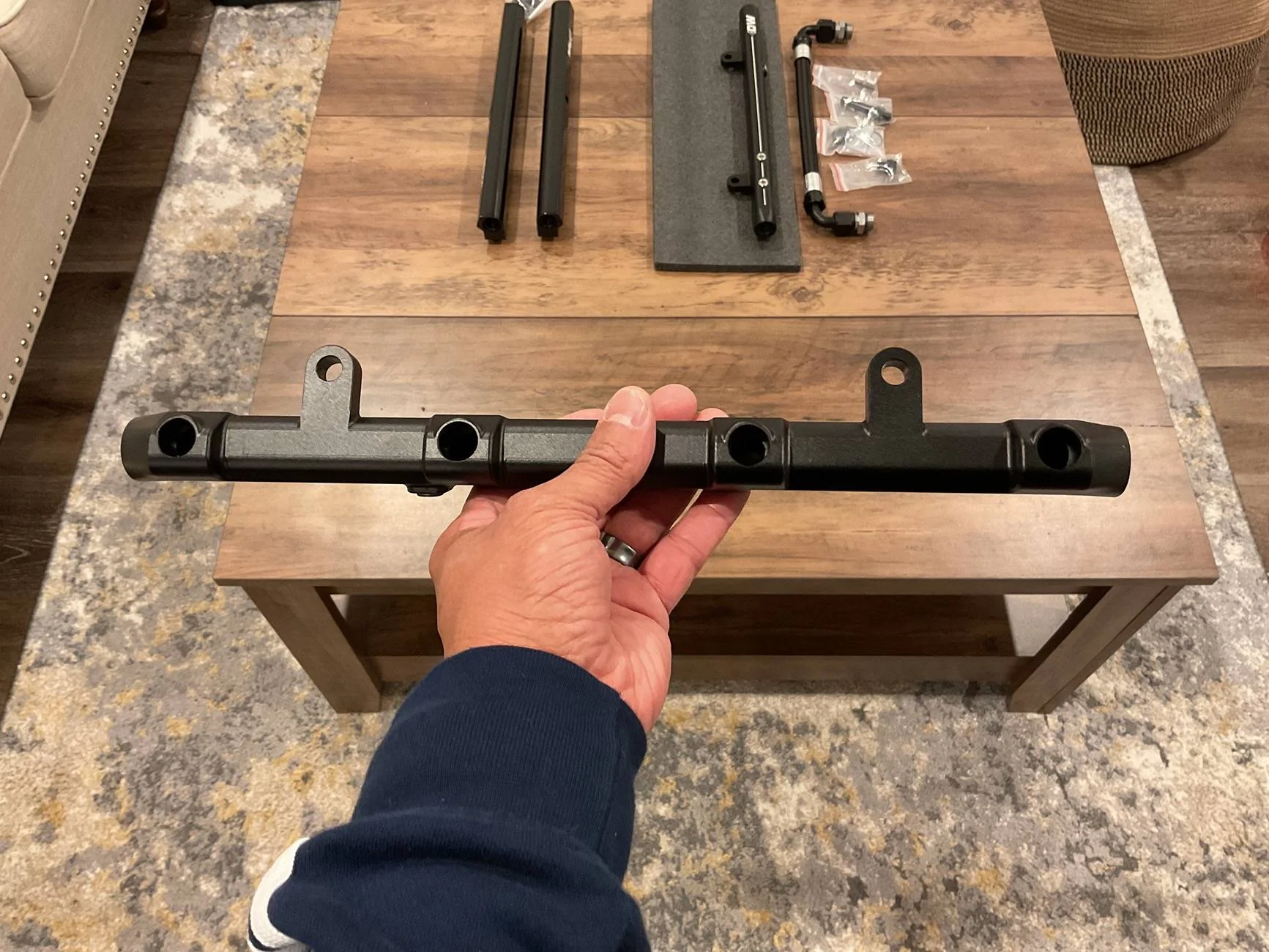

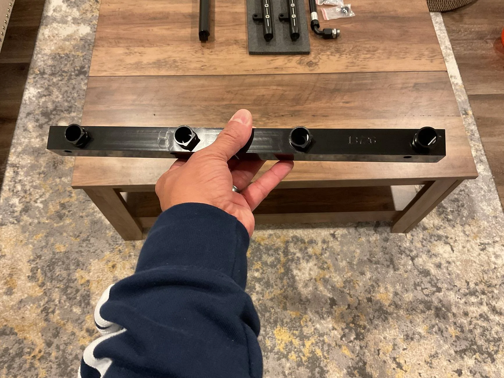

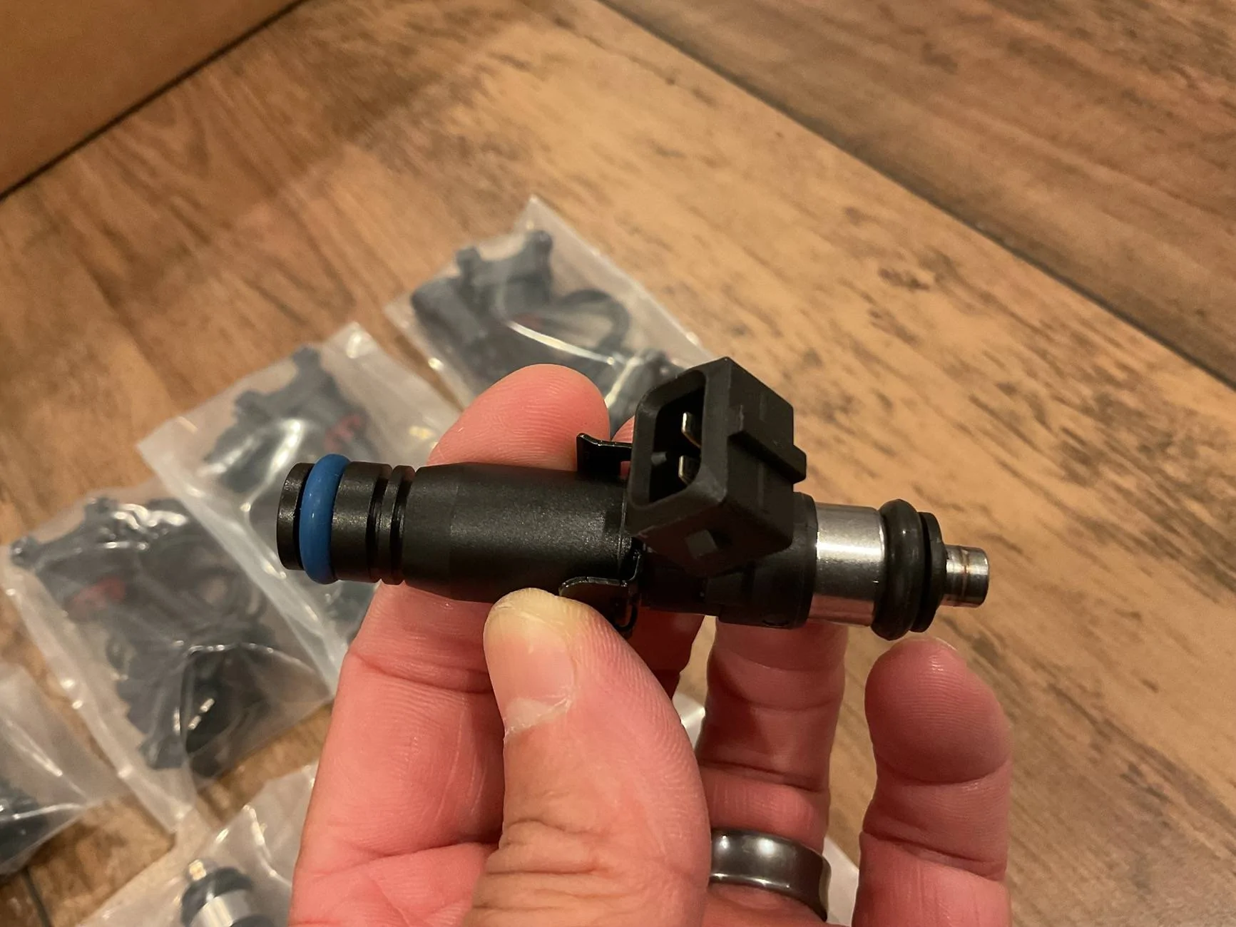

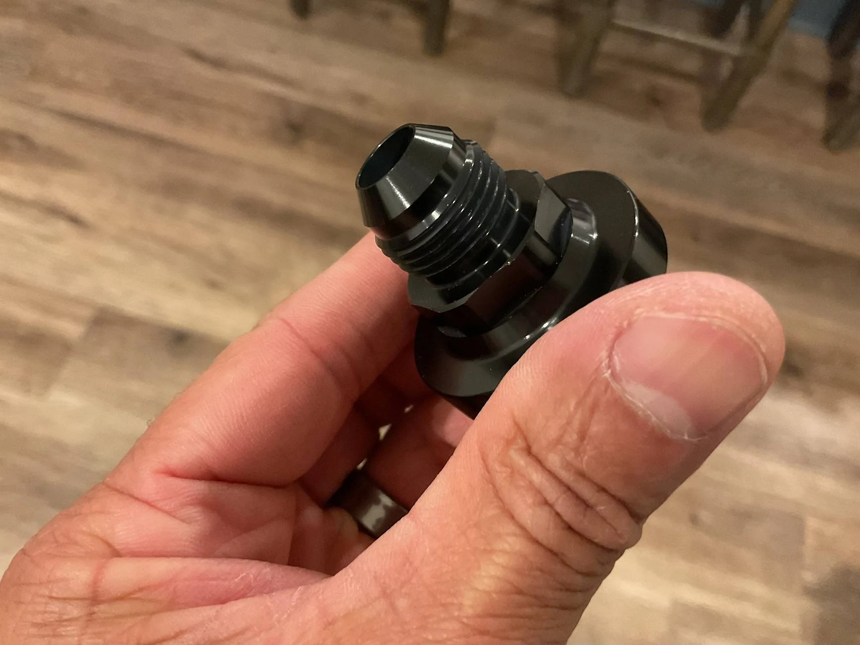

I received my Deatschwerks fuel rails with crossover line, 1500cc injectors and fuel pulsation damper today. I really like the quality of the rails, but don’t know for sure yet if they’ll pair nicely with my Holley Lo-Ram intake manifold.
I took photos of the supplied Holley rails too. My first impression is, the Deatschwerks rails are of a nicer looking, lighter and higher quality design with a matte finish, whereas the Holley Rails are gloss black, not as nice looking and heavier.
The fuel injectors appear to be of high quality as well and come with adapter harnesses. I hope I can get away with running the Deatschwerks rails over the Holley rails, but I’ll run whichever ones I have to.
