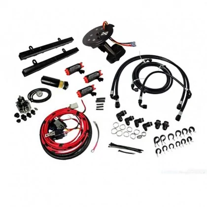

Deatschwerks makes a great product but that's far from everything you need to have a complete system. Wiring, Lines, Filter, Fittings, rails, regulator and assembly are all separate.
If you're looking at a complete that comes with everything you need you'll definitely want to take a look at the systems we offer. These are very popular and proven system in the mustang community. We take the guess work out of it for you to help make life easier. Let us know if you have any questions and we'll be glad to assist you.

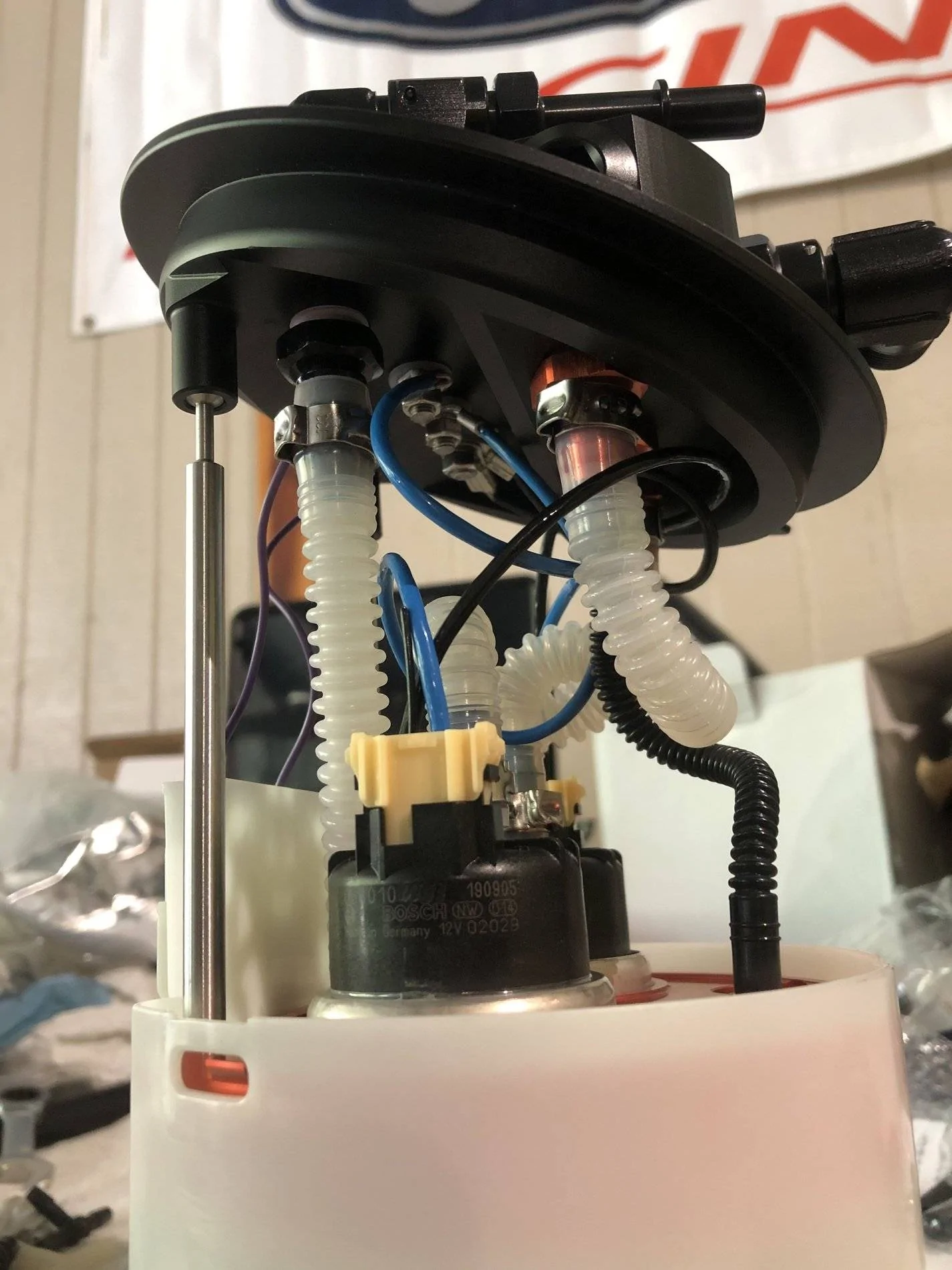

View attachment 487555 View attachment 487555
So I have spoken to DW a fair amount about this system and I absolutely think it will be the way I go. They sell the lines regulator and fittings as a separate part the only thing they do not have is a wiring setup however I was told it was being worked on. I do believe some companies sell dual pump wiring harnesses so I’m not too worried about that. I have seen too many people on this forum and other places with fuel systems that have supply issues with low fuel levels I really like the oem bucket and siphon feature are maintained.

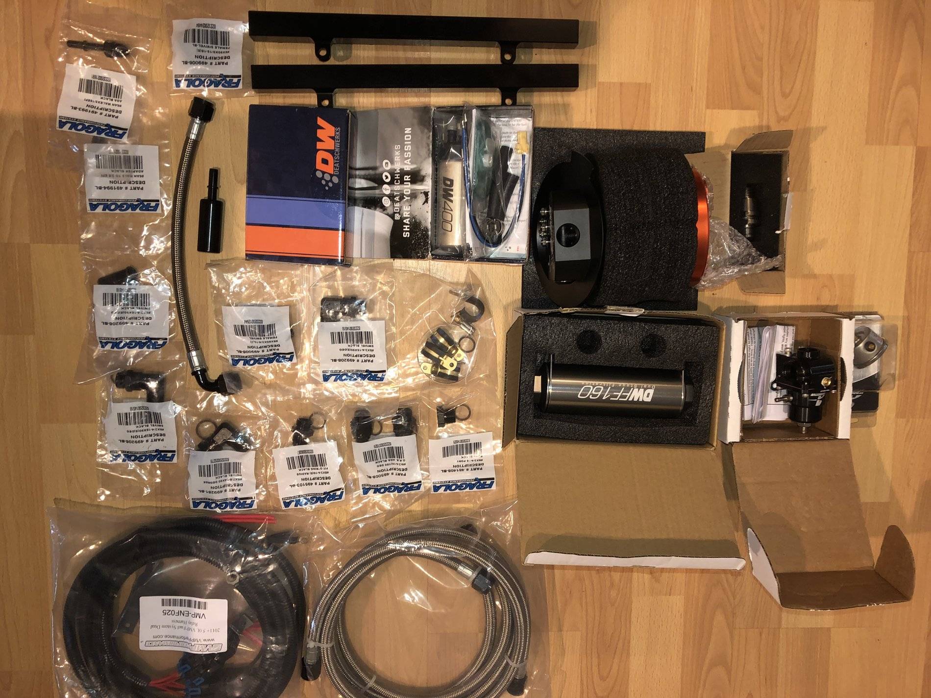

I just received my plug and play dual pump kit from VMP and they just switched to the DW X2 with 400’s. It’s a nice kit and went on smooth using the DW and VMP instructions/videos.

Just shy of 2k for everything, 2600 with 18 ported intake and harness.
Glad to see you finally got your kit. i know from previous posts you were going on 3 months wait time. Did you change it over to Dw or did vmp just replace their original kit with Dw?
