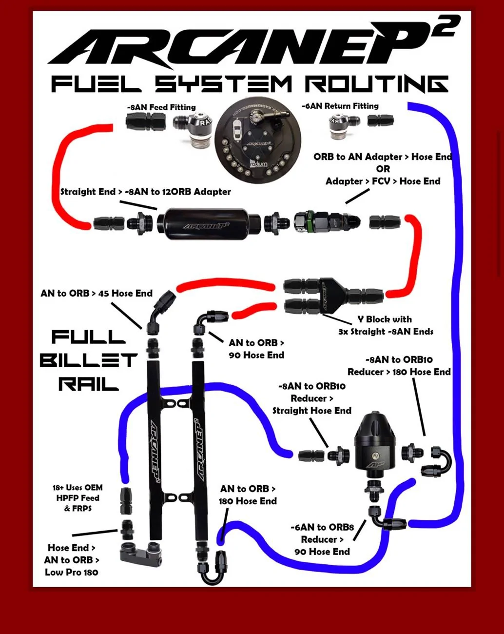

Yeah the arcane system uses that regulator, I added a check valve to mine and still get it nearly every start
Got any pics of how you’re plumbed up?
Damn. I was planning on adding a check valve to mine in hopes to get rid of the barking seal and make some of the cold starts a little smoother. Oh well, I've gotten used to the seal!

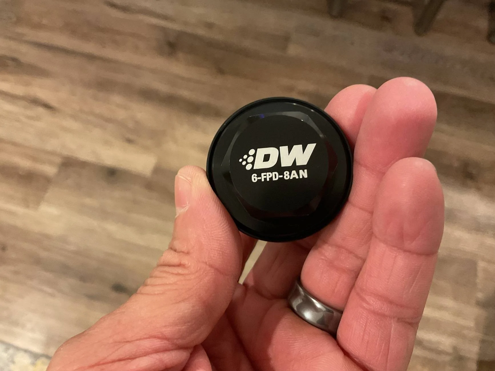

Here’s a short video clip of the seal barking hello on my car with that DW fuel pressure regulator. A bit high pitched and quieter this time. The bark does seem to change at times depending on what mood the seal is in. No comments on my crooked regulator mounting job please. :)

No, it may quiet down injector noise some. I believe the barking sound from the regulator is air being purged from the lines, though I never have figured out how air could get in without a leak other than maybe through the return line not being deep enough in the hat
Yeah mine is anywhere from a several second long noise almost like a hydraulic pump turning on, to a quick chirp
