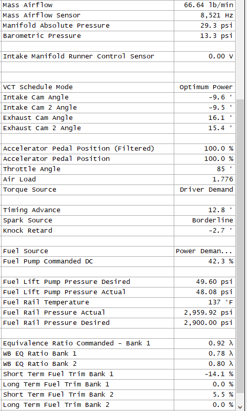

My initial data log looked good. Slow climb and engine revs were smooth. Lund then asked for a datalog at WOT. This is where the issues start. At WOT, you can feel the car fighting itself when trying to go WOT. Datalog shows that bank 1 is pulling fuel -15% and bank 2 is normal at around +3%. We checked everything on the install, everything looks correct.

Lambda is reading .78 at Bank 1 and .80 at Bank 2
