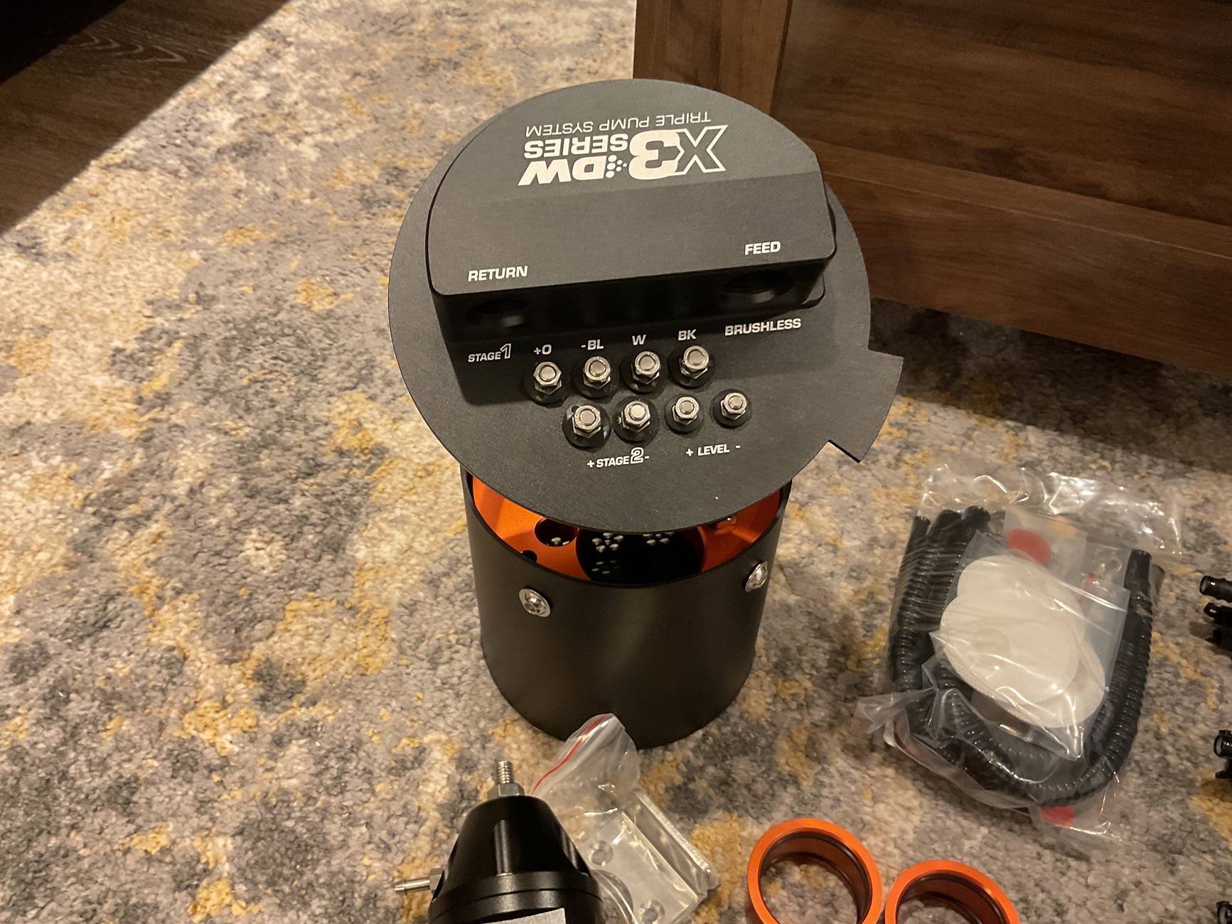

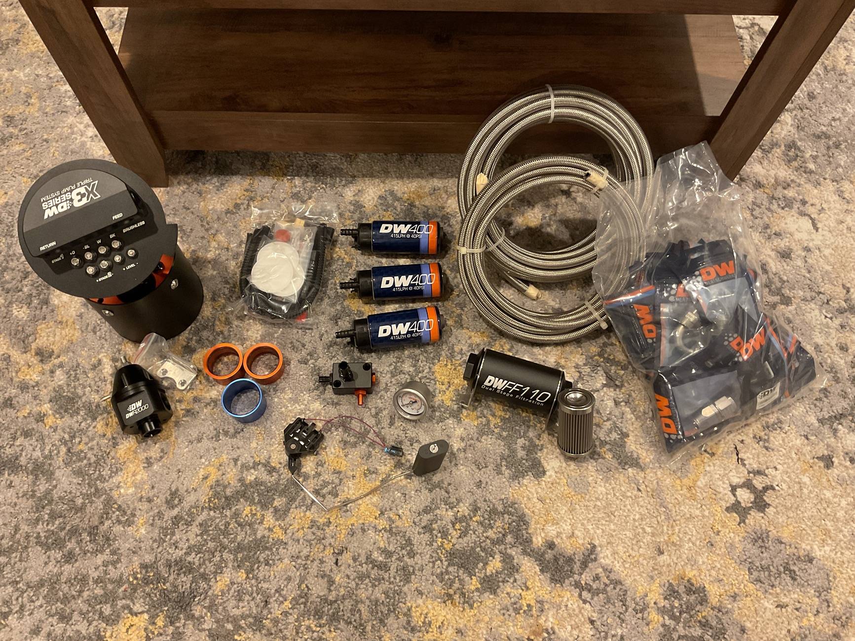

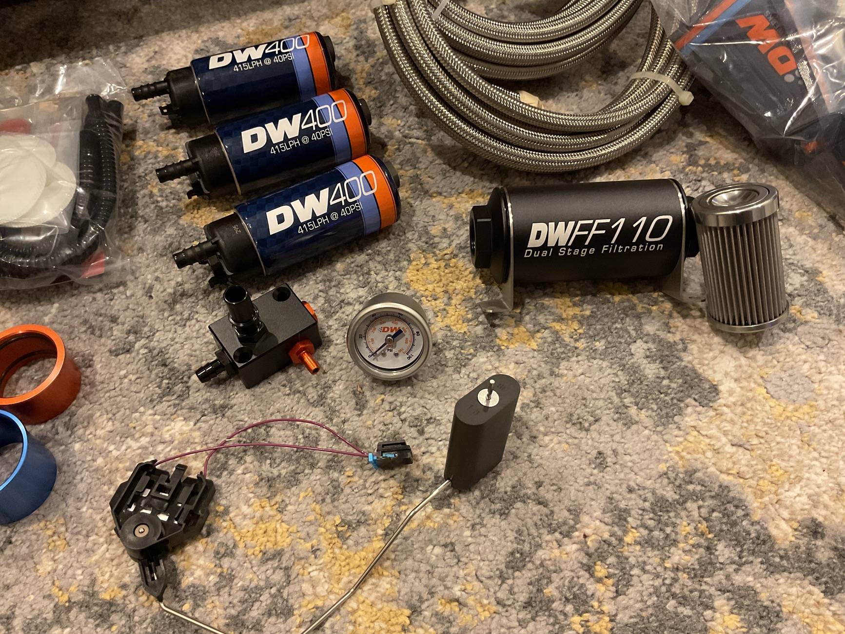

The X3 looks to be a very well thought out kit. It includes all of the necessary fittings, pressure regulator, gauge, filter, fuel level sensor etc.

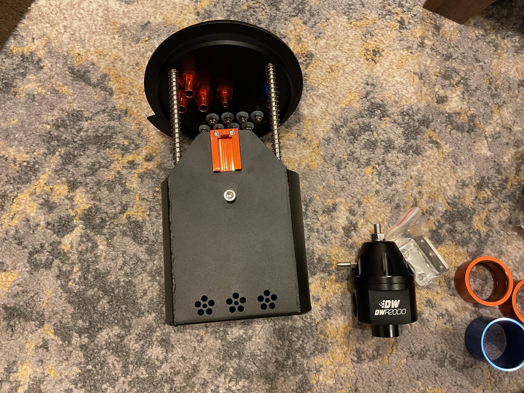

Those 3 fuel intakes do they have any plungers or trap doors on them or are they just open holes?
Yes they have one way plungers that are included in the hardware kit with the lines and clamps.

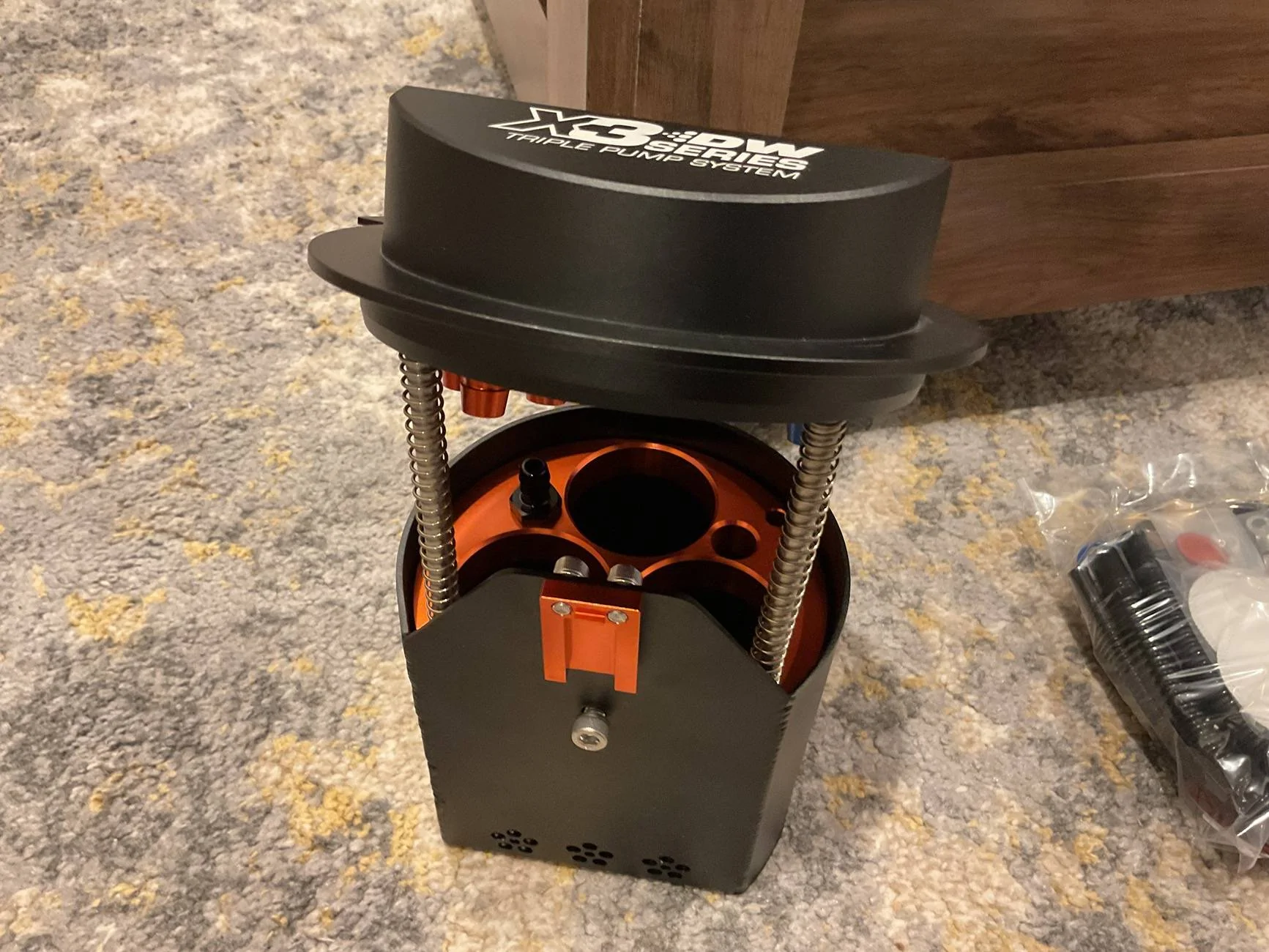

They’re supposed to have these rubber check valves in them.
That makes sense to have them. Still though with how short that bucket is and with 3 large body pumps in it I wouldn't feel comfortable going wot with too much less then half a tank. I actually think that metal bucket is going to hold in all the heat those 3 pumps produce where as an open setup would probably at least allow for cooler fuel. I think that bucket is just a selling point for them with no real benefit. The radium bucket for example is probably 2.5 times larger then that one.
