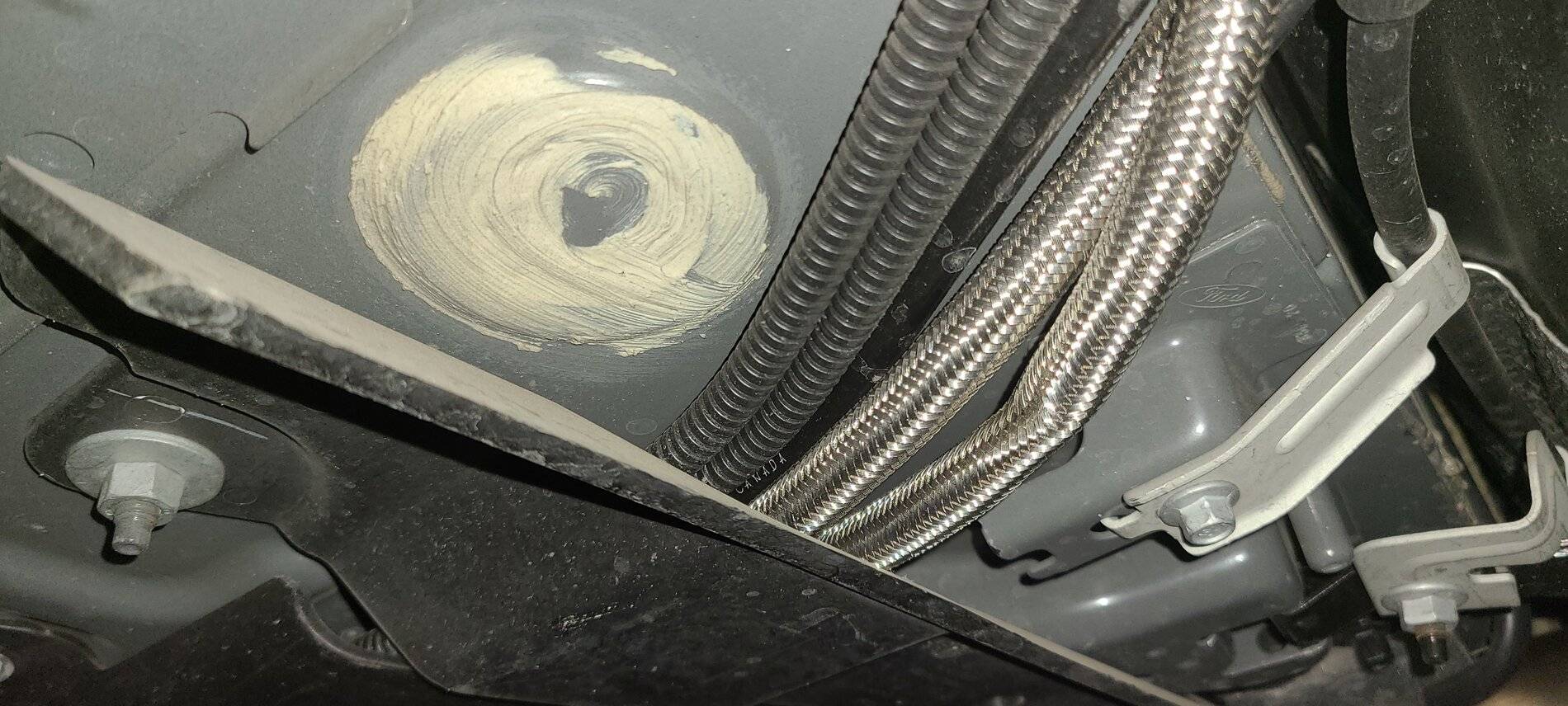

Found this kink in one of the fuel lines near the back of the car at the fuel pump. Seems like this could possibly be the problem?

The shop should replace that line if they’re responsible for damaging it. Fore should have part numbers for the individual fuel lines. Once it’s swapped out, retest to see if that fixed the problem. If you can see that kink in the line, the installer had to have seen it and knew that he did it too.
Ya I already sent them the picture and will have them replace it. The mechanic 100% should have noticed that and ignored it but I'm a little worried now because the shop owner said he went over every single thing on Friday himself and said it all looks good.
That irritates me every time I hear about a shop/mechanic trying to be nickel slick with a customer. Hell, if they F up, man up and fix it right. Don’t be trying to cover ish up and act like you don’t know what it could be SMDH. I hope they get you straightened out and quickly too. They should be paying for Fore to overnight the parts.
I’d pull the skid cover over the fuel lines to see if everything else looks good under there.
