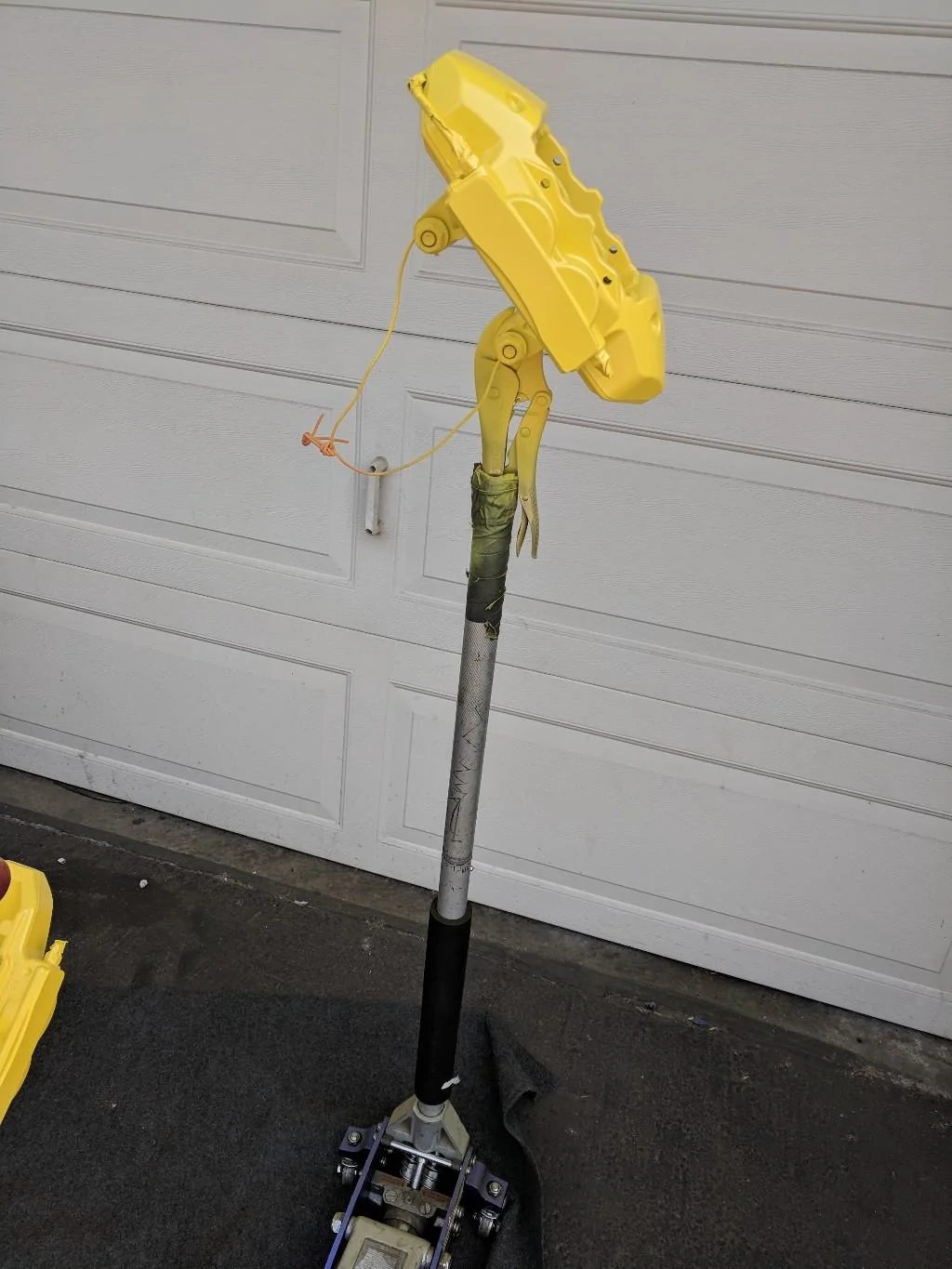

Myself. I have done it many times with excellent results.
Vht high temp primer
Vht yellow caliper paint
Important step is to bake them for 1hr at 200F in order for it to cure . After that it becomes rock hard and no need for clear coat at all.
I did my 2015 gt same way and after 3 years it looks like day one .

I tried that with my headlights and they almost ended up in the trash.
Now I put the calipers in a cardboard box and put a hole on the side of the box and insert my heat gun to cure the calipers.

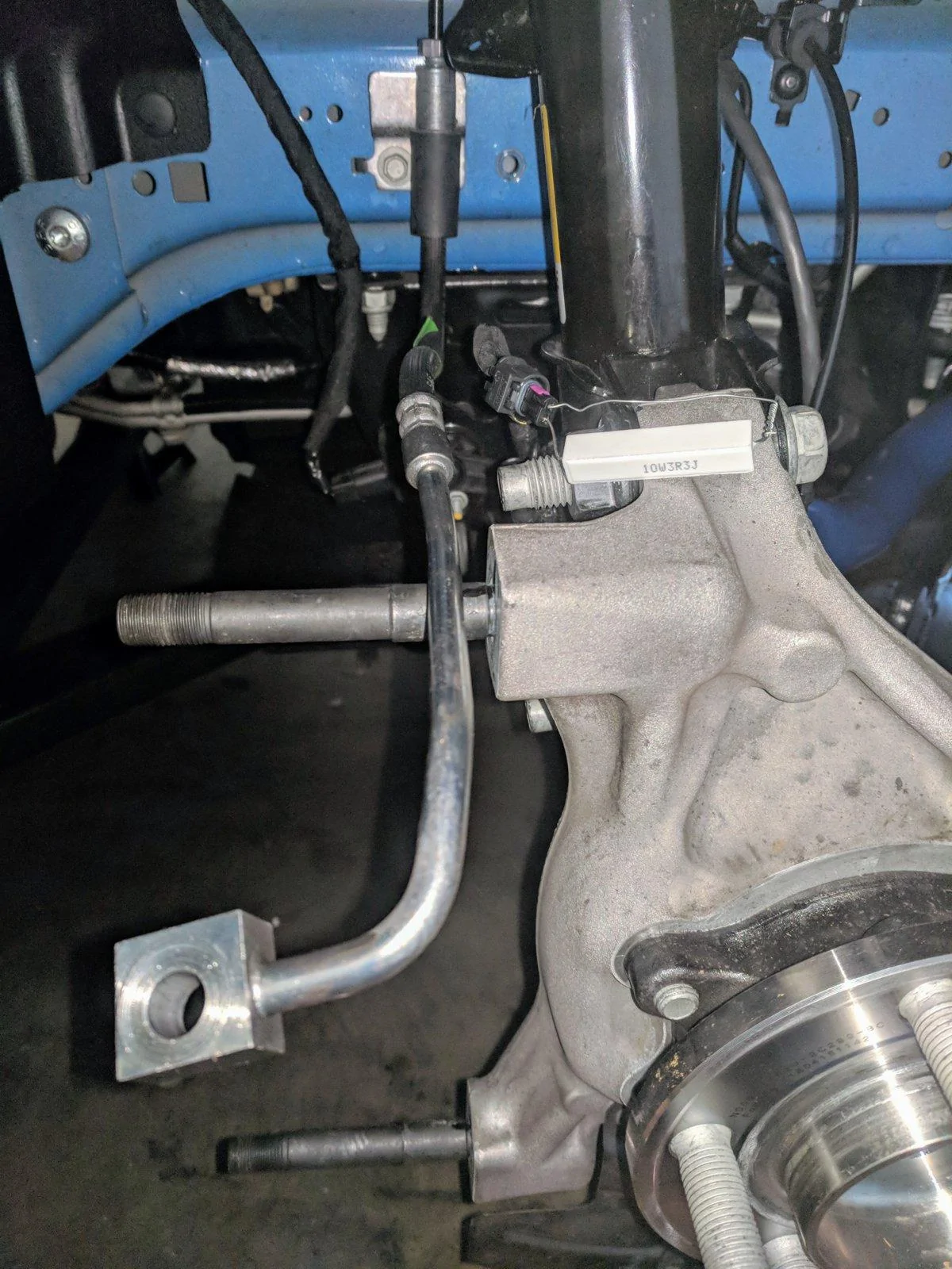

Also little off topic, got some 10w 3.3ohm resistors to fool the magnaride and it works. I switched the modes and all modes work without throwing a warning. This is for later on if I decided to go with the kw coilovers.

Where did you find the male plug connector that goes into the harness? And love the caliper studs!:)
That is the actual harness from the strut. I will have to look at numbers on the harness and see if I can find it online.
Caliper studs are awesome. 100x easier to take out the calipers.

But first...what is it? I don't remember unplugging anything when I had my calipers off.
You don't have to unplug the strut harness to remove the calipers. I am just doing a little test with the resistors to fool the system if I want to later on change out the struts with coilover setup.
So you popped the lead wires out of the connector, yes? I didn't think you'd cut them just for the connector to run a test.
No. I just unplugged the harness and insert the resistor ends into the harness.

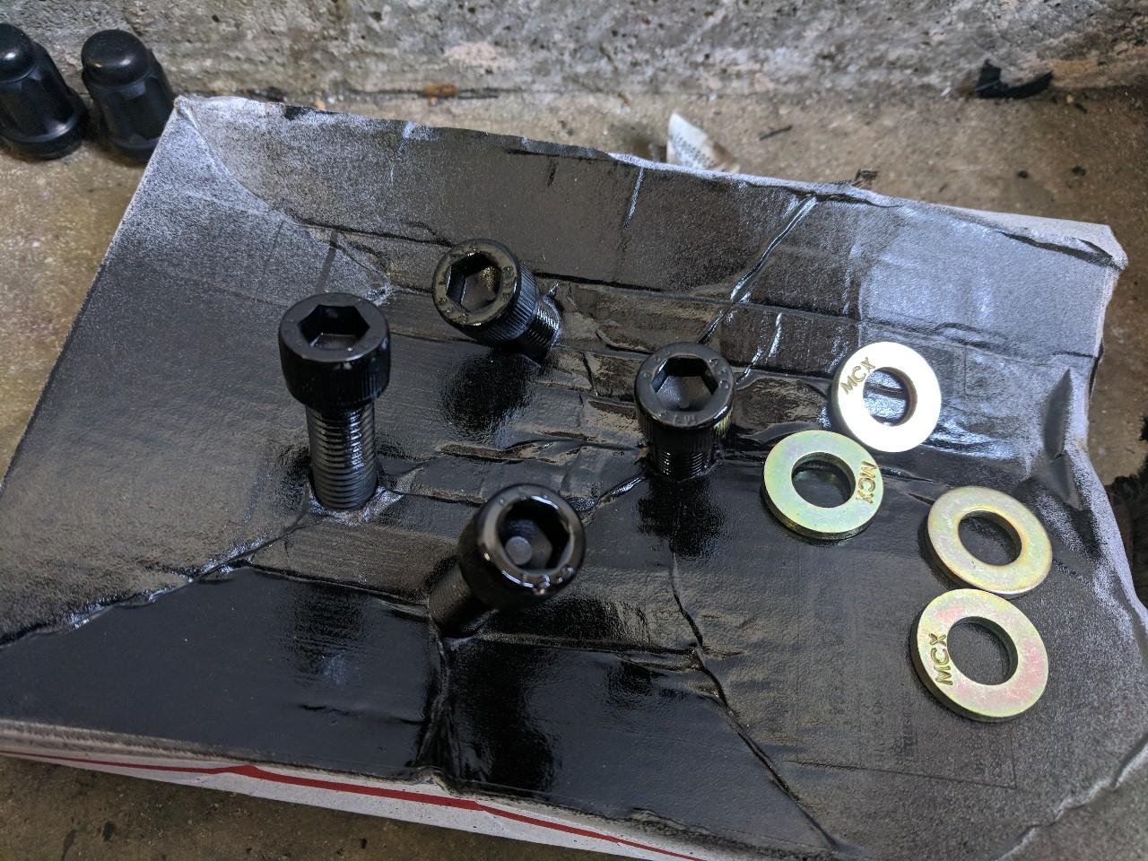

Did the rear calipers and came out excellent .
Also go some 12.9 bolts to replace the factory rear caliper bolts.
