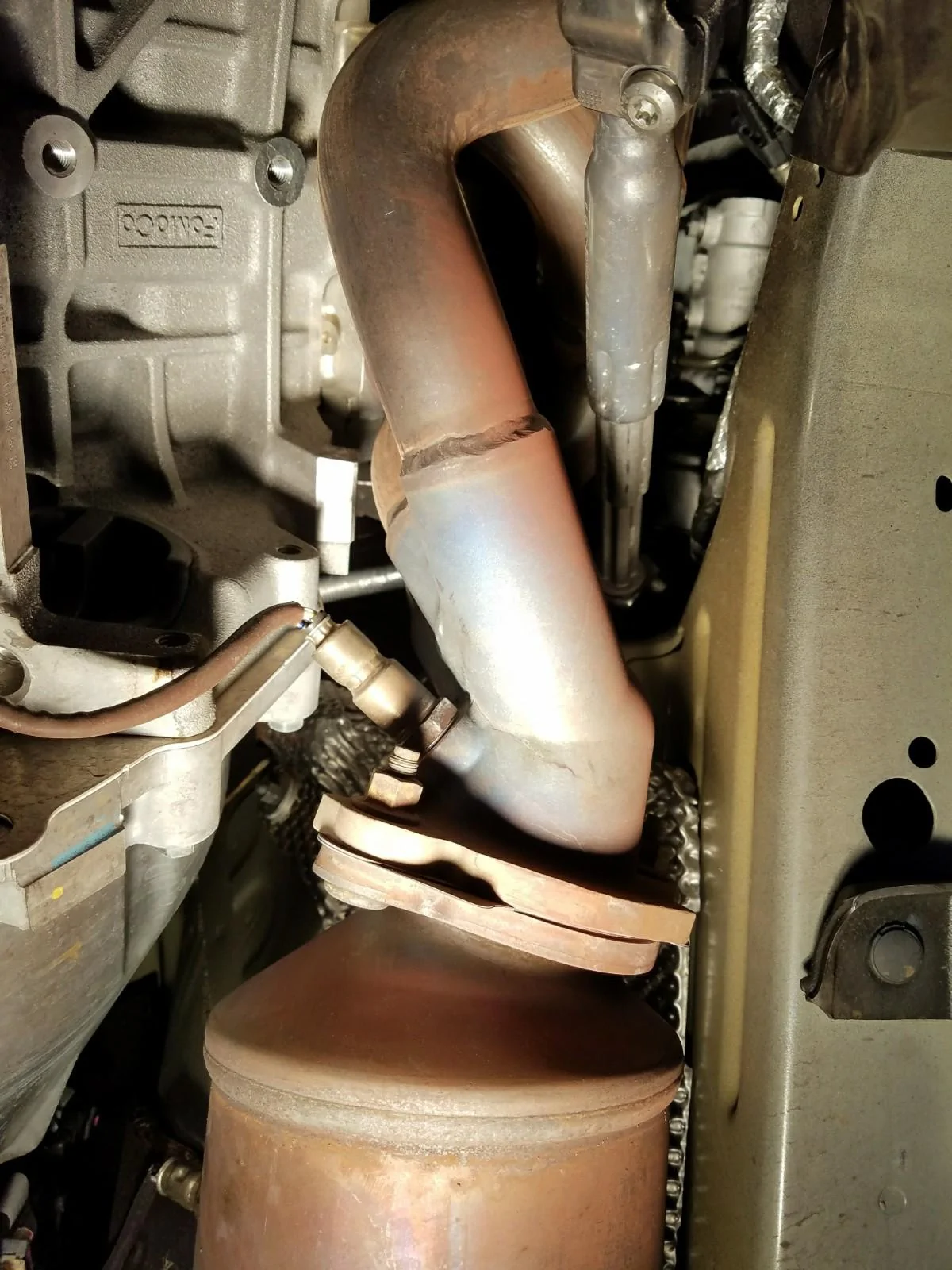

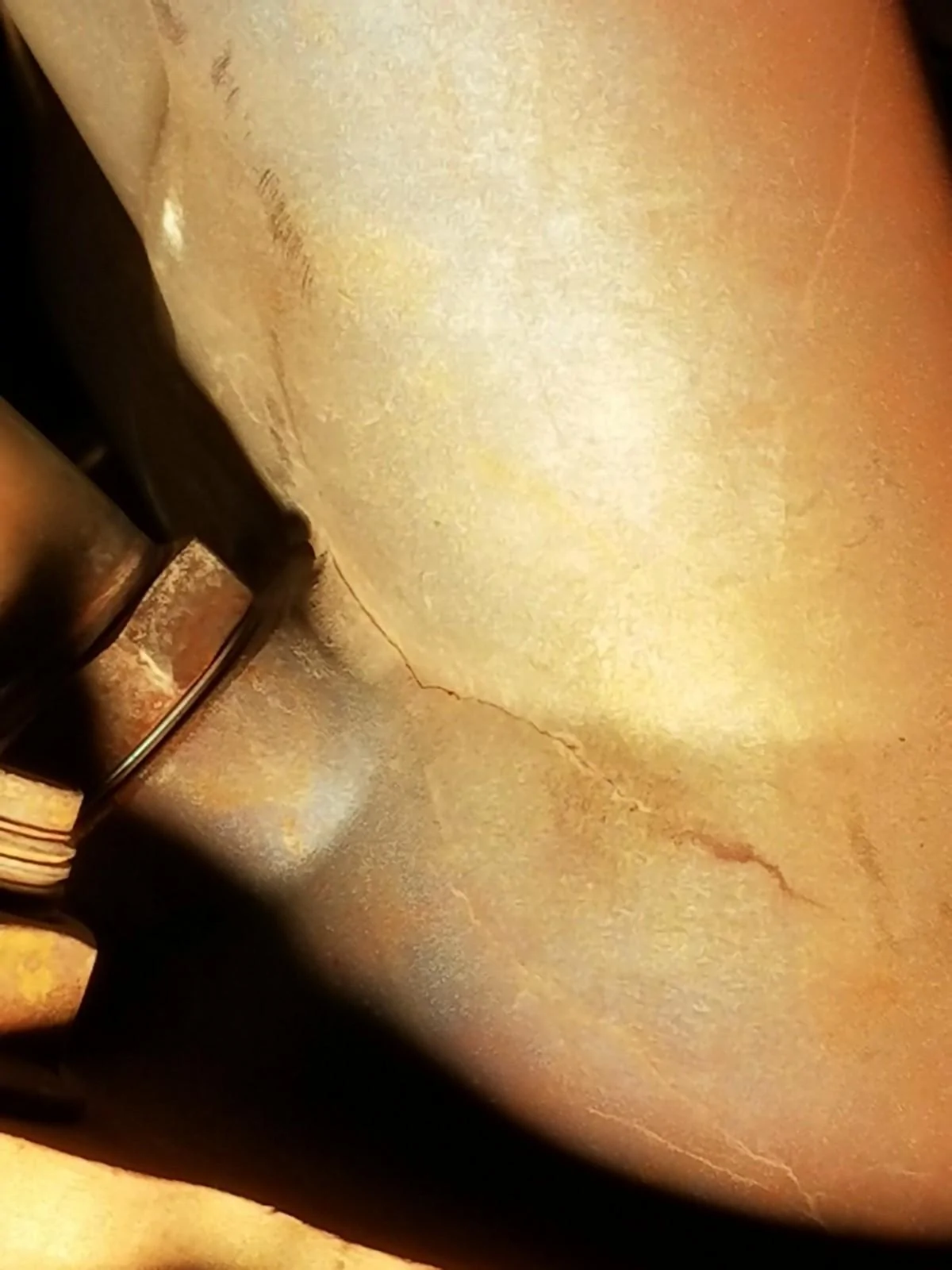

Have a small crack by the O2 sensor i found when I had the belly pan off. I already know my dealer won't warranty this out bc I have resonator delete pipes welded in. What would you all do with this? Is this section cast , can it be welded or not ?
Ty

That portion of the factory tubular exhaust manifolds is cast stainless. The part is defective and not related to the elimination of the resonators which is waaay downstream of anything emissions related.
Bring the car to the dealer as it absolutely should be covered. This is a rare failure and I'm certain Ford would like to take a closer look at how the failure occurred.

Would definitely take it do dealer as Epiphany mentioned and would have zero qualms doing so. Very hard to argue that the delete of essentially a sound item would have any impact on the headers, especially when the very same delete exists for the R version and has no causality relation to a crack in a cast piece (a defect).
In half-seriousness, would the dealer even notice the difference?

As a backup to the dealer replacing that piece, if it is cast stainless that should be easy to weld. There are aerospace weld materials that would definitely work great in that application.

Since the manifolds house an oxygen sensor and attach directly to a catalytic converter they can definitely be considered an emission related item. This should be classified and approved for replacement in short order.
I was at the Powertrain Reveal to a small group of hand picked journalists in the summer of 2015 at SVT's former headquarters in Allen Park. I spent some time with the ICE engineer responsible for these manifolds. I learned they are manufactured by Watson Engineering, the same company that fabricates the roll bars that so many have installed for track use. They are all TIG welded and by hand. I mentioned that it didn't make sense from an efficiency standpoit to have them made this way. Adam Christian pointed out to me that in this case, due to low production numbers, that it was cheaper this way than to pay millions for them to purchase, set up and maintain highly sophisticated robotic welding machines. I know he'd love to study this failure as this is one I don't think any of us have seen or heard of yet.
