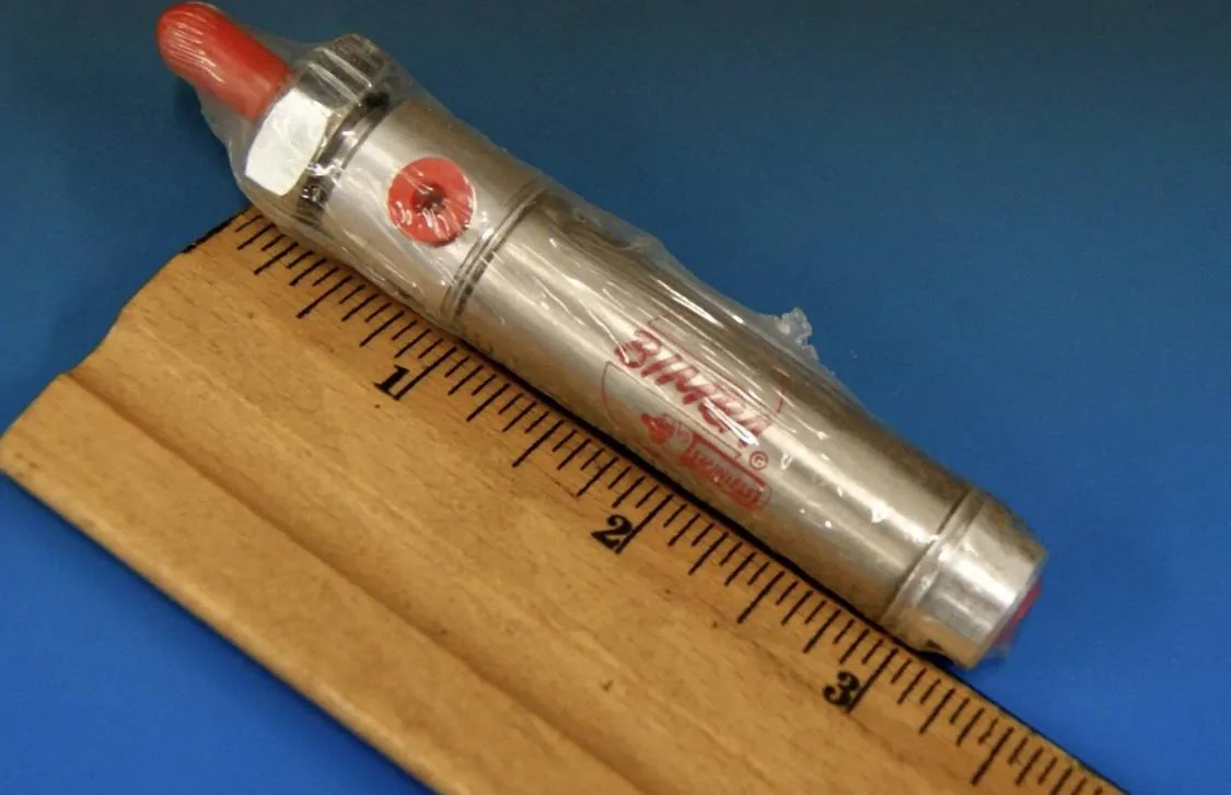

First Remove the battery box part of the firewall. Then I have A small air cylinder About 3”-4” that I put back behind the head between the firewall. 150psi air and it punches the freeze plug into the cylinder head kinda like a air hammer. then grab it with 45* or 90* needle nose pliers and pull it out. New one bolts in so it’s easy. Shop is in Northern California, Ukiah

You can tie into the heater hose and allow the coolant to circulate which is my preference. If you go one head to the other then you are just getting a better true temp to the sensor. Cylinder looks just like this, I think it was $40. Once you knock it in there’s nowhere for it to go so easy to get. The MMR cooling mod fits in very easy. I could not find my thermo gun so I ordered a new one so I can test the cooling mod. I’ll post video

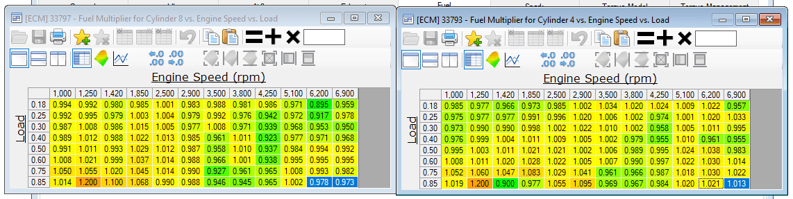

i do wonder if #8 is a product of emissions and then us pushing things beyond what was designed. in stock form #8 is trimmed to run leaner than the rest near redline, about 5% less than #4. only tune from Ford ive seen this imbalance zeroed out on is the voodoo and cobrajet and some early roush/whipple blowers (not ford tune)
