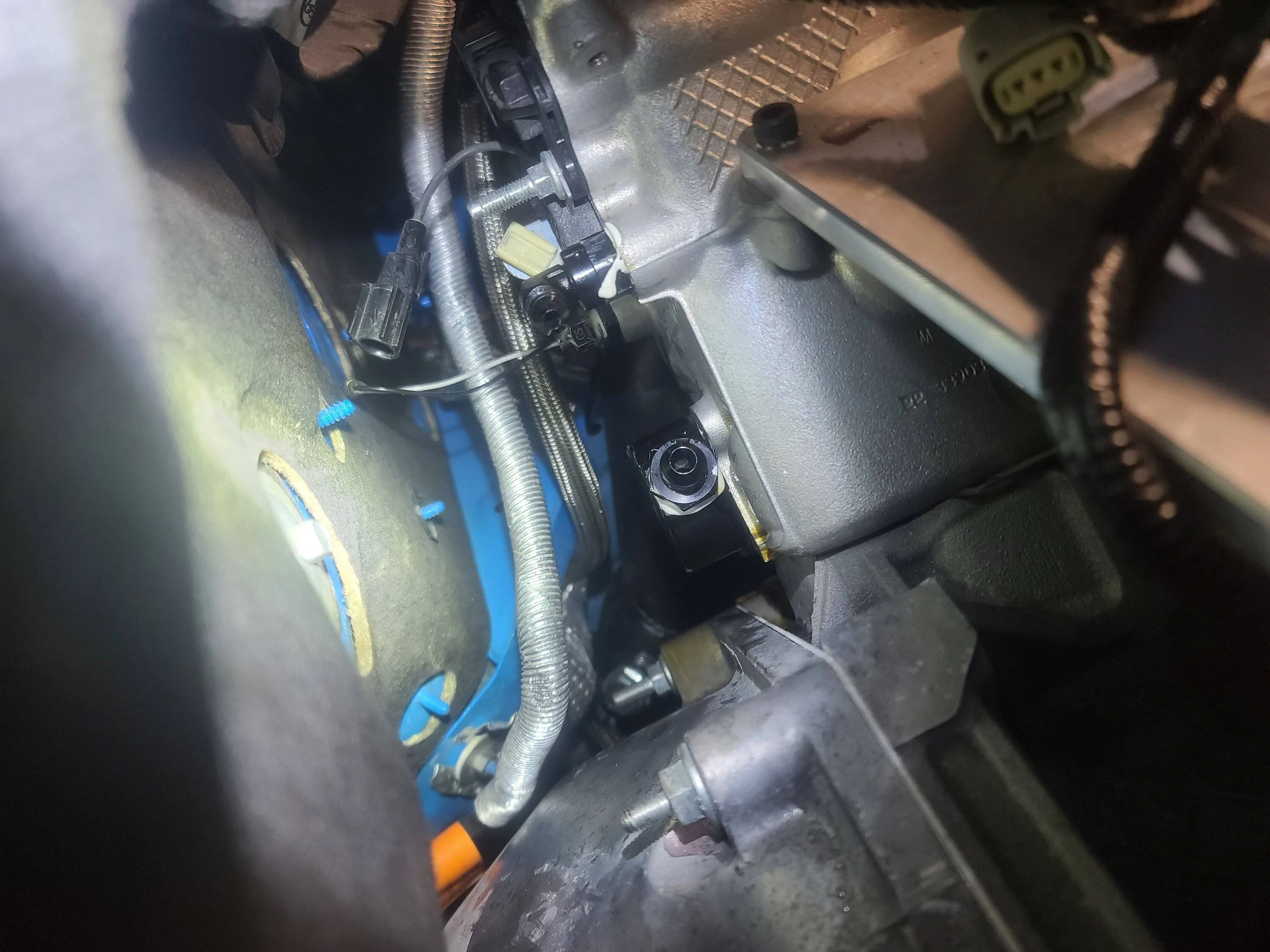

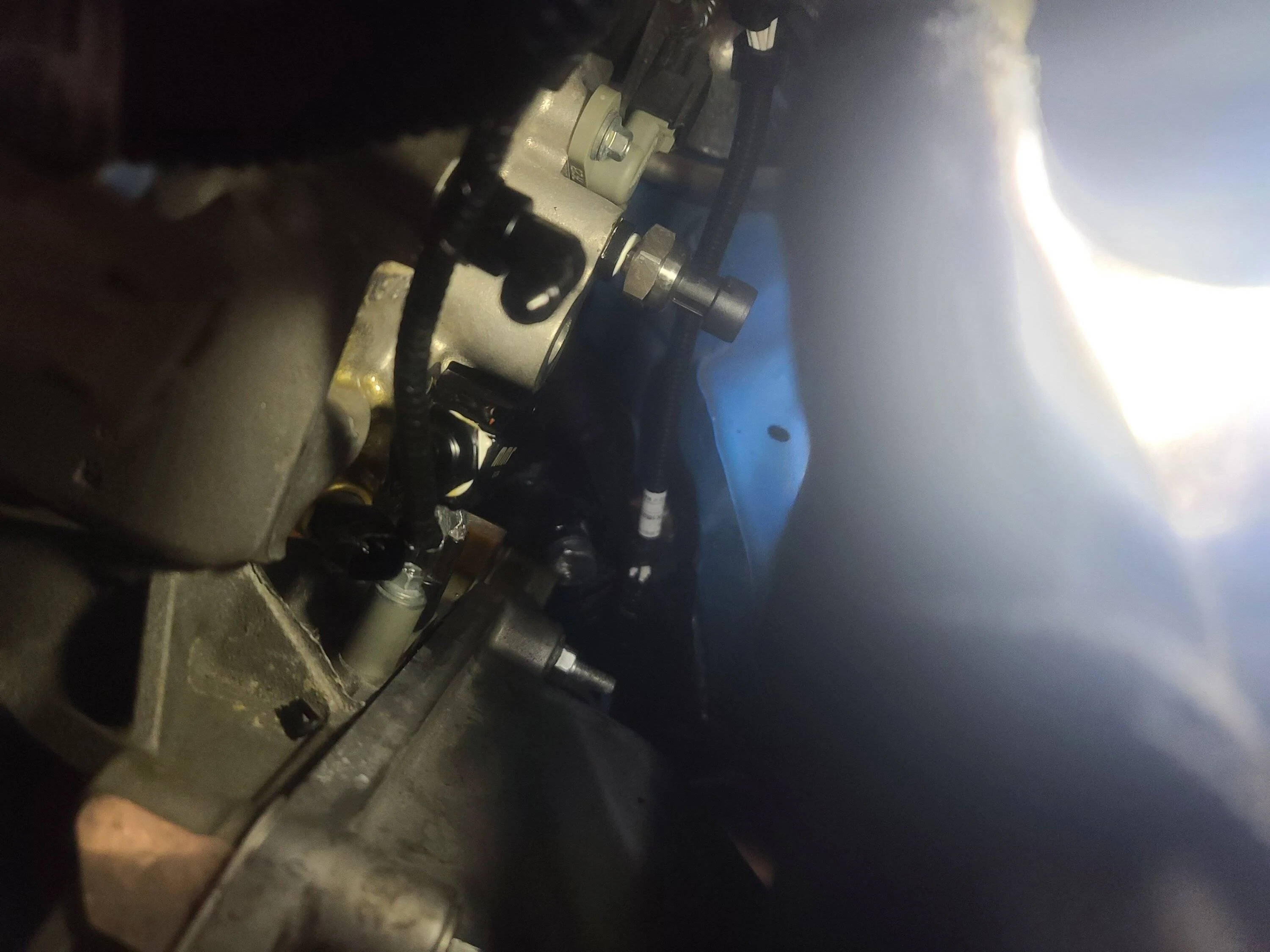

here how I did mine I used mmr cooling mod and single oil balance line and put an oil pressure sensor on one head and an oil temp sensor on the other head you can see where the crank sensor plug is right under the coolant fitting

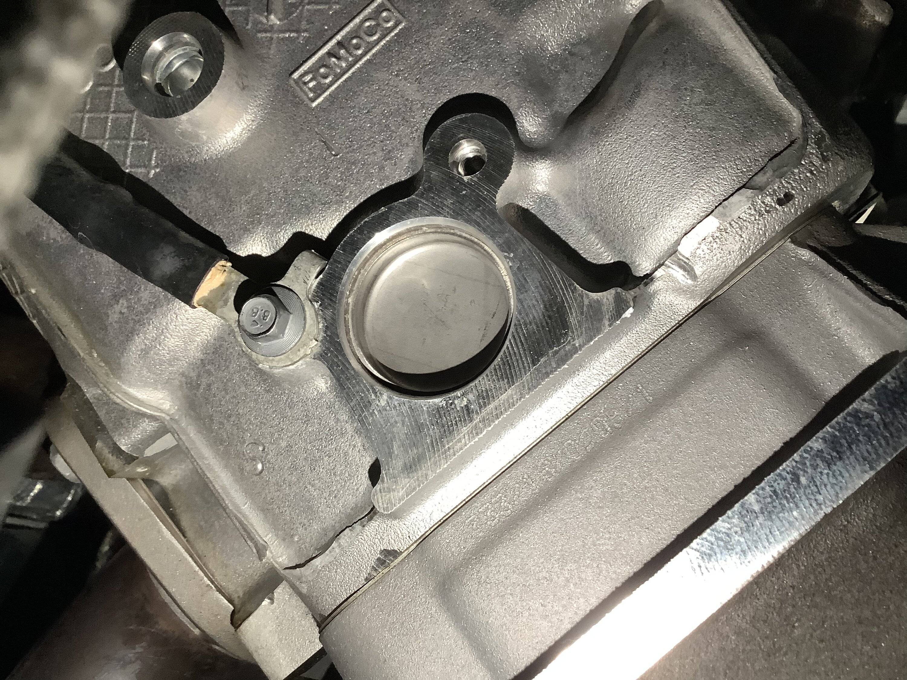

Kit has been ordered. I didn’t realize that while the different year Coyote heads all have the freeze plugs in the same vicinity, there are some differences In that pre 2018 has threaded holes to,secure the MMR Cooling Mod stand-offs, but my 2019 Bullitt has no threaded hole on the passenger side. MMR does have specific part numbers for the different year vehicles, but I‘m wondering how the passenger side will be secured without the threaded hole? In addition to that, where is everyone relocating the ground strap to on the driver’s side head?
